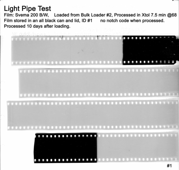

Can you show the negatives? Aerial recon films are coated on, basically, optic fibre. If they are subjected to very bright light, it may sometimes fog the entire roll. Was the fog uniform, similar to aging fog?
svema_official on Instagram
Leonid, the films were of course discarded, what would be the point in keeping them?
The first 5 or 6 frames had lighter areas clearly coming from the sprockets, on the upper side only. The rest of the film was darker in some areas, in some a bit lighter, but entirely fogged.
Aging fog? Yes, it did looked like that. The dark grey and light grey were alternating, but not clearly defined areas. More of a long dark grey 4 or 5 frames, then became a tad lighter slowly, then again dark. Not a single frame to be seen, not even when a length of the film was scanned to see if anything was impressed upon it.
Diagnosing the issue and requesting replacement if it's manufacturer's fault, of course.
Aging fog wouldn't be irregular, it is usually uniform with (kinda) exceptions like edge fog, but it is more ir less uniform too
What you're describing is caused either by loose lid or light piping, but since you say that the first frames are fogged just from the top(assuming that in your camera the canister's lid is at the bottom), I think the loose lid is the more likely option. Inspect other cassettes for anything suspicious
What is the aerial film, 400
And old 200 with green antihalation layer. I'm not so sure about others, since they are thicker

Also, in regards to fogging, aerial films are well known for their tendency to light pipe. FPP sells this film in standard lab cassettes they load themselves, and if you don’t handle the film right, it fogs. Even just bulk loading it in a bright room can cause some fogging. @Minox i believe your problem may be described perfectly in this article, take a look:

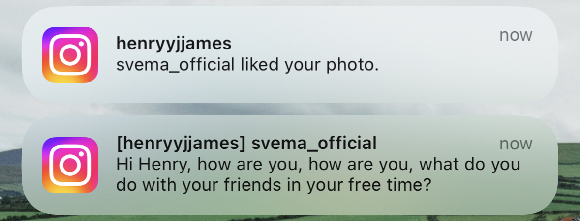

I just received this message from the Svema Instagram account that myself and some others have placed orders through. IDK what you all will think but personally I find this message a bit unsettling... They also started liking all of my posts... Prior to this message, all our communications were professional. What do yous think?
Oh ffs, not again. I don't have any other explanation other than that this guy sometimes gets wasted and starts to post on this page. Usually it's just more or less harmless posts that get deleted in the morning, that mostly boiled down to how hard it was to preserve what's left of Svema(with a lot of grammatical errors). And he isn't even an Astrum's employee, just a son of one of the co-founders/managers.
I'll write to Dmitry about this, if you want, he was really helpful with an issue I had when trying to buy magnetic tape through this guy's dad ("tibosha" email)
henryyjjames
Apr 12, 2022
209
Dublin, Ireland & CT, USA
Ahh ok. That makes some sense I guess.
