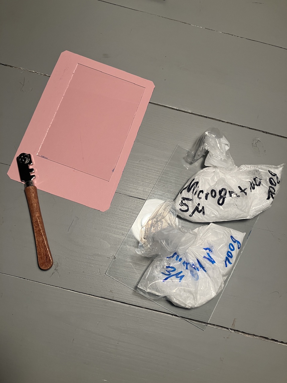

I need some grit for grinding a 13x18cm ground glass.
I have never done this before and I read in this article that aluminium oxide is prefered instead of silicon carbide.
Anyone on this forum how knows were I can buy aluminium oxide in size 5 and 3 microns?

In this case I went for the aluminium oxide route. I got an offer from Stathis Firstlight yesterdayšŸ‘

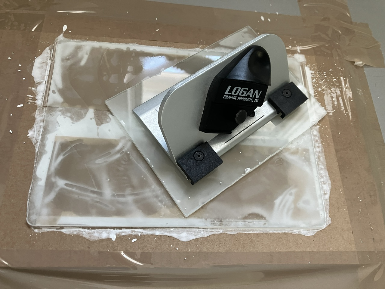

Let the grinding beginšŸ™‚
A cheap suction cup helps in moving the glass around...
Finished ground glassšŸ™‚

That looks really good! How did you manage to use that Logan matte cutter for this purpose? I've got the same (or very similar) one; it's not a suction cup; did you just 'stick' it onto the glass with moisture? Or double-sided tape? It does make a great handle!
I think either thin Scotch type double stick or thin adhesive glue would be perfect.
Those Logan matt cutters are very smooth and polished bottom surfaces and slide on matt papers, etc easily.
Yes, double sided Scotch tape. Easy to remove from the anodized aluminum matte cutter but strong enough to hold the grip on to the glass plate.

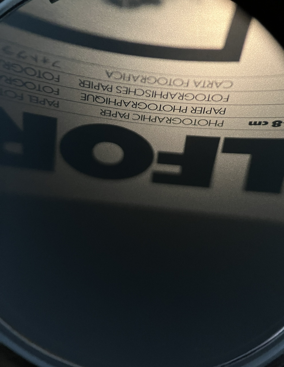

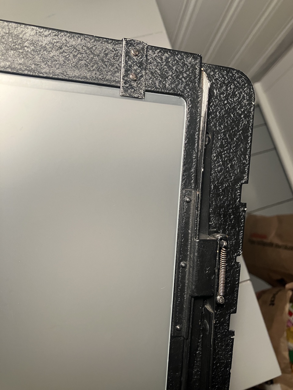

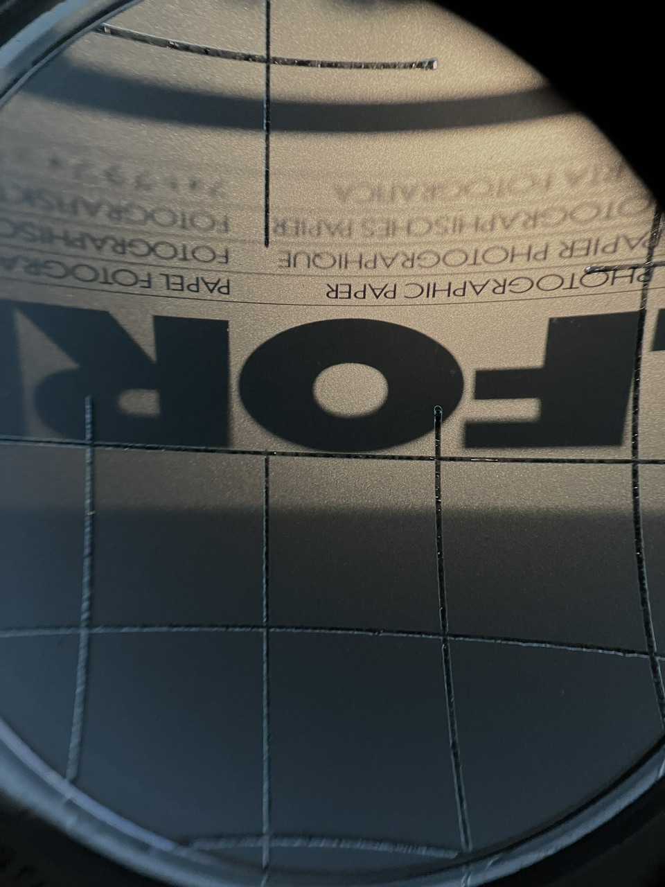

I replaced the original ground glass on my Intrepid 5x7 with a DIY ground glass grinded with 5 and 3um aluminium oxide and here is a comparison. I also did some measurement with my Sekonic L-308X of brightness between these two with artificial lighting condition but could not measure any difference.
The DIY ground glass makes it easier to focus on fine details, very useful when I do portraits with short DOF.
(Iphone SE with Pentax 4x loupe. Intrepid ground glass with grid screen)

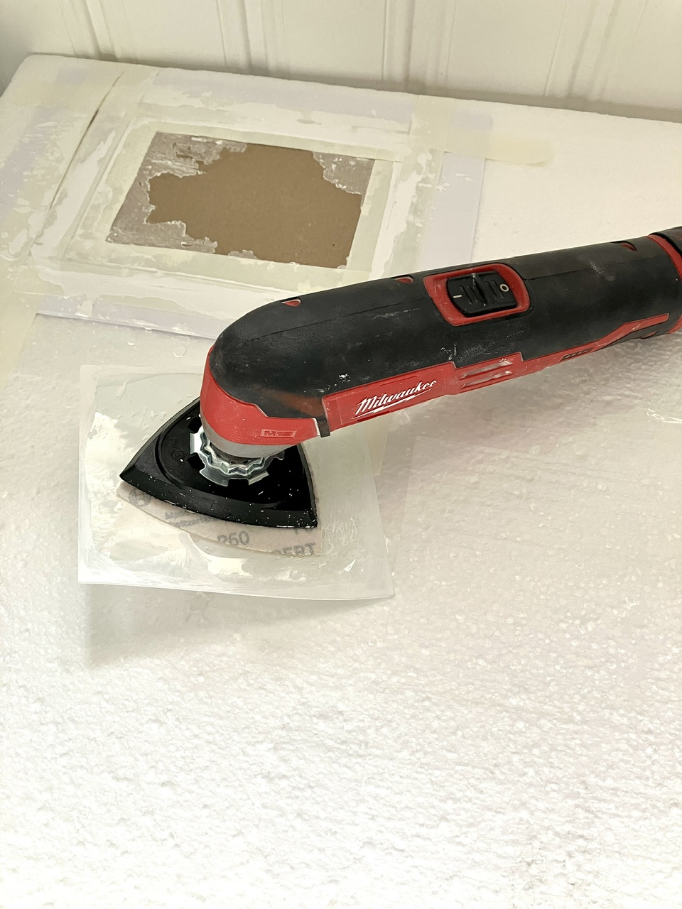

… and no more grinding by hand😃 Safety first if you do something like that thought!
