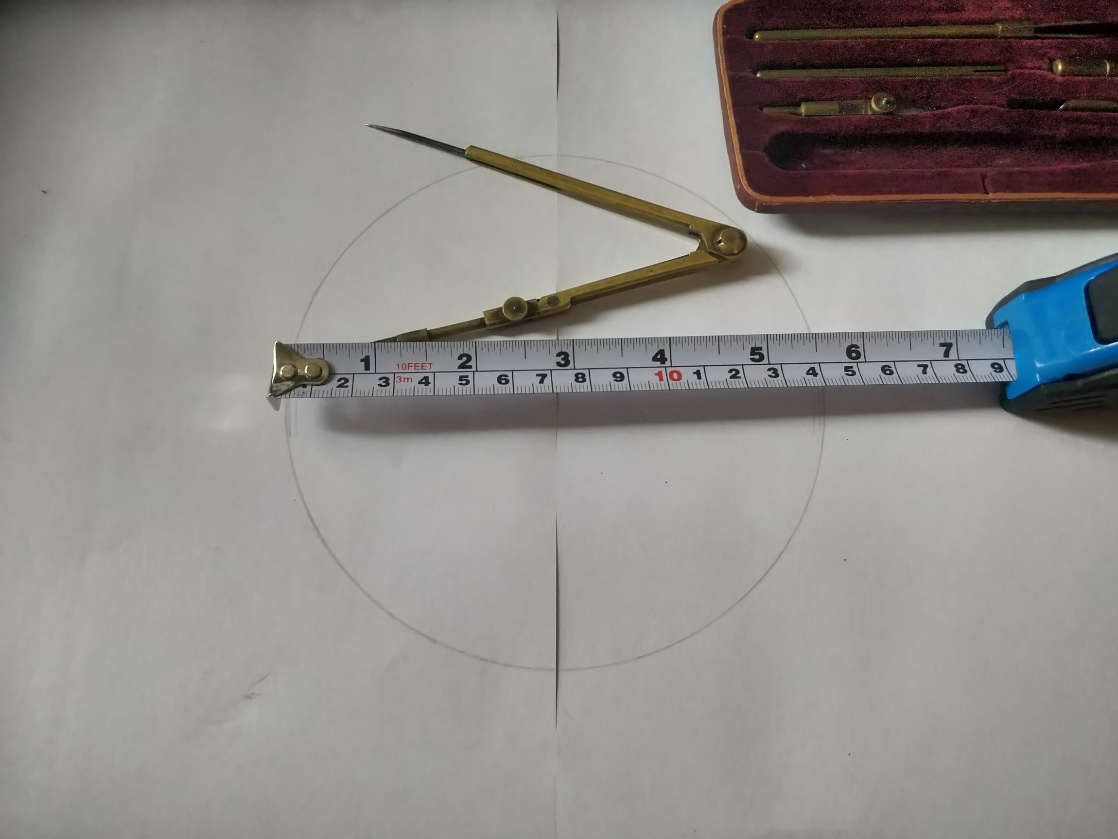

Hi.
I thought it would be good time to make a big shutter, so that big large format lenses could be used outside.
I drawed some plans but its still a work in progress, lol.
It should be a leaf shutter, with spring steel leafs. Inner diameter of the opening should be 14cm. Electronically controlled. Also it would be nice to get short enough shutter time for portraits. So 1/30s or shorter. And flash sync should be easy to do with a switch.
Ive seen that many shutters use 5 leafs, but some early ones use only 2 specially shaped leafs. Maybe i can just learn for some shutter how blades are shaped, and scale it up.
For moving the shutter leafs, maybe have rotating ring around the shutter barrel, that has attachment points for the leafs, and leafs also have attachment to shutter frame, so that rotating the ring, would make the leafs pivot and work.
You are welcome to see if this works out, also can share ideas and opinions and comments of course.

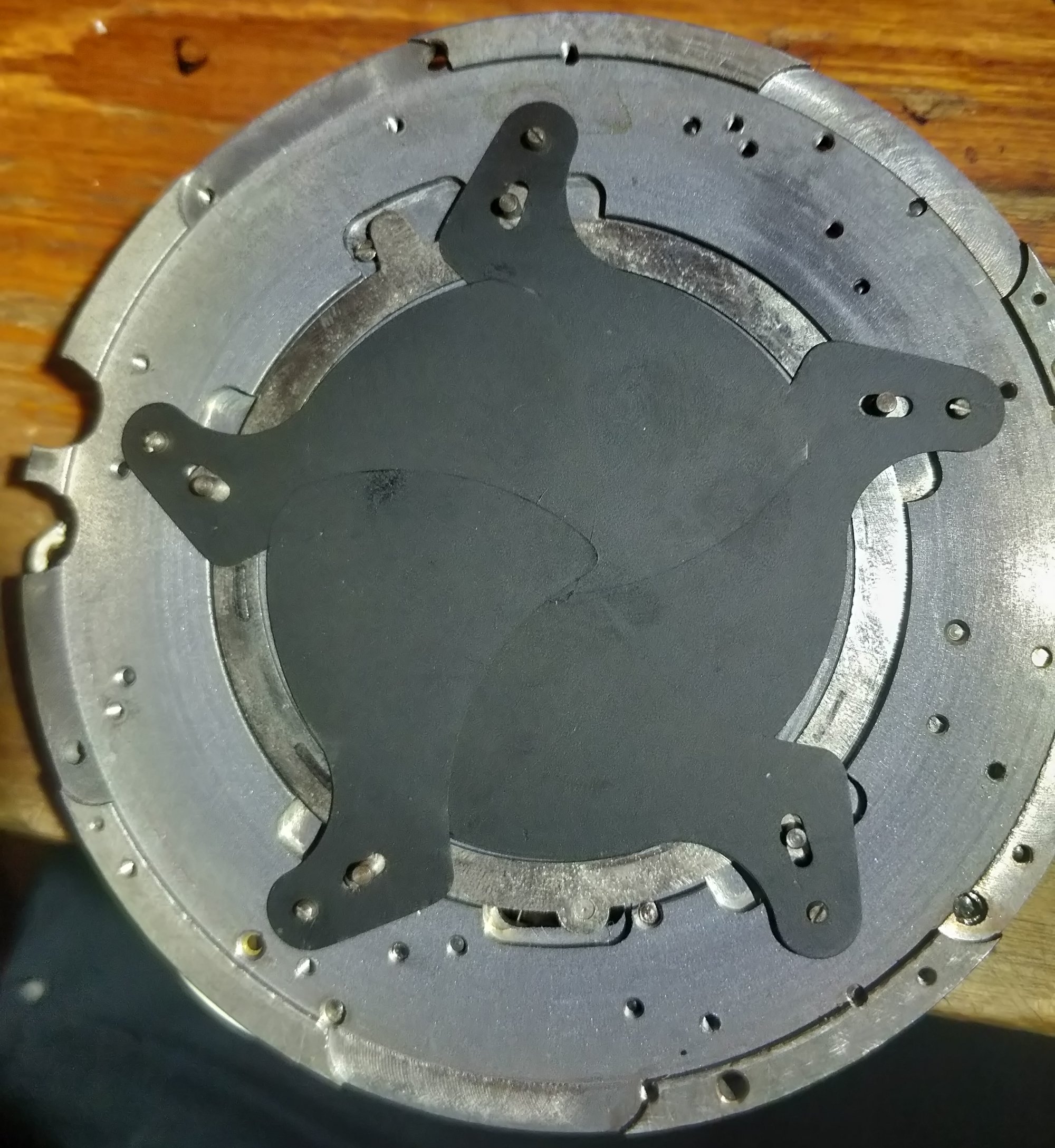

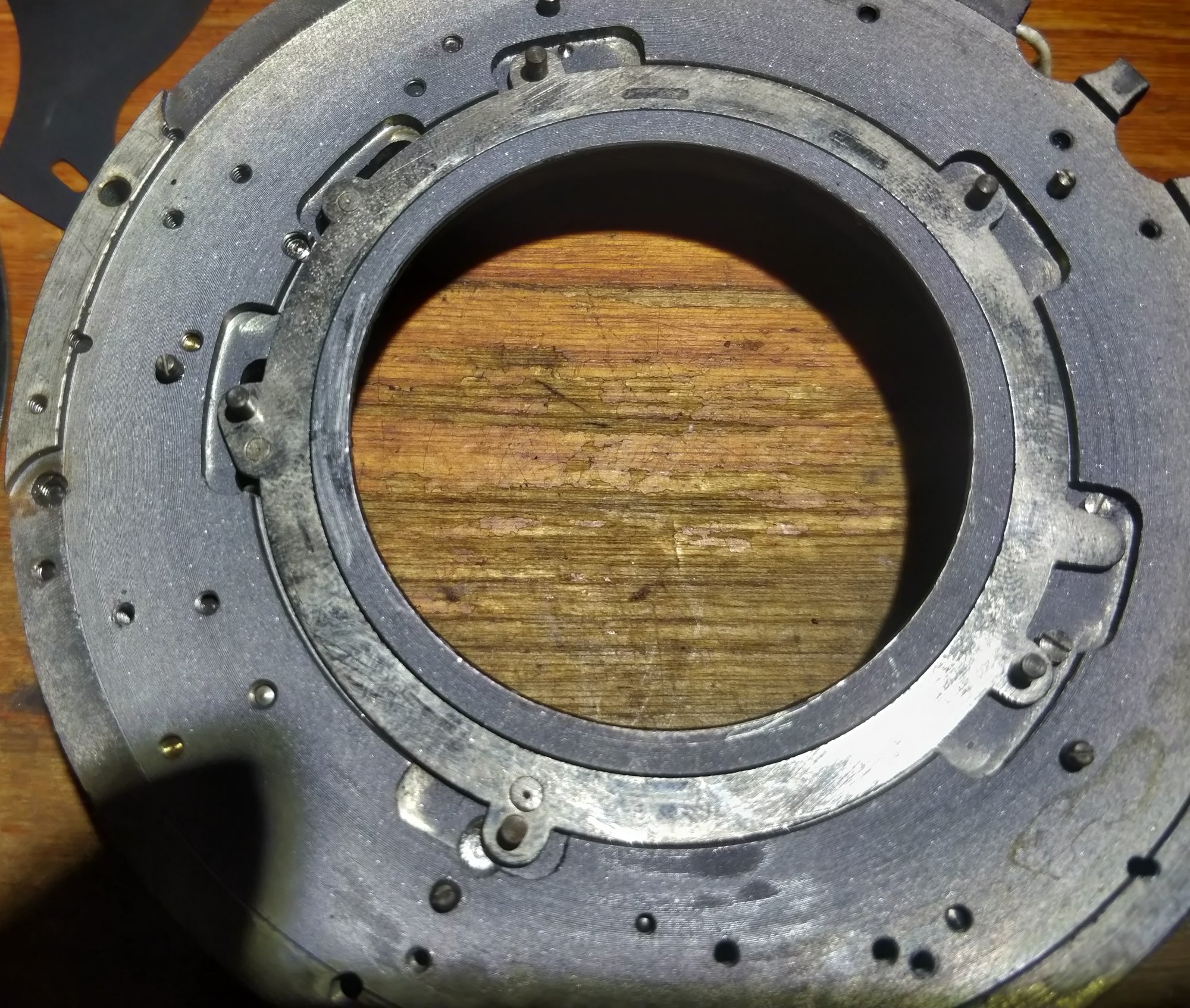

Okay so I will do similar design that shanel 5 (50.8mm opening) shutter has. It actually is very basic and just like i described in the start post. Pictures are from that shutter.
Similar geometry but just larger. Shutter leafs are 0.1mm steel and the hole and slot doesnt have any support. I mean that the pivoting "bearing" surface is also only 0.1mm thick.
Maybe I have to rivet some alumium piece to the small end of the leafs to make it stronger, so that the leafs dont start to cut into drive pin and support pin within use.
Id like to make cast alumium frame for the shutter, with about 15cm diameter threads on each end for attachment. Over all diameter of the shutter will be huge, 30cm, or so. Good thing that my camera can fit it no problem.
Thanks for suggesting guillotine and roll shutters, but really i found those a bit problematic and not nessesarily easier to do right. If i get this working, it will be easy to work with, having flash sync at all speeds and relatively compact size.
Oh and I took my fully working shanel 5 shutter apart for the exploration, hope it goes back together nicely, lol.
