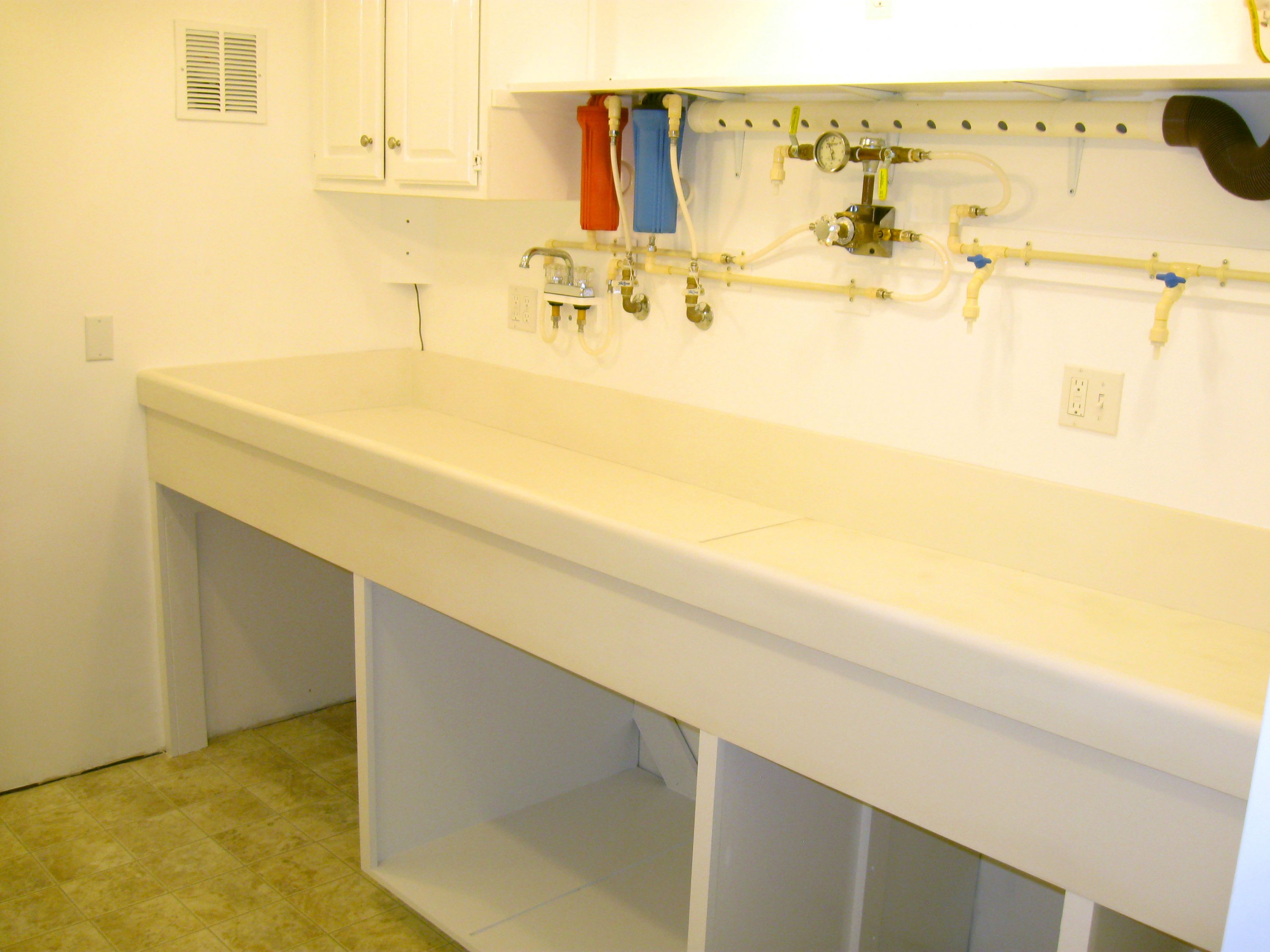

My current darkroom sink I built five years ago. It started as a simple 1x12 box with a 2x2 frame inside to hold the sink bed. The frame was designed to provide drainage to the middle, but one could slope it to a back corner as well. The bed is half-inch marine plywood. The corners between bed and wall were fared with marine epoxy. The whole thing was primed and painted with marine paint. I'm more than happy with it.
Here's a picture of it during installation (minus faring, drain and final topcoats of paint):
It sits on 2x4s lagged to the wall studs and on the supports used to make under-sink storage.
I've got plans somewhere still in pdf form. Just PM me if you're interested; I'd be happy to share them.

I do have hand-drawn plans (on gridded paper from OMV in Austria :smile: ) for my sink still. Mostly legible if you study them a bit. I made a couple of small modifications when building the sink that aren't in the plans, but they are pretty inconsequential; the basic concept was the same. PM me with your email address if you still want them.
As for Schluter membrane (I think it's a "t," not a "d"); you may be able to use that for waterproofing. I'm not sure what kind of a work surface it would make or how robust it would be as a work surface though.
And, my sink is still (almost) as pristine white; I used topside marine paint on the sink so whenever it gets cracks or too stained I just sand it down and repaint (takes about 30 minutes for the whole inside). I've repainted twice in the years I've had it.
One thing I didn't mention in the original post: my sink splash boards are the same height all around, which enables me lay pieces of countertop (properly cushioned and provided with stops to keep them from slipping) on top of the sink. I have four pieces for a total of 10 feet of counter space. I can use one to all four pieces to create a countertop work surface, which I use for dry-mounting, cutting mat board, framing prints, etc. when the sink isn't in use. Then it's just remove and store the countertop segments when I want to switch back to printing/film developing.
