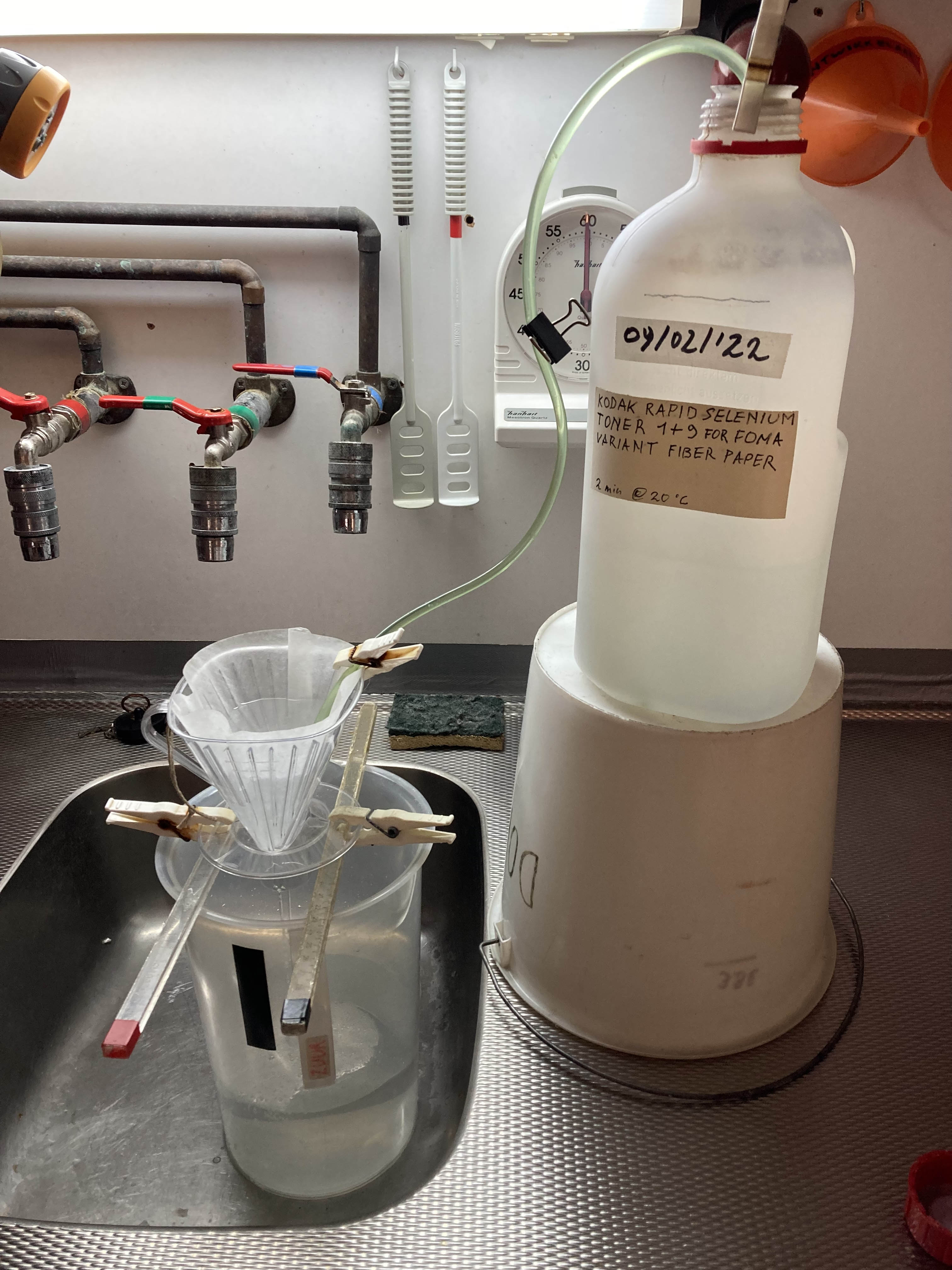

And in some cases, I just filter the product (*)...
Avoiding headaches is rather simple: just stick a pice of masking tape on the jug and write on it the date of first use and the amount or the surface that went through. It's just a matter of basic working discipline and organisation (which is paramount in a darkroom).
(*) This is how I do it while tidying up the darkroom, thanks to gravity...

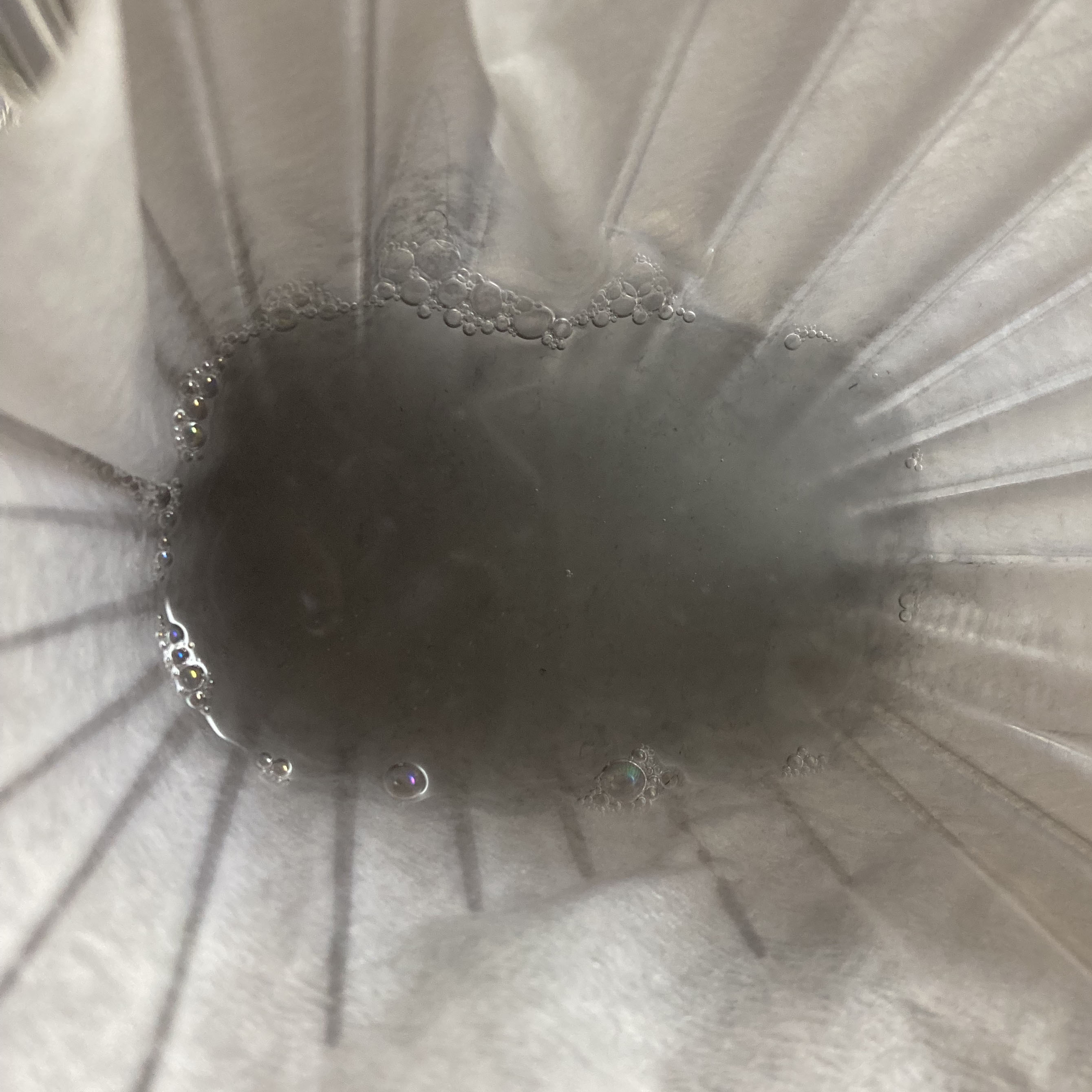

I forgot to show wat's left once KRST is filtered after an one day printing session, this shows that a lot is carried over...
This is (was) 2,5l 1+9 of work dilution.
