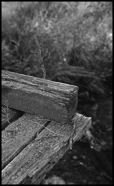

Had my first go at B&W reversal using FomapanR, i was following the instructions of sort posted here but the results are not great. Can somebody confirm what i think is overexposure on the second exposure, or something else.
It looks like the highlights are flogged.
Thanks

You cannot overexpose the second time. Do second exposure to a frostet 60 W incandescent bulb at two feet from both sides.
Your bleaching is not complete. Agitate well for at least four minutes a 20° C. Agitate all baths.
You can over expose at the re-exposure stage but it has to be by a very considerable amount and high light intensity so is unlikely in this case. It's more likely to be poor bleaching and perhaps washing afterwards.
Ian
A creamy off-white positive image, the developed and bleached image should have cleared as the silver from the first development has been removed from the film emulsion.
Ian
OK thanks. I extend the bleaching time. Visually what should I expect to see when the film is bleached, just a creamy/white base?

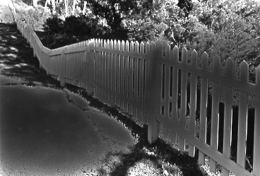

I had a bleaching problem.
But problem resolved
So you used their kit, the one that says it's ideal for TMX? Works well with Foma R and FP4?
That's great to know. I'm kind of itching to do some B&W slides, maybe some B&W Infrared with my frozen stock of Efke IR820.
