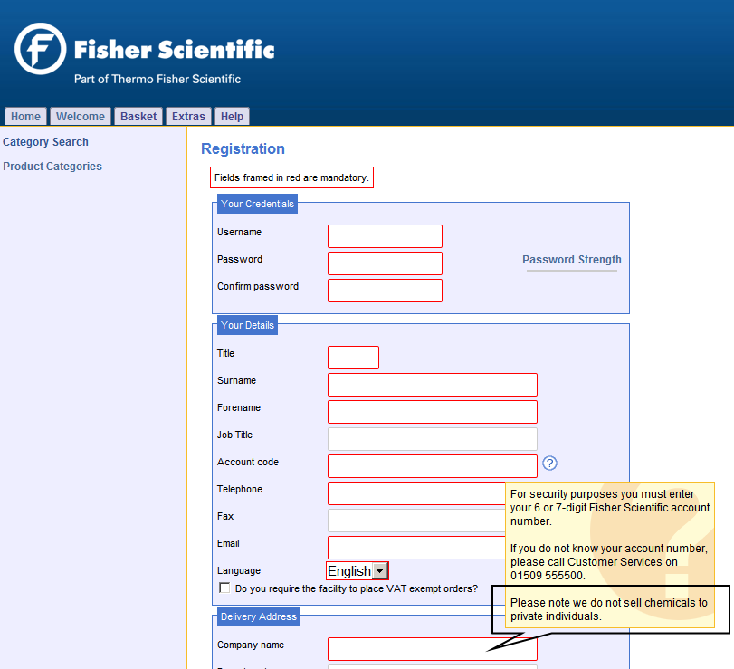

Sorry to bang on about this, but Fisher don't sell to private individuals either.
I'm not asking for any further sources of chemicals, by the way, simply pointing out that it sometimes is quite impossible to buy certain chemicals without making quite extreme and expensive efforts to do so ...
