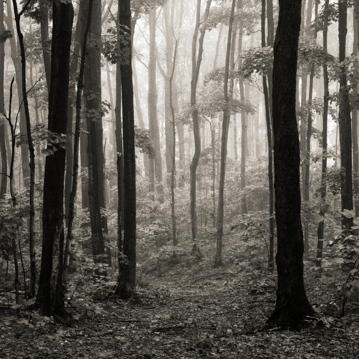

The forest shot is Ilford Delta 400 in Rodinal 1+25. Printed on Fomabrom Variant 112, toned in Moersch MT3 Vario and selenium. Hasselblad and 150mm Sonnar lens.

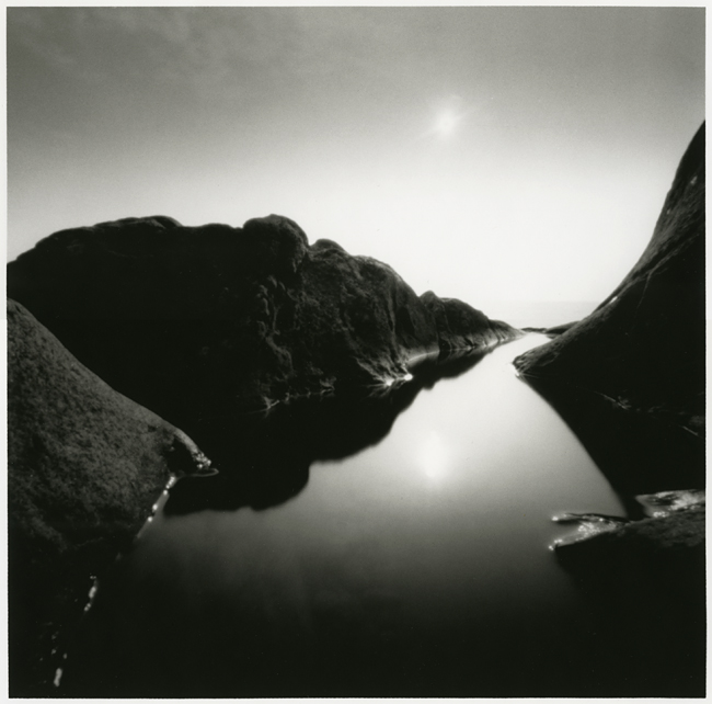

The water shot is Kodak TMax 100 in Xtol replenished. Printed on the same Fomabrom Variant 112 paper using the same toners. It's a pinhole shot.

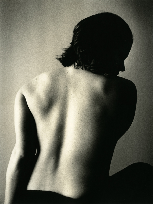

The female back is photographed using Fuji Neopan 1600 in Ilfotec DD-X. Printed on Ilford Warmtone in Ethol LPD, toned in the same toners as above. Pentax KX 35mm usinga Vivtar Series 1 zoom at f/2.8.
