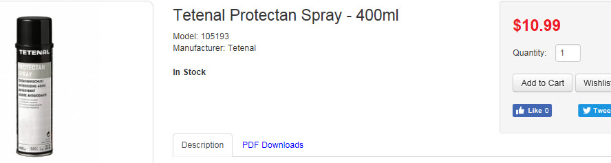

Additionally by giving the remaining contents a shot of TETENAL protectant (a staple item in most labs I have worked in)
displaces air/02 and keeps the developers in Good Condition until needed.
I hope this answers questions and Tetenal is a respected brand used around the world for this exact purpose,
Good Developer+Good Bottle+Protectan........any questions?

Dear Mr. Sperera,
You can email the folks at Freestyle sales, they can give you full breakdown of their chemical plastic composition
of their 5L bottles. I know for a fact they have been shipping their developers in them since 2005, without issues.
displaces air/02 and keeps the developers in Good Condition until needed.View attachment 195902
When it was available I used the Patterson equivalent for years. There is also discussion other places in Photrio about using marbles for the same purpose.
