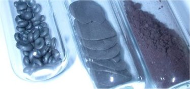

Apparently at least some of the silver is dissolved and not completely replaced. What else would account for the black colored sludge that's found at the bottom of a used container of Se toner working solution?
Apparently at least some of the silver is dissolved and not not completely replaced. What else would account for the black colored sludge that's found at the bottom of a used container of Se toner working solution?

I have no idea but selenium itself looks like that too:
http://en.wikipedia.org/wiki/Selenium
