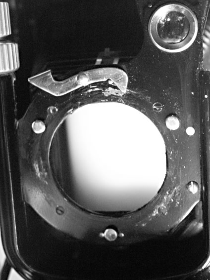

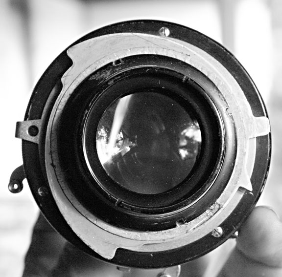

I have just done a bit of a search on Bergheil and unless I am mistaken, I think I have one.
I certainly have a similar camera with the spring loaded lens release mechanism. Mine didn't come with a lens or its associated mounting plate but I'm sure the catch on the body is the same. Can you post a close up of this area so I can compare them?
Steve.
hi steve.
here are two images for you.
the first is the frontplate of the Bergheil. The second, the back of the lens..
Hope that was what you was asking about. (?)
emil

Zeiss Ideal, Favorit, Juwel and others all had removeable lenses but a photograph of the camera would easily identify it. The Zeiss lenses have two bayonet ears extending outside the shutter housing, the Bergheil uses a flange behind the shutter.
