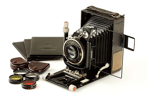

Today I just got a Bergheil 9x12 in a beautiful condition!!:tongue:
as the image show, it came with the Heliar 13.5cm - 6 plateholders and 6 different filters/push on lenses. (yellow - green/yellow - orange, and a wide angle push on lens and a tele push on lens + a little diffusion disk...)
and all in the original, very well kept leather box.
fantastic condition for the price (all in all ca 200€ or 300$)
when looking at the cassettes, I noticed that 4 of then is with the 6x9 inlay - not 9x12.., but Stine has an ols Linhof technicaIII, and the old cassettes (inlays) fit perfectly in the Bergheil cassettes! Problem solved!
the camera is with interchangeble lenses, so I can't wait to try this out.
Of course with the Heliar, but also with my new Dynar and other small lenses..
I am a happy man today - and so are Stine (not a man though..) as the lens can be directly fitted on her Linhof:smile:
