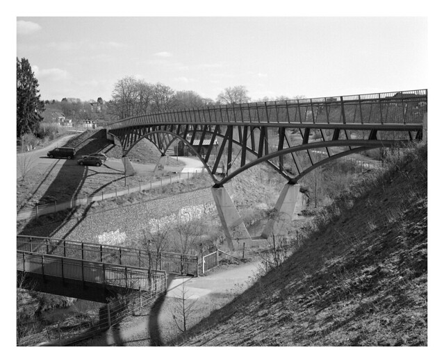

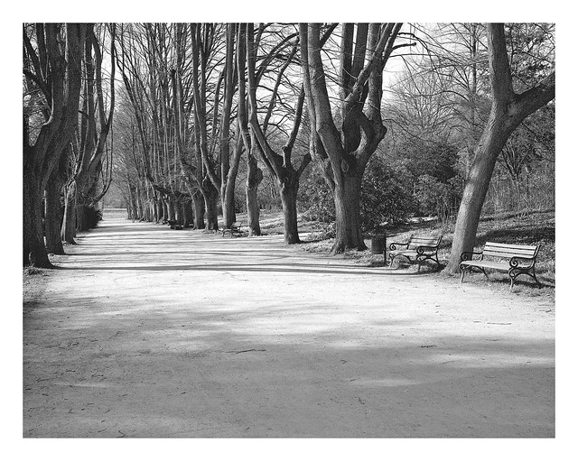

My first essays... The film has a 'blanco' of 0,20 density versus FP4+. What is the reason? X-tol works well with T-max 400, so no no problem of the developer.
Some images: https://efbeo.blog/2017/06/13/2452/ Pancro 120 @250 iso, x-tol 1+1, 20°C, 20'. Epson V700. Today, I printed a scene with a contrast of 8 stops with the Durst 805 splitgrade. Workable...

Indeed, I prefer also printing in the darkroom. For what it's worth: some thoughts and images about the combination: https://efbeo.blog/2017/06/16/first-impression-pancro-x-tol/ This w-e I wil give it a try with ID-11. Kind regards Fred

In the mean time I did 2 test. 1) Pancro @ 400 iso and x-tol. 'For me': this combo doesn't work at all. The grain is terrifying. So, I don't show the results of the testfilm. 2) The second testfilm: Pancro @ 400 iso in ID-11 1+1 17' at 20°C: one 120 film, 10 images. The results you can find on my blog. There was no post-processing. I'm disapointed about the grain and the sharpness. 'For me' there are much better films on the market (like FP4+, Acros, Tmax100 and Tmax 400, Tri-x. Pancro is too much marketing. It's a pity that I must say it.
Just for what it's worth. Kind regards fred
https://efbeo.blog/2017/06/16/pancro-and-id-11/

In addition: with ID-11 the blanco reading of the film stays at 0,20 densitity. And in the highlights the density was not above 1,30 what AA gives for zone VIII highlights.
