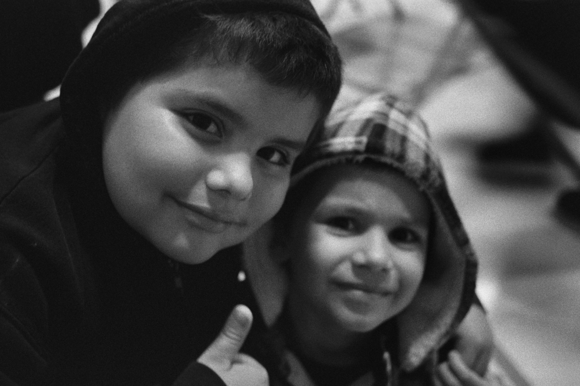

First for the film. This film certainly has beautiful midtones, and the highlights are clear and smooth. But it seems to be somewhat lacking in shadow detail. But it is hard to tell from a limited bunch of (good) pictures that you didn't take yourself. This film is certainly not grainless, but the grain is very smooth and regular. I agree that it seems to be an excellent portrait film.
About scans now. Done properly, scans of negatives can be excellent. Very good digital prints can be made if sufficient care is taken at each step along the way. Digital requires the same care and refinement as analog, but the technique is much different and somewhat more complicated. The equipment needed to do a good job is very expensive and fussy. Scans of prints are sometimes needed. In my experience, which is limited, they are always somewhat lacking.
In the higlights you can see, the grain is not that beautiful. That's why for portrait of white caucasian people, often the skin is overexposed. IMHO
Perfect! Is it a 'pure' scan...without post processing? Scanner? When will you give an on-line workshop then... :smile:
You cannot do a scan and not do some post-processing. Adjustment of brightness and contrast are always necessary.
My rule of thumb is if it only needs the same adjustments as doing a "straight" print in the darkroom, it is fine for APUG.
Sometimes scans of black and white will come out with a tint or colour cast. I'll adjust that as well.
For colour, I will also make normal adjustments to colour balance - again, same as with a darkroom print.
Not sure whether I used my old Minolta Scan-Multi scanner or the old Canon 9000F scanner - probably the Canon, because the Minolta scanner has been problematic since Windows 7, and now has additional problems.
You don't want me giving a workshop. My poor scans are at least as common as my good ones!
FWIW, while this scan is a reasonable facsimile of a print from the same negative, it definitely has a different flavour to it. The print tends to subtly emphasize depths of tone and subtle textures in the mid-tones and shadows, whereas the appearance of the scan on a screen looks more like a transparency that subtly emphasizes the luminescence of the highlights.
A presentation that depends on reflected light will always appear different than a back-lit screen.

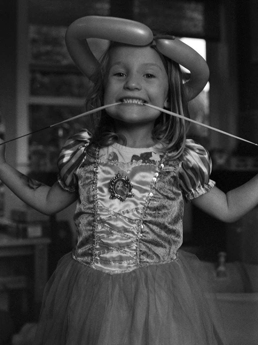

Will this do?
6x6 negative. Kodak TMY-2. Mamiya C330
IIRC, my 135mm Sekor C (blue dot) lens, although it might be the 65mm.
That's beautiful, Matt! I just got out of the darkroom making some prints from 35mm TMY and I think it looks fantastic printed and scanned alike.

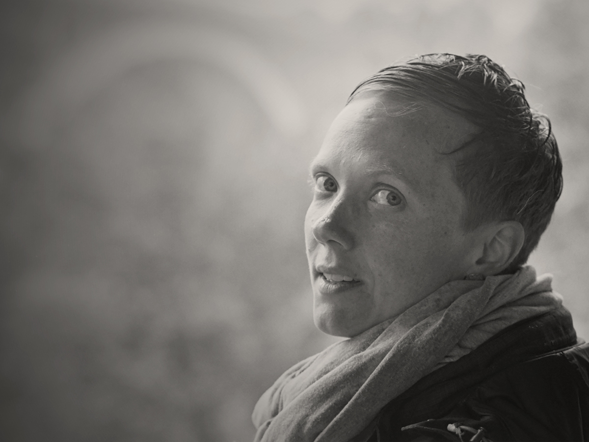

Hi!
Two Trix400 shots just to compare:
10 -
11 -
Developed with con Perceptol stock.
What do you think?
Cheers!!!!
Antonio
Thanks for this, Antonio. Many of the other examples I have seen in this thread and via some of the links seem a little flat to my eye, but your results look promising.

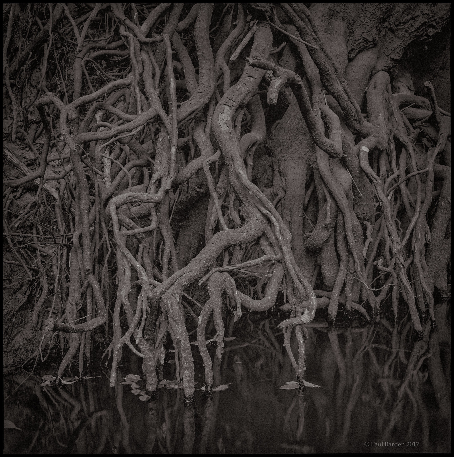

Bergger Pancro 400 shot at 200ASA with my Hasselblad w/standard 80mm lens. Film processed in Rodinal 1:25 for 8 min (as recommended).
