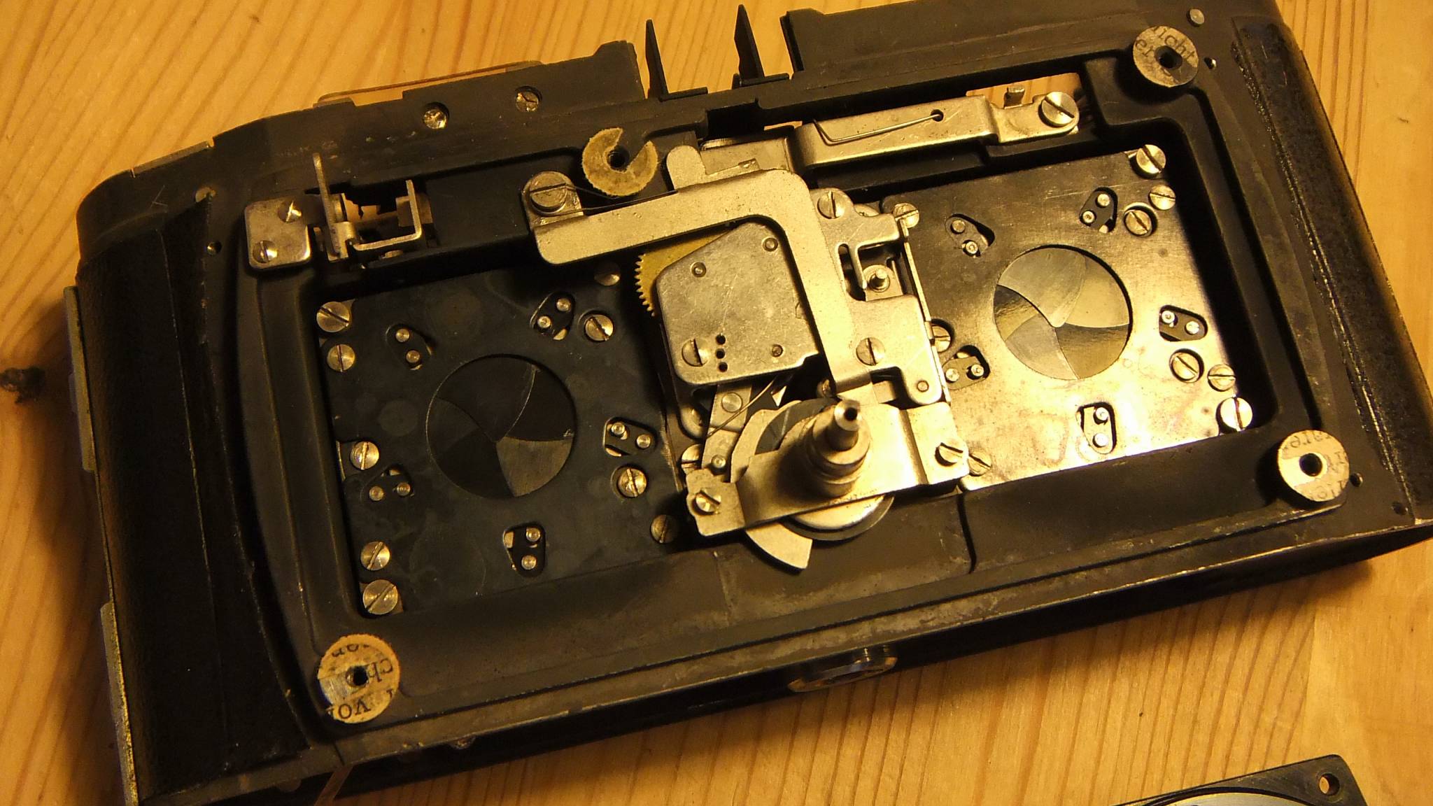

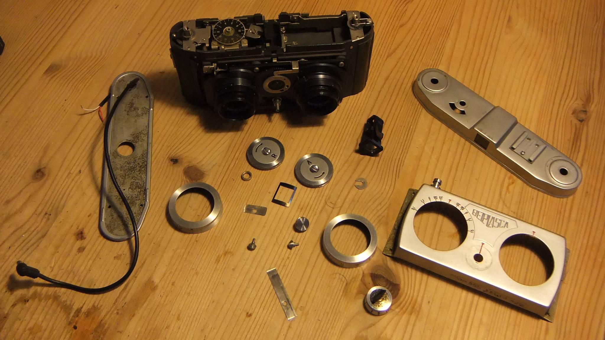

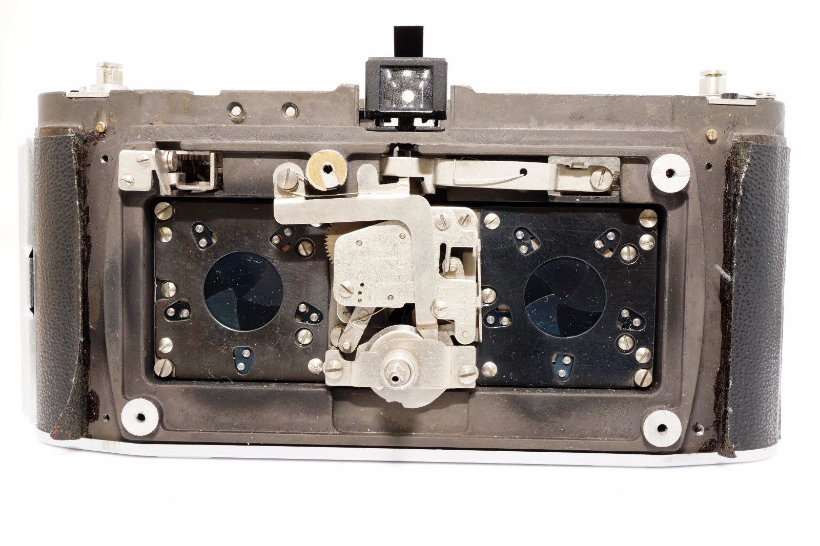

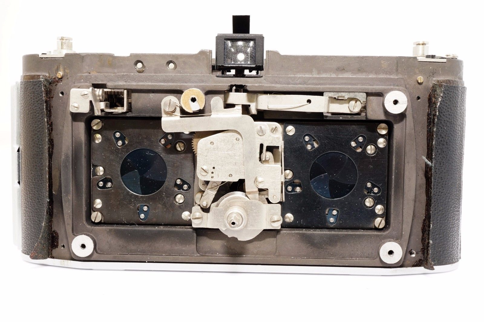

Here are some pictures of partially dissembled Belplasca recently listed on eBay. It may be helpful to anybody trying to work on the shutter. I was able to lubricate the shutter without much disassembly. I removed the top for the viewfinder cleaning (thanks Jack!) and applied few tiny drops of oil with a syringe and needle through the hole over the shutter mechanism. It made the slow speeds working again. I can't wait to see your hot shoe project as well! s-l1600 (9).jpg s-l1600 (10).jpg

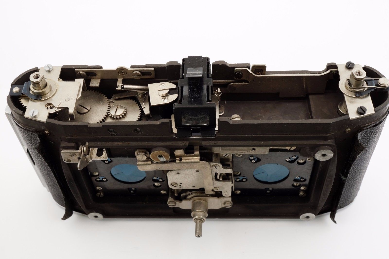

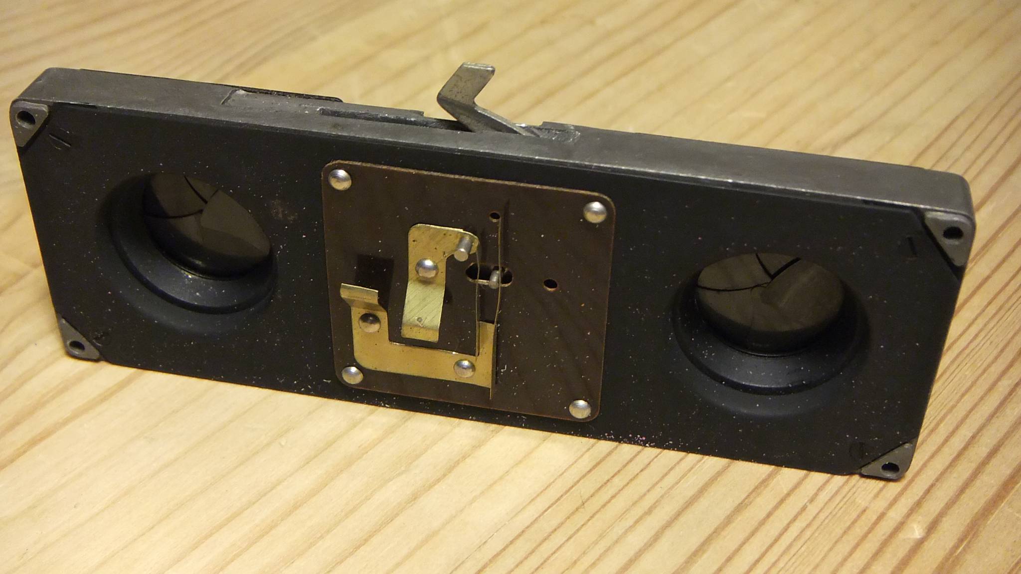

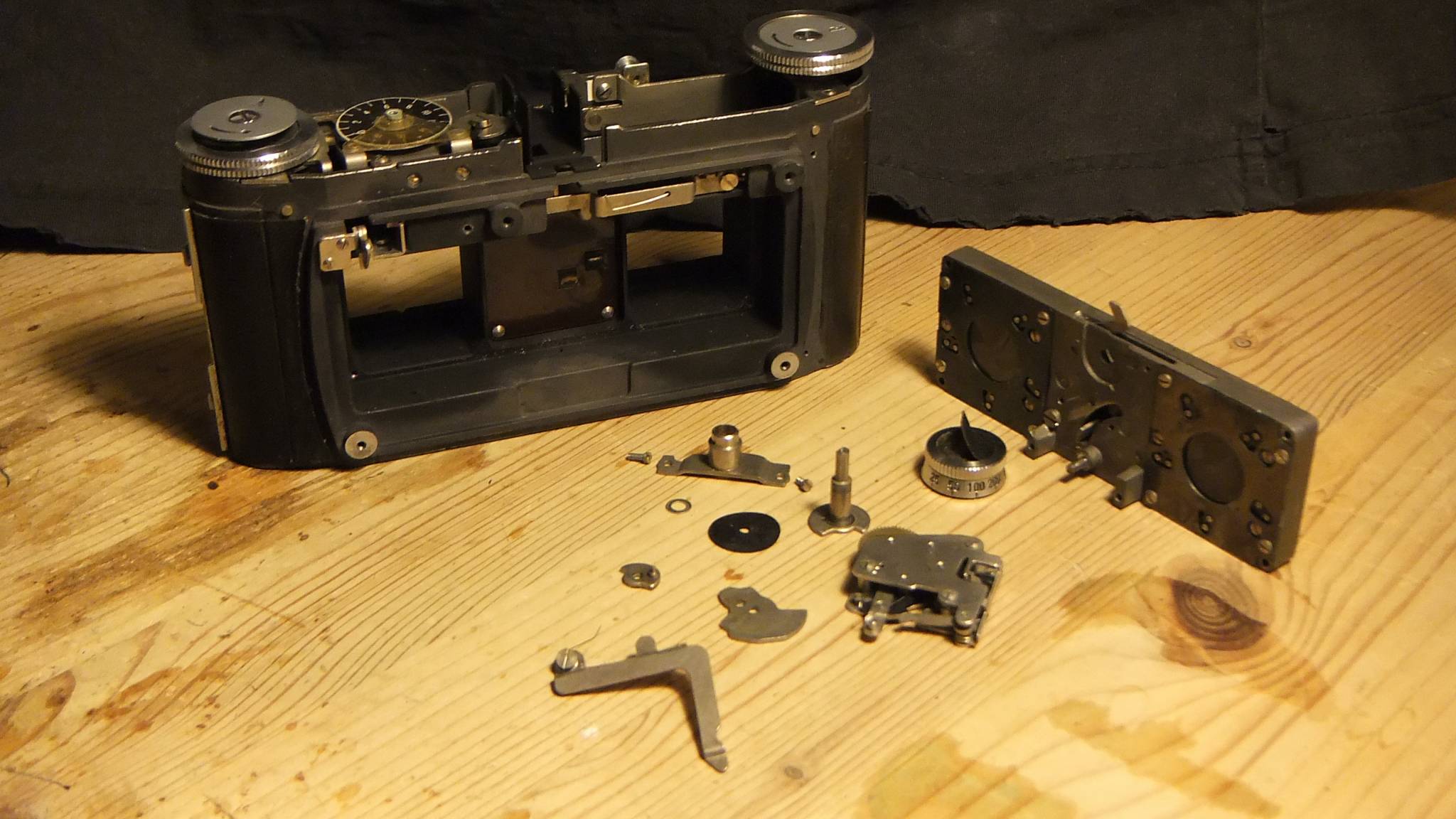

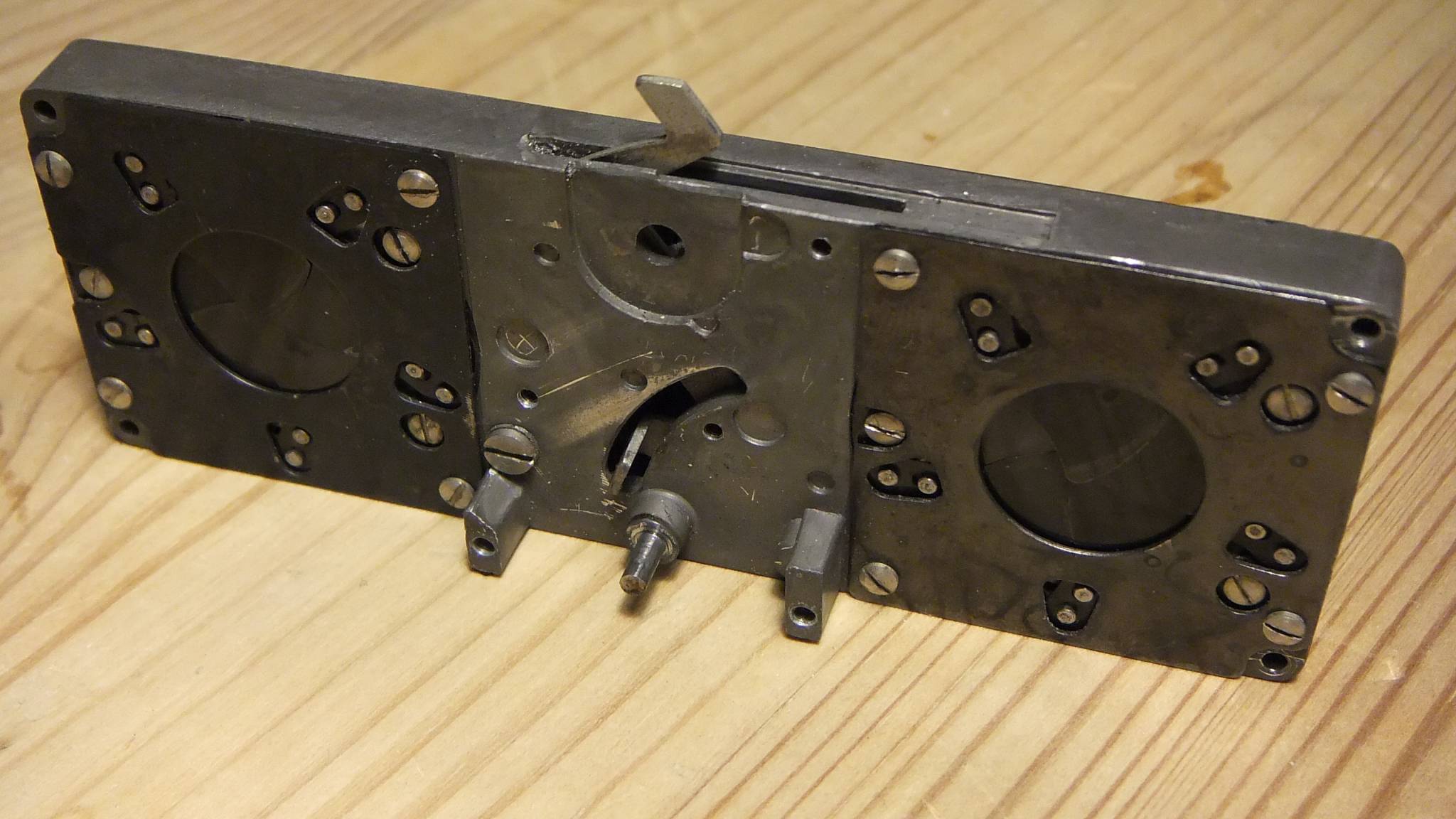

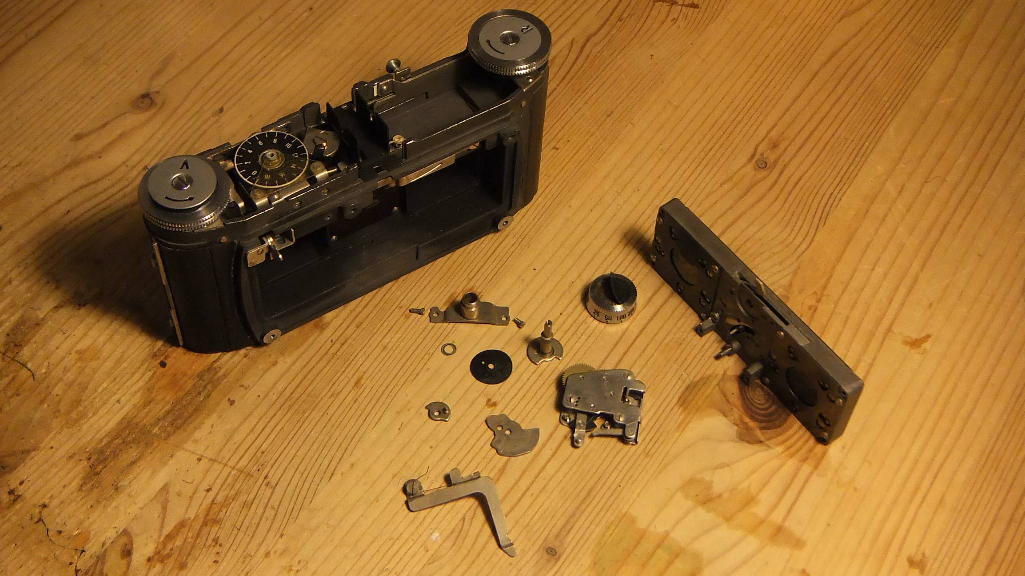

I've dismantled my camera as far as I need for the shutter fix. The problem was simply that the speed knob was in the wrong position. There's slop between the shaft and the knob. Dunno how I'm gonna fix that. Does anyone want to know more about the film advance mech before I carry on? Avortex, did you fix your advance problem? Mine was jamming because there was a part missing. This part keeps the advance knob from jamming against the camera top. I wonder who it was that went inside the camera and lost the part? Photo 'MissingPart.jpg' attached, there should be two, I only got one. I guess I could make one by cutting a suitable washer. I'll have a go next weekend. Photos show where I am with this. Love that shutter module. It's completely self-contained, no risk of the leafs getting out of place. You can see the flash contacts on the back.
Bad news about the hot-shoe conversion. It will require drilling a hole in the main casting. I don't expect many Belplasca owners are prepared to do that. If I can keep swarf from getting everywhere I might go for it. There will be no risk of light-leaks, just swarf to clean out.
More photos tomorrow.

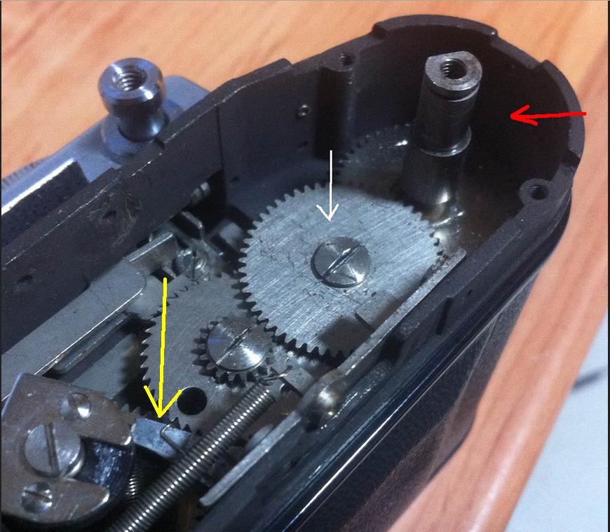

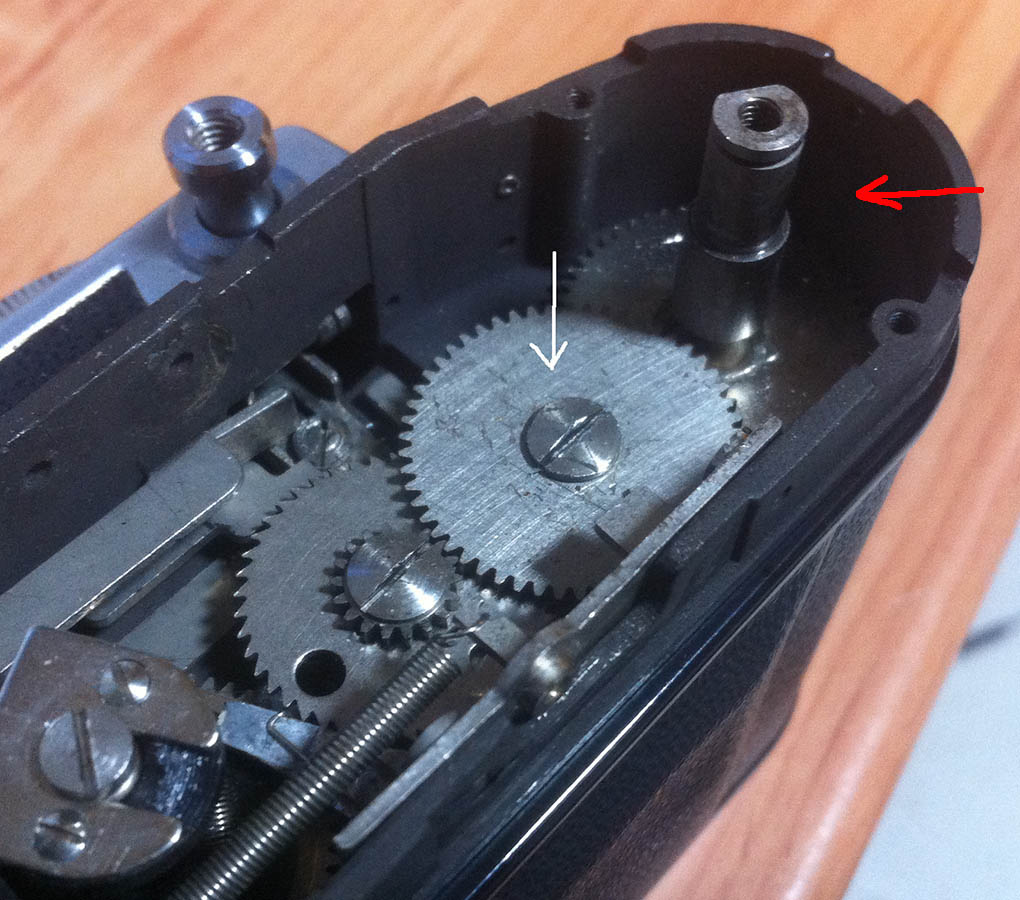

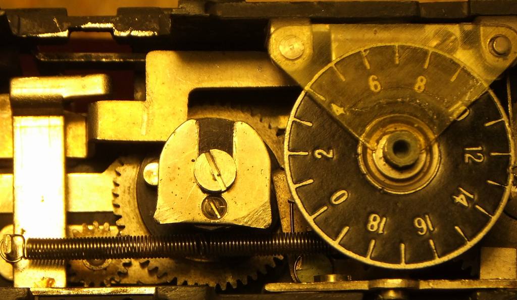

I've started to open the advance system, but I can't remove the screw pointed with the white arrow in the attached picture. Is this resistence normal?
I've also observed that the piece pointed with the red arrow moves a bit freely when I touch it. Perhaps the problem is there.

That doesn't sound unreasonable. One of my Belps is still in pieces so I could check if it's the same, but I can't do that until the weekend. (06/05/17) If you want to remove that screw you will most likely need a very good quality screwdriver and sufficient downward force if the slot so not to be damaged. I think it will have locking compound on it. Does the screw have to be removed?
I would like to inspect the dancing piece pointed with the red arrow, so removing the blocked screw looks mandatory, but perhaps I'm wrong and there's another way to access it.
I remember now that the repairman told me last year that he glued some pieces to secure them. Perhaps he glued exactly that blocked screw.
I can see the problem with yours just by looking at that picture. The lever I have pointed to in LeverWrong.jpg with a yellow arrow is in the wrong place. It should be more to the right given the position of the 1/3 advance cam. It is sprung, so can you gently move it to the right with a screwdriver blade as shown in MoveWithScrewdriver.jpg? If you hold it to the right a couple of millimetres, the advance knob spindle should turn freely. Try it and tell me what happens. The top of this lever engages with two cutouts in the frame advance cam. You will notice that these cutouts are in 90 degree and 270 degree positions to provide the alternating 7-perf then 21-perf film advance. One frame then three frames.
Jack
Jack, you're right. If I push that lever to the right, the advance knob can be turned freely :smile:
If i quit pushing it, the advance knob stops again. This is promising...How can I fix this?
Thanks again for your amazing and valuable help!

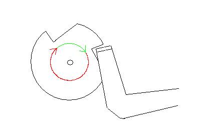

It's good news that the advance knob tuns, but that lever should be held to the right by the contour of the film advance cam and it seems that's not happening on your camera. Is the top of that lever engaging in the cam? You must identify this cam; it's got the two cutouts at 90 and 270 degrees. On my camera it's black. I've attached a little sketch. The green arrow shows the rotation for one frame and the red arrow shows the rotation for three frames. Unfortunately, on my camera the two screws that hold the frame counter have been chewed up by whoever last had the thing apart, so I can't remove the frame counter, but anyway I've shown two photos of this cam. One photo shows the position after one frame has been advanced and the other shows the position after three frames have been advanced. The important thing is that if the cam is in any other position that lever should be held to the right so the advance knob can be turned. For some reason that isn't that happening for you. Try to see if that lever is engaging with the cam? I think I'll drill out those two chewed screws so I can remove the frame counter, but I won't be able to do that 'til next weekend. When I've done that you'll see how the cam controls that lever.

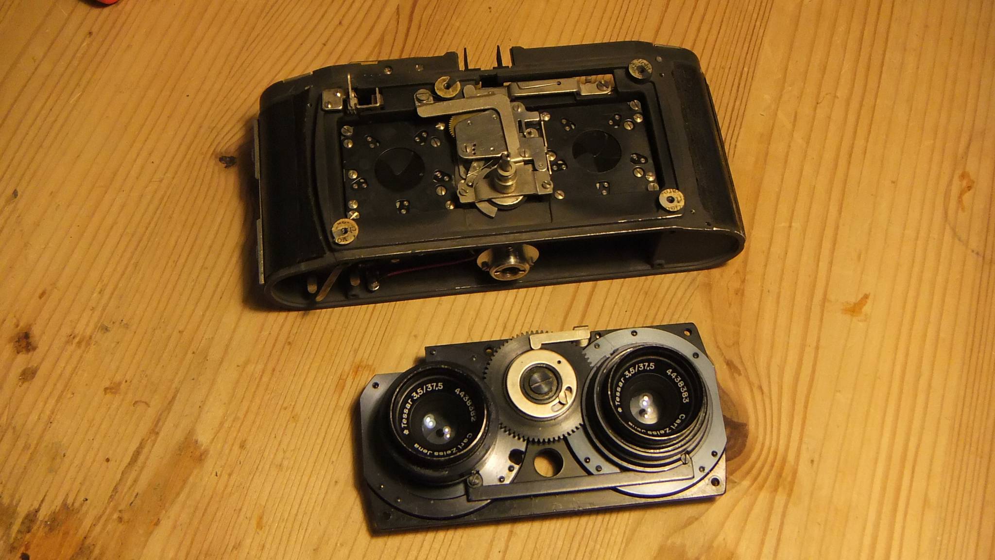

I have one other issue with the camera: I can't focus the lenses. The distance ring is completely stuck at a setting of 4 meters. Would anyone be able to suggest me what I can do?
Also please let me know if it's ok to ask this question here or that I should start a new thread.
Best, Edwin

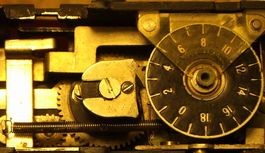

A long while ago I promised to give what help I could with the Belplasca's film advance mechanism. I've finally got 'round to making this little video clip of the one-frame/three-frame mechanism at work. Please excuse my awful speaking voice!
Avortex, is this topic still alive? Sorry I was so long getting back to you. Let me know if this video clip is of any help.

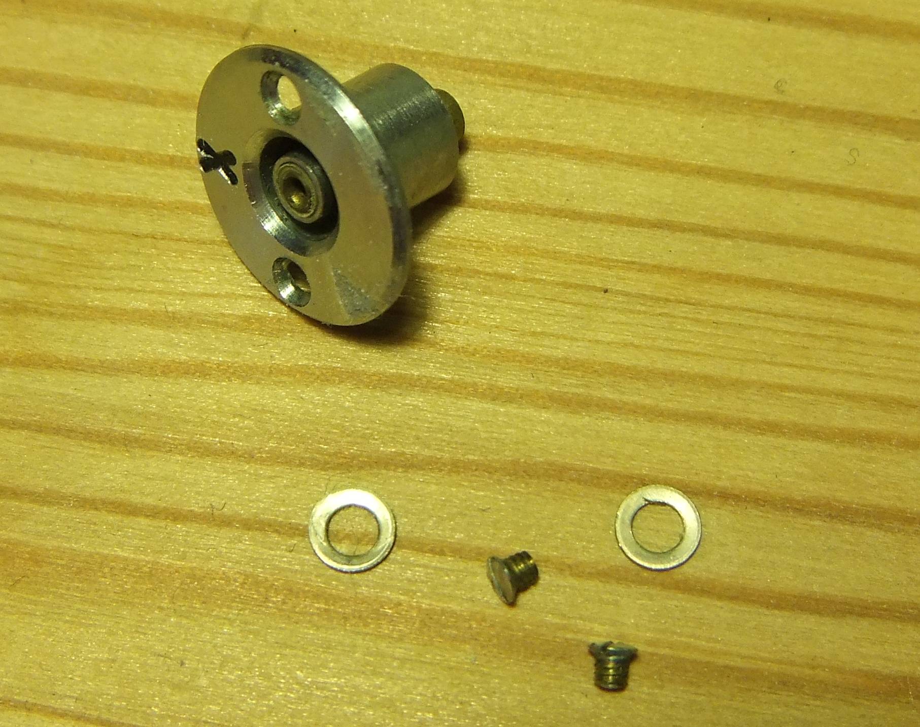

Welcome Edwin! Yes, this subject might warrant a new thread, but we've been using this for general Belplasca repairs. I've just taken the front off one of my Belplascas as you will see from further back in the thread. To get to the focusing mechanism you have to loosen the three grub screws around the focusing ring, but what I failed to mention is that this could loose you the lens' register. The aperture ring is indexed by the iris mechanism, but the focus ring is NOT indexed. If you are confident that you can re-register the lens then you can just pull it all apart. If not, and I can find a few hours spare next weekend I'll describe what I did.

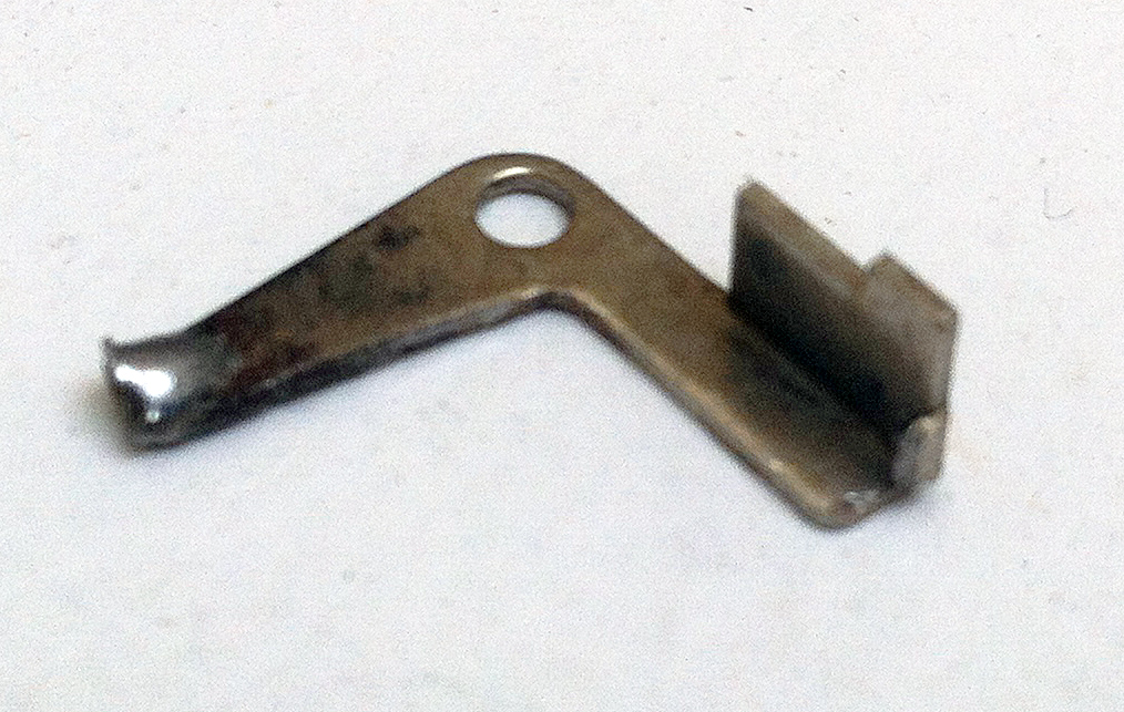

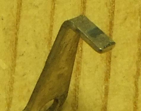

Okay, I can see the problem. There's something wrong with the lever, the L shaped lever. The end that should engage in the cam isn't doing so. From your video clip it looks like it has been repaired? It that solder or weld I can see on it? I haven't got my Belplasca in front of me right now, so at the weekend I'll remove that lever from my camera and we can compare it with yours.
Thanks, Jack! Yes, it has been repaired three times by 2 different repairmen. In all cases, it stopped working after a pair of rolls...
In fact, I thought my camera was not possible to repair and closed the case some months ago.
Nothing is impossible. Do you still want me to take this lever off my camera so we can see how it differs from yours? You'd have to remove yours too. I would strongly recommend you go ahead! This is a superb camera and I've used lots of cameras. If the repair involves work on this little lever, then it may take some time. Don't expect results for a while yet.
Hello Avortex,

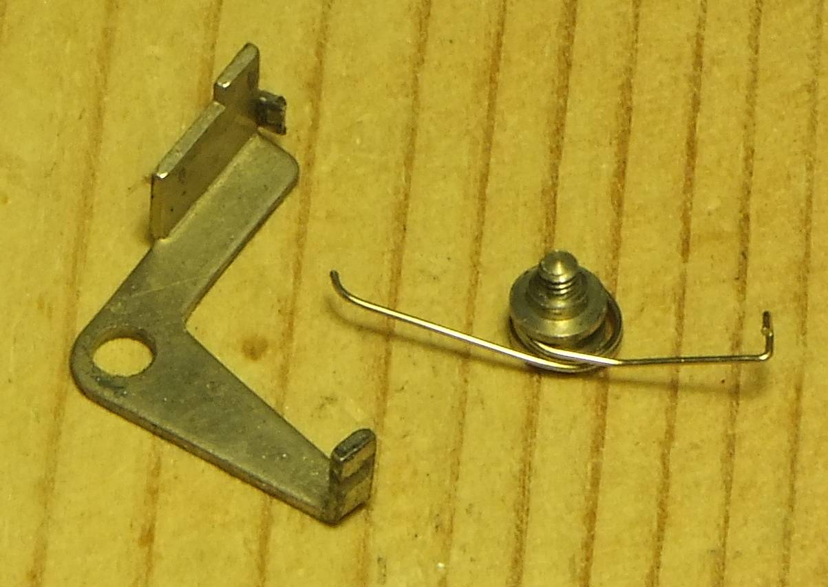

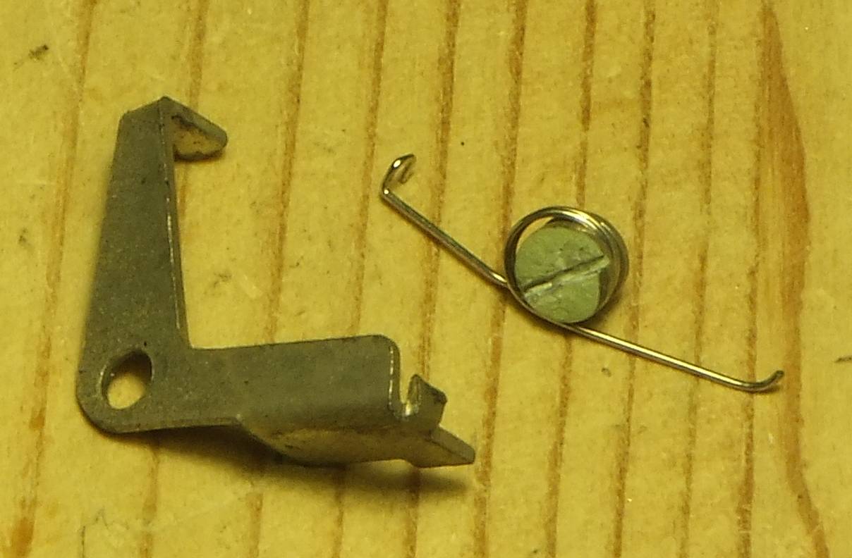

Attached are three photos of this lever taken from my working Belplasca. It is easily removed by undoing the single screw that is its pivot. Notice that on mine the head was smothered in locking compound. Dunno why they used so much? You must remove any such compound from the slot completely or you risk chewing the screw head. I suggest you remove the same lever on your camera and compare it with my photos. The retaining screw is a clever little component with a cut in it to retain the spring. There is no need to remove the spring from the screw.
Look carefully at both the spring and the lever. Repairing the lever is quite possible, but if the spring isn't right, that's a much bigger problem. Notice that one end of the spring is bent into a hook shape. The picture 'Suspect. jpg' is the tab that engages in the cam that provides the 1/3 frame advance; is yours the same?

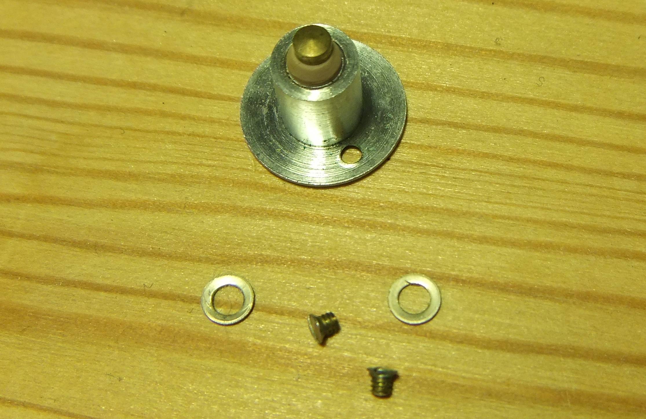

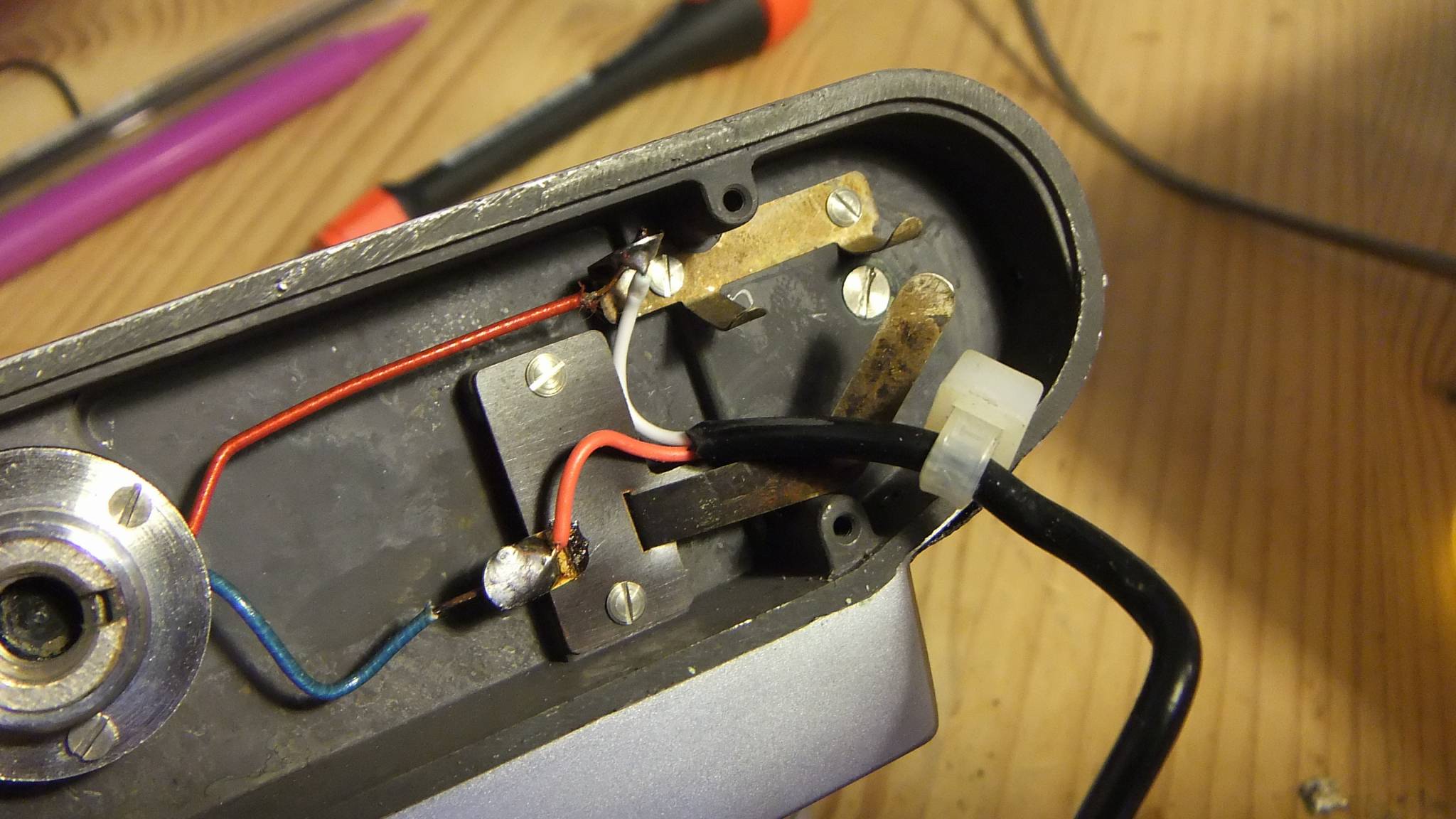

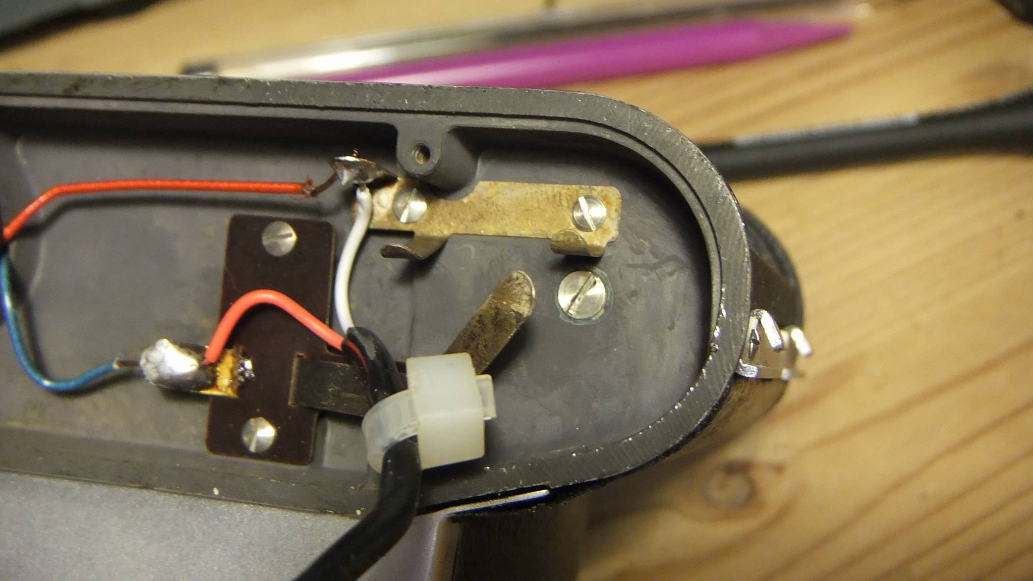

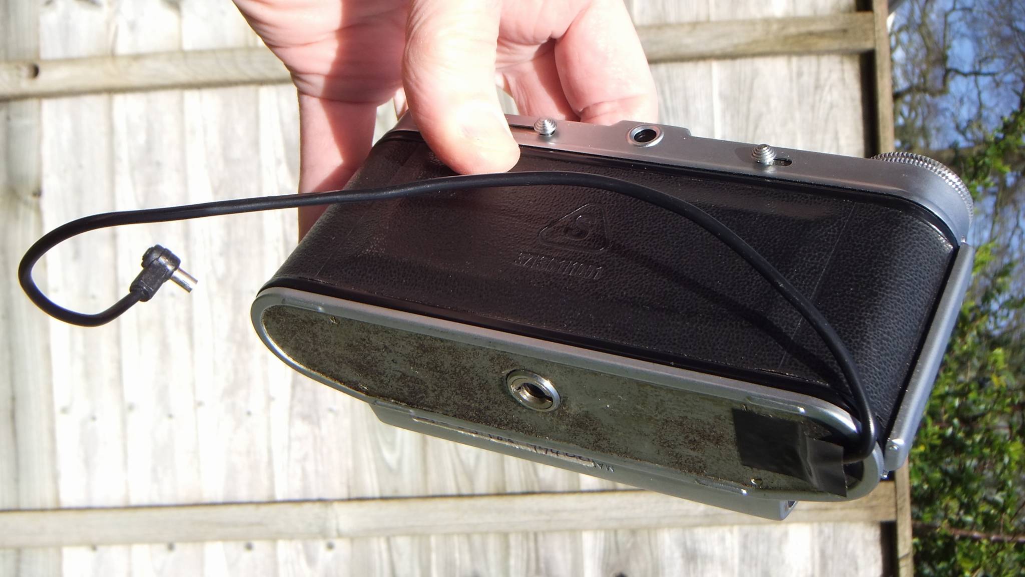

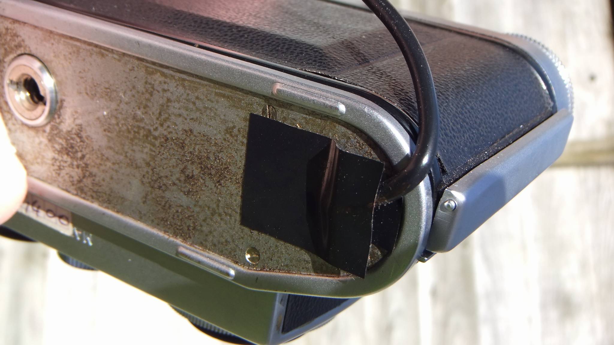

A slight change of subject here. Attached are some photos of how I've been using flash with my Belplasca for the last three years. This mod has the attraction of being completely reversible. I removed the bottom of the camera and soldered a PC cord to the two solder joints there. The existing X socket has to be removed (and kept somewhere safe) to allow the PC cord through, and the cord can be routed up through the ERC to the top where it can be plugged into the flashgun. The ERC can be closed if the PC connector is positioned just in front of the top cover as shown. The tape on the bottom of the camera looks a bit messy, but it's covered by the case! As you will notice, the PC cord has a PLUG on and not a socket like was originally in the bottom. This is because the PC connector on modern flash guns is always a socket? Seems the wrong way round to me, but that's how it is. Of course this doesn't solve the problem of the Belplasca's cold shoe shorting out the hot-shoe contact of modern flashguns. There were some flash guns where you could switch off the hot-shoe X contact, but the modern ones I've come across don't do that. I can't abide those wobbly hot/cold flash adaptors, so I just took the bottom of the flashgun and un-soldered the hot-shoe contact. This again is a mod that's completely reversible.
Curiously, the Belplasca's red wire in the chassis connection and the blue wire is the switched. At least that how mine was wired. Connect the screen of the PC cord to the chassis and the centre core to the switched.

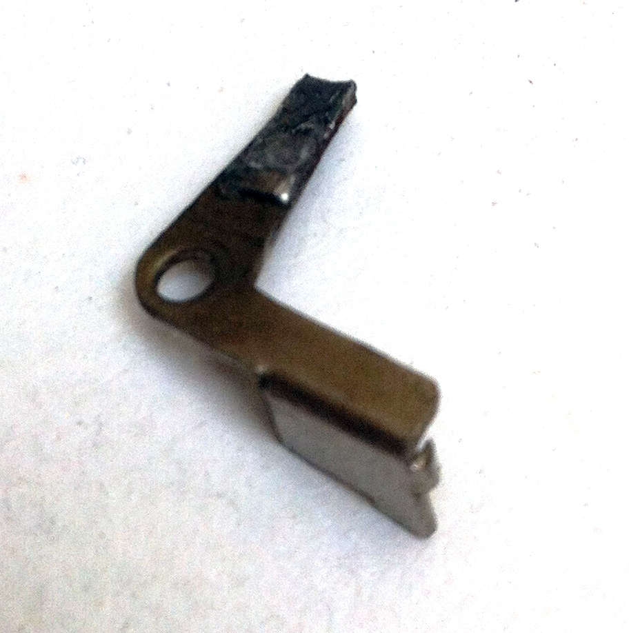

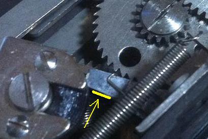

Jack, sorry for my late answer. Lots of work during the last weeks...
I finally took some pictures of my lever. My phone doesn't have macro, but the problem is visible. I believe the repairman did a so-so work with it. Here it is:
