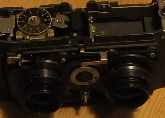

Each of the lenses has its own focusing helix, and the two are linked by a smaller cog mounted in between the lenses. This smaller intermediate cog has a cam on the front of it, and there's a lever - a "cam follower" - that links this cam to the front of the viewfinder.
This is not a great photo but you should just notice that the silver coloured ring mounted on this coupling cog (or pinion) in between the lenses is slightly eccentric. As it turns it pushes the lever resting on it upwards, and that moves the viewfinder assembly. So if it's not working I would guess that the viewfinder assembly has stuck in the upper (infinity) position because maybe the mech has jammed, or maybe the return spring has broken?
I'’ve got one of my Belplasca’s apart at the moment, so I could send you better photographs of the mechanism if you like?

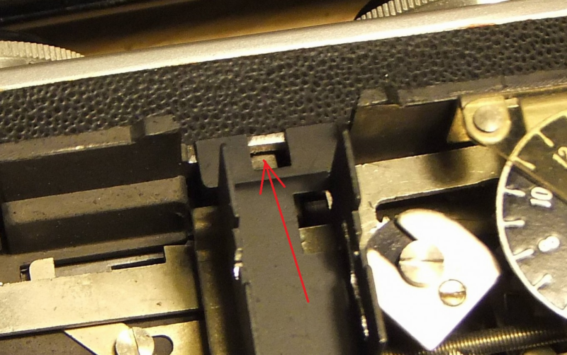

If you get past that point, the rest is easy and the viewfinder assembly should lift out. At his point I suggest you check the cam mechanism thus:
The red arrow points to the top of the cam follower. The little tab at the front of the viewfinder assembly rests on this. When you turn the focusing ring you should see this part (underneath the tip of the arrow) move up and down by a millimetre or so. If that’s happening then all is well. Let me know how you get on.

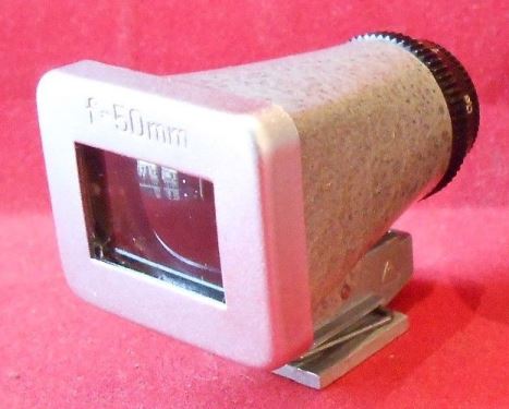

Curiosity Question: Have you eer used an Altix viewfinder with the Belplasca for its larger viewfinder image? If so did you think it was worth it?
Marc
No. One of the virtues of the Belplasca is its compactness. With the ERC closed it's scarcely bigger than any other 35mm camera. Much smaller than an RBT and much much smaller than a twin-rig. Put a accessory shoe finder on it and you won't be able to close the ERC? The reverse Galilean viewfinder of the Belplasca may not be that great, but it's adequate.

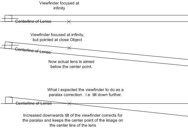

I just looked at this again with Visio. See the enclosed picture. Unless I am really missing something it seems tht the CAM is moving the viewfinder in the opposite direction that it should. I.e. UP as it focuses closer instead of DOWN. Am I missing something here?
OK I made a mistake. Since I couldn't believe the camera could be that far off. I put the camera on the table tonight with the focus at 1m. I placed a digital caliper against the tab the viewfinder rides on and slid it down into contact with the camera body. It measured 0.1800 inches/ 4.57mm. (I know I'm American) As I moved the focus to infinity the depth to the tab reduces to 0.1600 inches/4.07mm Obviously coming up and pushing up on the viewfinder. The amount of movement when I checked the geometry in Visio matches a change from infinity to 1m with the relative viewfinder / lens centers. I obviously made a mistake in my earlier measurement and thought the opposite was happening.
Now its time to make sure the viewfinder moves freely and clean everything before reassembly.

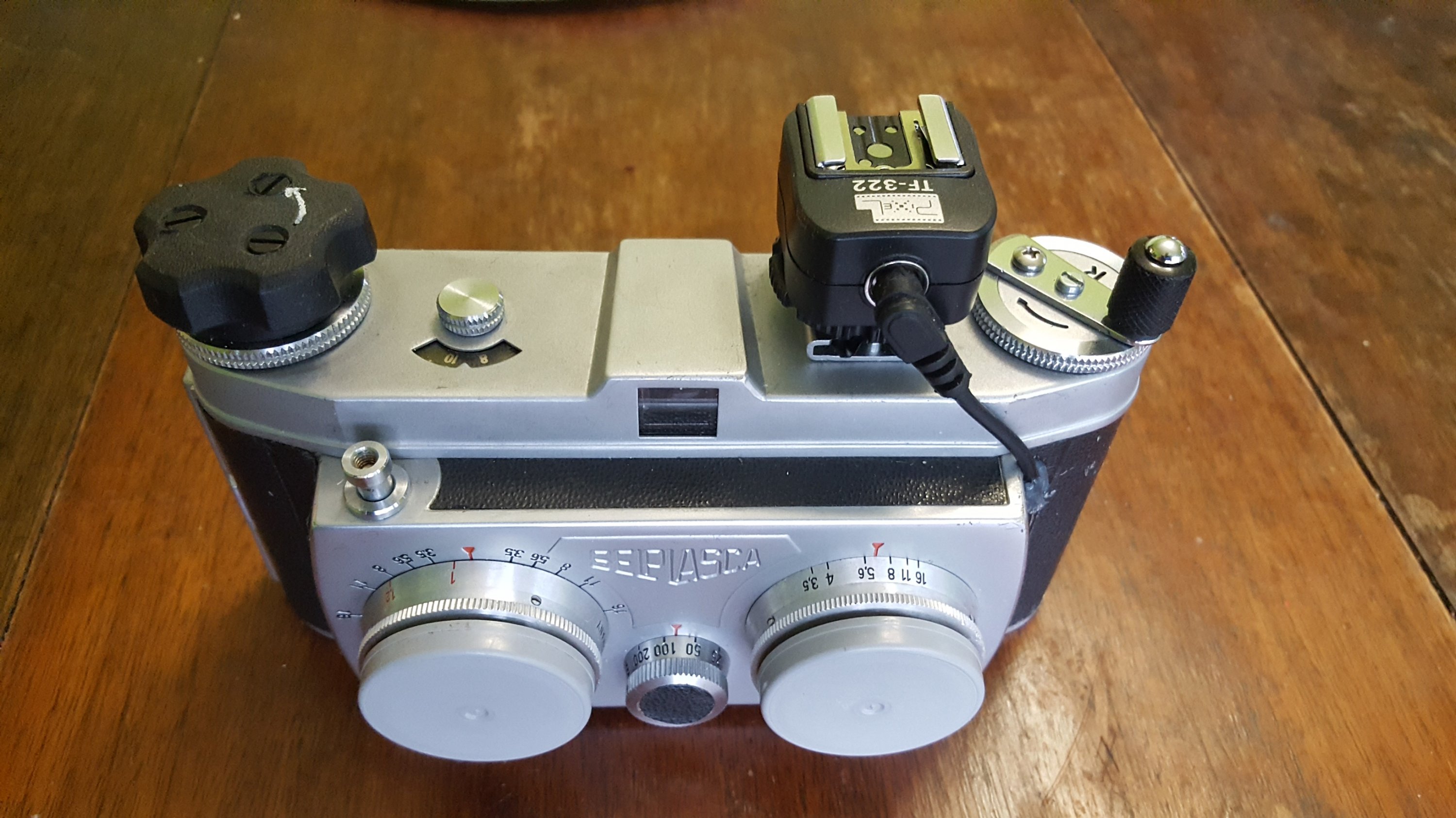

Cool! I especially like the rewind crank. Rewinding with that thin knob is a bit of chore. My only reservation is that the camera will no longer fit in the ERC; I do like the portability of the cased camera.

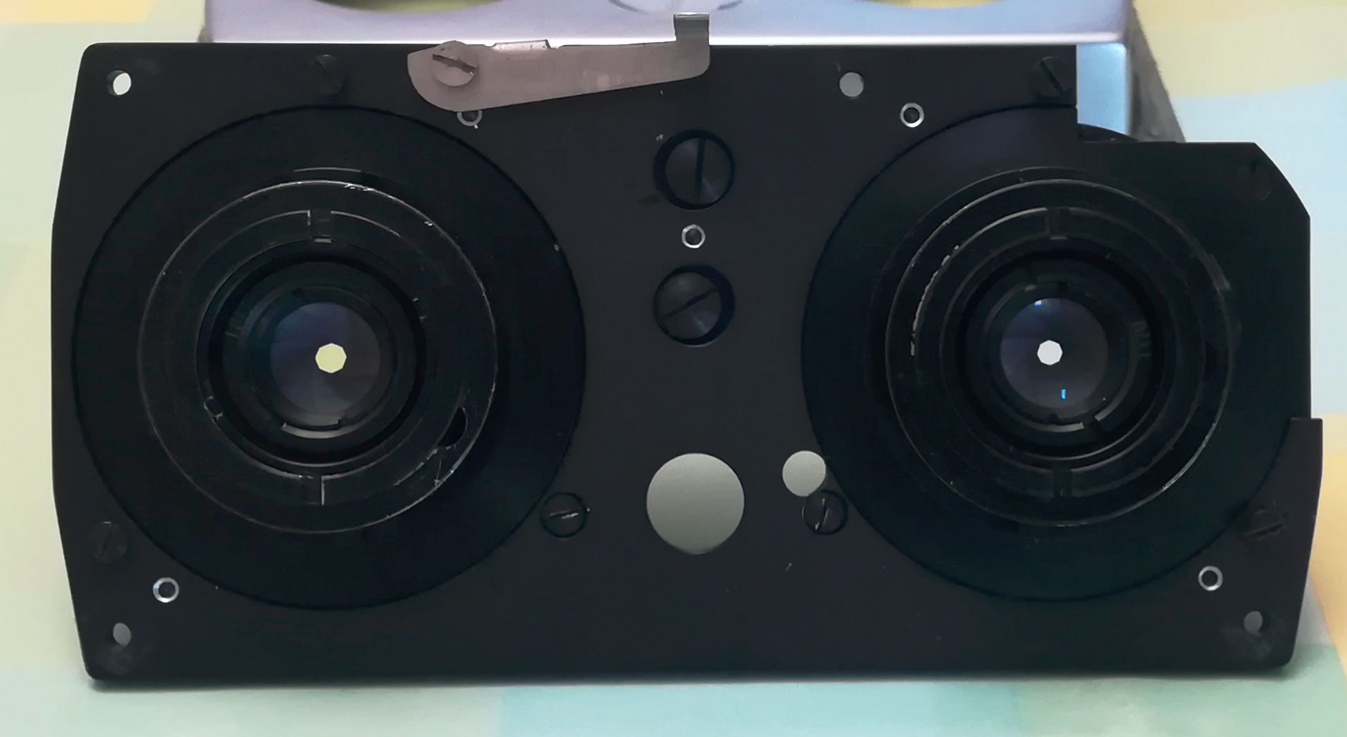

The problem is, that the apertures of the two lenses are slightly out of sync. When the left one is set to 16 (to the stop), the right one is noticably smaller. When I rotate it one mark to 11, the right one increases about to the size the left one was before (I really don´t know how to explain it better). Also, I don´t know how it will affect the results. I just took a few pictures - I will see in a week. I think this photo gives an impression.
Does anyone know if there is a way to calibrate this? I took the front cover off and removed the lens assembly. But there seems not to be an easy way to correct this. I don´t think it is within tolerance and even if the results were ok, I would sleep better when it was adjusted.
I assume that someone was in the camera before, maby a lense was replaced: the serial numbers of the lenses differ by 253 and the alignment of the lettering on the lenses is different (both is not the case with many other Belplascas I found photos of on the internet).
