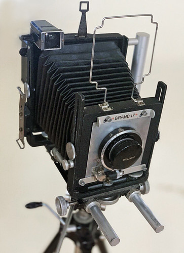

On the really cheap side are New View and Brand. These are sorta of interesting, not a monorail, not a true flat bed, made after WWII with aluminum frames made from recycled WWII airplanes that were melted down in the late 40s. I bought a Brand, found it at swap meet in 1986, paid like $50 for it with pretty good lens. It has good movements, my version is not set as a press Camera, not even sure how the rangefinder would work. It has pretty good movements, it is light, the handle makes it easy to carry it in the field. The image is not of my camera but a press version of the same camera.
aluminium
Paul Howell
Dec 23, 2004
10,173
Scottsdale Az
Here is the picture.
