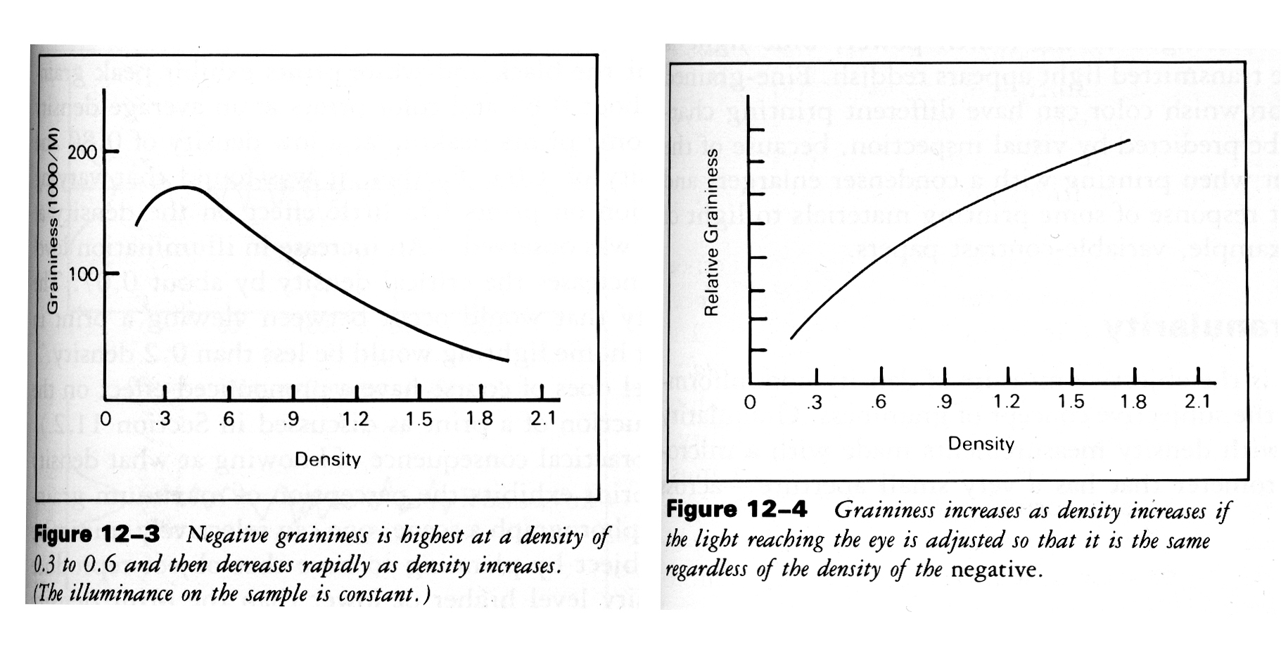

Grain is an inherent film property and is not determined by shadow placement. The appearance of grain in the final print depends, in part on the degree of enlargement, film developer, development techniques (temperature, time, agitation, extended) and of course the selected film.
Exposure is a factor in appearance of grain. One of the reasons why the safety factor was reduced in the 1960 ASA film speed standard was to minimize grain. From Safety Factors in Camera Exposure by C.N Nelson,
"If a large safety factor is undesirable at the present time, why was it thought to be necessary when the American Standards for film ratings and exposure meters were first adopted in the 1940's? The first reason is that exposure meters, camera shutters, and lens apertures were not as accurate in the 1940's as they are in 1959. The second reason is that the camera-exposure latitude of black-and-white films was effectively greater in those earlier years, largely because the increase in print graininess with increase, in camera exposure was not as evident with the large cameras, large negatives, and small degree of enlargement or contact printing then commonly used. The great increase in the number of small cameras in recent years and the increase in the degree of enlargement has made the graininess problem more acute.
Many photographers have adopted the practice of giving less exposure than is indicated by the use of ASA exposure indexes with exposure meters. The American Standard indexes for black-and-white films are used by them only as a starting point for deriving a new kind of exposure index which is obtained by the simple procedure of doubling the Standard exposure index. This practice, of course, has the effect of cutting the safety factor in half, giving the preferred thinner negatives."
I left that second paragraph in because I find it amusing that after the film speed was increased by one stop with the adoption of the 1960 standard, people started cutting their EIs in half.
Here are a couple of graphs from Photographic Materials and Processes by Strobel et al.
"...Loyd Jones, for instance, wasn’t known for his image making, but he is one of the most influential figures in the history of photography...."
For those who enjoy sensitometry, Jones, Rockwell, Davenport, Neblette, Clerc or Pitman may very well be the most influential figures in the history of photography. However, for those who believe making beautiful images is the goal, Adams, Weston, Sommer, O'Sullivan, Bravo, Brandt, Steichen, Stieglitz, Strand, Lange, Karsh, Hurrell, or Cunningham (to name a few) may represent the most influential figures in photographic history.
When we trot out our favorite "gods", we should first check to see which side of the burn you are standing.
I was in responding to a poster. I was trying to make the point that you don't have to be a great photographer to be correct with a technical photographic fact for which the poster implied the opposite.
BTW, you should include the name of the poster to whom you are commenting on. It will help people find the original post with the full comment.
"...Looking at an image doesn't prove anything. It is commonly known that Ansel Adam's Moonrise over Hernandez was underexposed. And while it is widely regarded as one of his best images, it's more an example of printing prowess than a proof of any exposure concept....
For those who are dependent on the sell of images to the paying public, the final image proves everything. In the real world, we do not always place the shadow and highlights on the proper portion of the curve, expose the film properly or develop the film according to standard. Yet we have to make beautiful images from those under/over exposed/developed negatives. Printing prowess is often the firewall which prevents us from becoming a corpse on the gelatin silver highway.
Again, making the point that it's hard to evaluate the individual factors, such as camera exposure and film processing, looking at the finished print in response to a poster's comment.

Exposure is a factor in appearance of grain. ....... Here are a couple of graphs from Photographic Materials and Processes by Strobel et al.
Appearance is the key word here because the actual grain does not decrease with increasing density.
Quoting from the text referring to those two figures:
"A density of 0.3 corresponds to a transmittance of one half, which represents equal clear and opaque areas. One would expect little graininess at very low and very high density levels, but for different reasons. At very low densities there is little grain structure. As the density of the negative increases, the amount of light transmitted decreases. The perception of graininess decreases rapidly as the density increases because our ability to see detail and tonal differences decreases at low light levels. At a very high density, graininess is not perceptible even though the silver in the negative has a very grainy structure."
Those two graphs Stephen posted from Strobel et al. are a result of subjective measurements. I initially though that the first graph has more practical value since for the second graph, the light level has been adjusted so that the transmitted light remains constant regardless of the density level. But perhaps the 2nd graph is equally important in this thread because if one is placing the shadow detail on Zone IV (higher neg density) and printing those shadows to an equal or higher gray value on the final print, then that graph says those shadows will be more grainy than if you gave them less initial exposure on the negative.
Objective measurements of film grain using a microdensitometer reveal that higher negative densities exhibit a higher mean granularity.

According to W.F. Berg in Exposure: Theory and Practice:
" The grainy appearance of the negative itself shows a very similar behavior when inspected over a source of constant illumination. It is possible, however, to alter the illumination of the negative under examination in such a way as to keep the amount of light reaching the eye constant and independent of the density of the negative. This means, in effect, using an apparatus which allows the illumination to be increased at will in order to compensate for the higher negative densities. When the graininess of the negative is investigated in this fashion, it is found to increase continuously with increasing density range. This is a most important result, for on it are based recommendations for the ideal photographic exposure to be aimed at in practical photography."

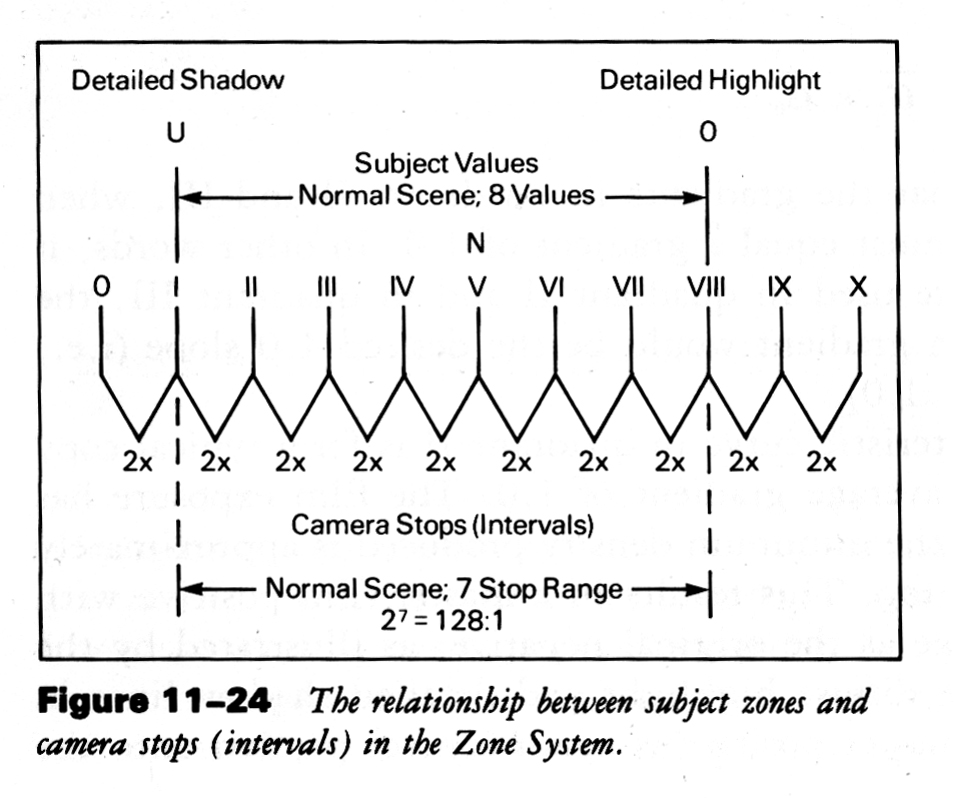

I know Barnbaum advocates placing shadows on Zone IV, and also cutting the ASA in half for standard developers. So, he is essentially saying, "for an ASA 400 film, set your meter on ASA 100, and place the shadows on Zone III."
From there, you would want to develop a Normal neg so that you maintain the same optical density spread between Zones III and VIII, which is 0.91, only now your Zone III is around .54, Zone VIII is around 1.45, giving you tons of shadow detail.

Getting the idea across that: the 10-zones in the ZS and the actual number f-stops measured in a SBR are not always, or even regularly, equal; is tough. People want 1-10 to equal I-X, they don't want to do base 9.3 or base 11.6 math and translate.
Part of the problem is that when we are taught how to "find" zone VIII (or II) in a scene it is often phased as "meter reading plus 3-stops (or minus 3-stops). If a long scale scene is measured at a total SBR of say 13.5 saying "+3-stops" may actually define a point in zone VII not VIII (minus 3 might define a point in zone III instead of II).

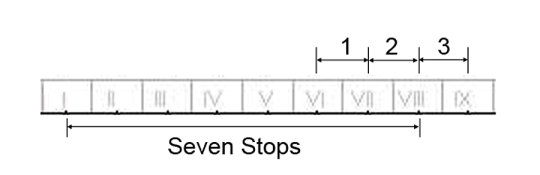

I meter a scene with my spot meter and it reads 6 in the darkest area and 9 in the brightest area. I would say the scene has four stops (or zones) of light. I have had others insist that, no, it only has a range of 3 stops. I just have a feeling that we both would be correct.
That's a three stop range: 6 to 7 = stop 1, 7 to 8 = stop 2, 8 to 9 = stop 3. Same as Zone I to Zone VIII is 7 stops and not 8.
Or
Measured point middle of 6 then
7 & 8 then
Measured point middle of 9
= 4
Bill Burk
Feb 9, 2010
9,479
It's the old towel-and-clothespin question: How many clothespins it takes to hold a number of towels on a clothesline?
Or another way. Say you start with 60 dollars and I give you some money. Now you have 90 dollars.
I would say the range is 3 as 9-6=3.
But the scene contains 4 zones of information, Zone 6, 7, 8, and 9.
I don't want to get into a fight here, but this is where I believe the arbitrary nature of Zone labels begins to get in they way. Take it out of Zones and place it within a strictly tone reproduction framework. Here is the same information using reflection densities - RD 0.62 to RD -0.28 for a range of 0.90 logs. Three stops can only contain three stops of information.
