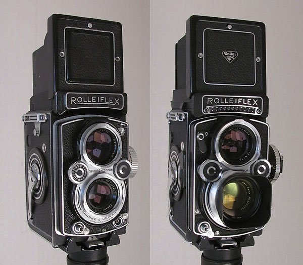

Most post-war Rolleiflexes can use the Rolleifix quick release.

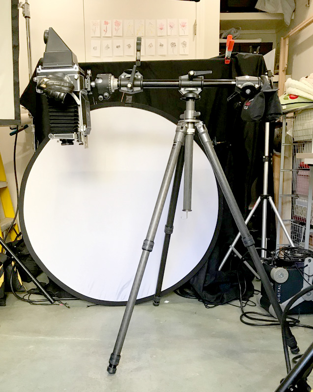

I mostly use ball heads from Leofoto and RRS. Buy the largest model. A good ball head will have a friction knob that can be adjusted so the camera moves with little effort but does not flop around. Be prepared to spend $400 or so for a RRS ball head, one of the best.
I will add that it really depends on the situation. For studio and architectural work (or at least where I want precise control) I will use something like an Arca Swiss P0 geared ball head. If the camera is suspended above a still-life set-up, I might use a 3-way locking geared head like a Manfrotto 410 or Leofoto GW-01.
As an alternative, try a two way. I love the Leofoto VH-30
More compact than a lot of 3-way. Since you have a rotating back you won’t miss the 3rd axis. Fine, smooth movements. Well made and reasonably priced.

Now let's see you carry that over your shoulder with one hand, while using an ice axe in the other hand. I needed both hands free the many many times I carried a Sinar and Gitzo up into the mountains. Studios don't count, although that big reflector in the background might be convertible into a hang-glider or parachute for going back down.
But just for fun in the mountains, you might want to switch to a 5X7 Technika instead of a 4X5 - better cardio exercise.
