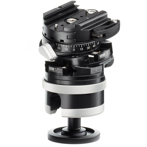

Super8
The Arca Swiss P0 is a unique combination of ball head and geared head. Expensive, as all A-S equipment is, but well made an well thought out, giving the advantages of both systems.
