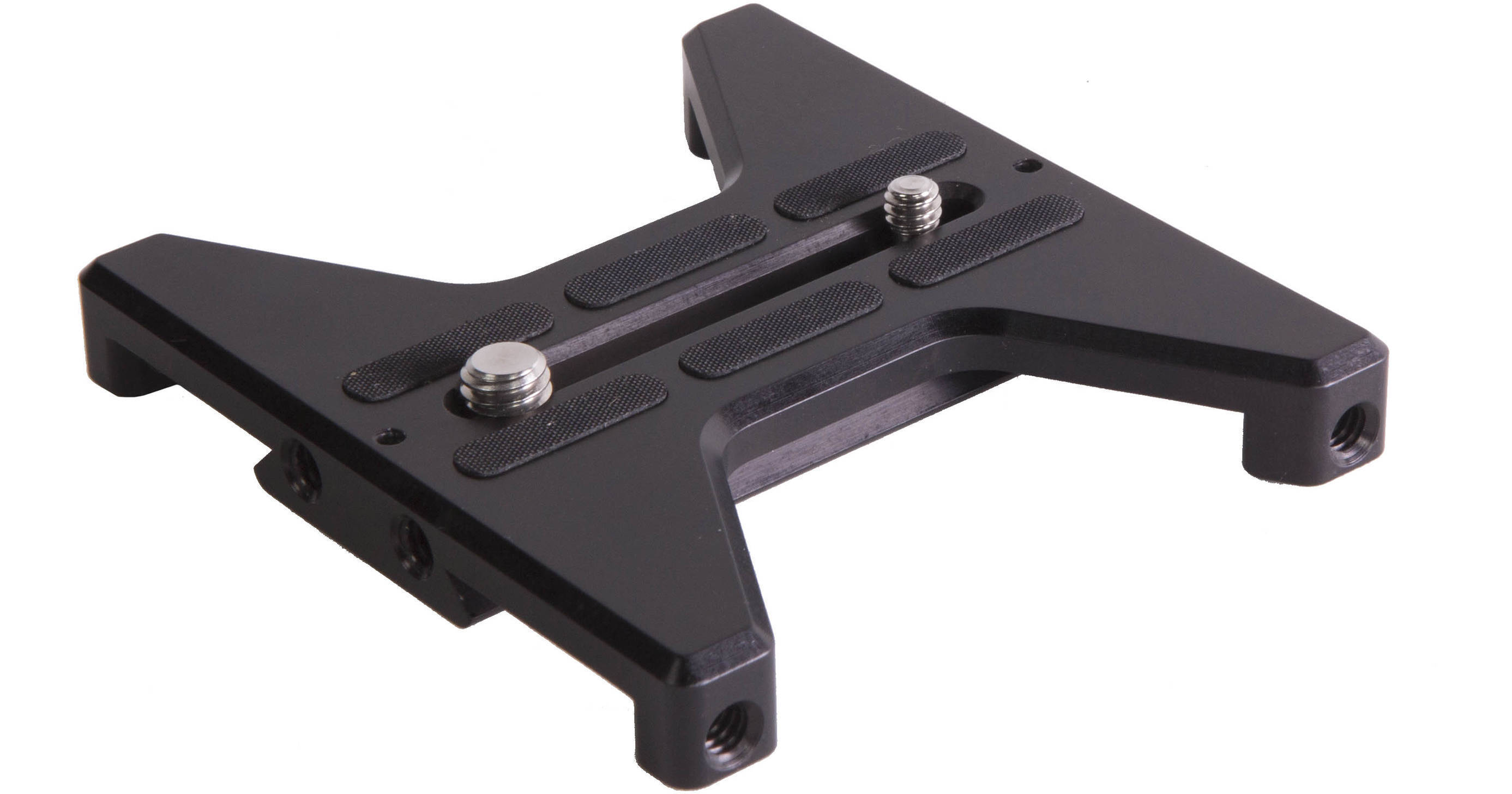

My Kessler Quick release allows me to move my Chamonix 4x5 forward and back to center the weight. I use a 3-1/2" two screw Arca type plate that allows the camera to slide to center it over the tripod. The two screws in the plate stops any camera slipping and turning. Kessler's QR is pricey but it holds solid.
https://www.bhphotovideo.com/c/product/1088274-REG/kessler_crane_mg1017_kwik_short_camera_plate.html
Another manufacturer had an ARCA type plate for my Mamiya RB67 that would have been great as it locks on and prevents cmaera from turning. Unfortunately, Kessler's QR doesn't match exactly so I had to use a standard Kessler short plate. THis is why I said that even though Arca described QR and plates should match, they often don't from one manufacturer to another.
