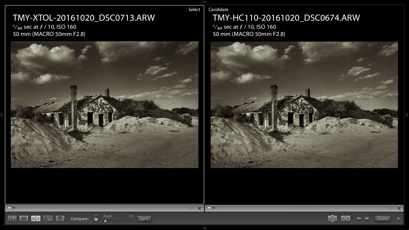

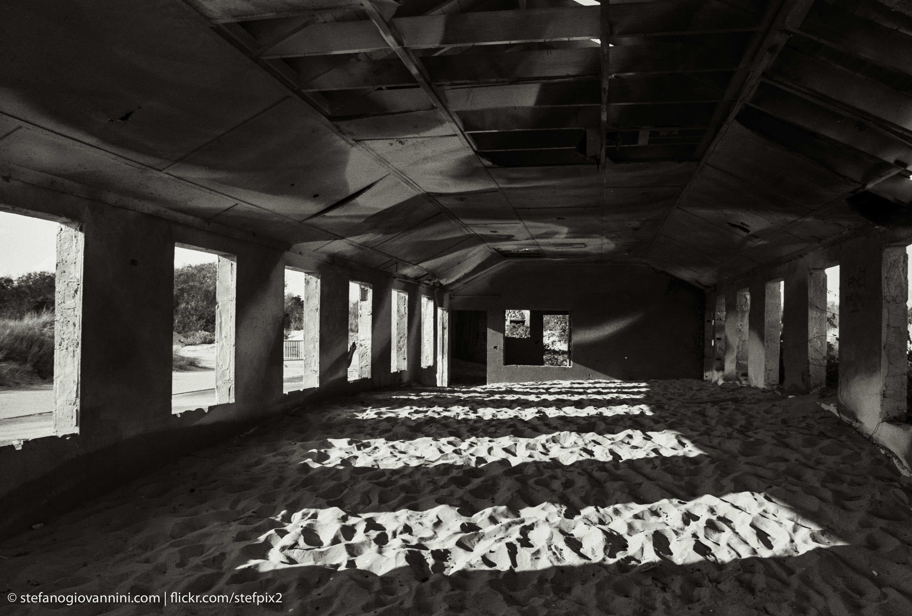

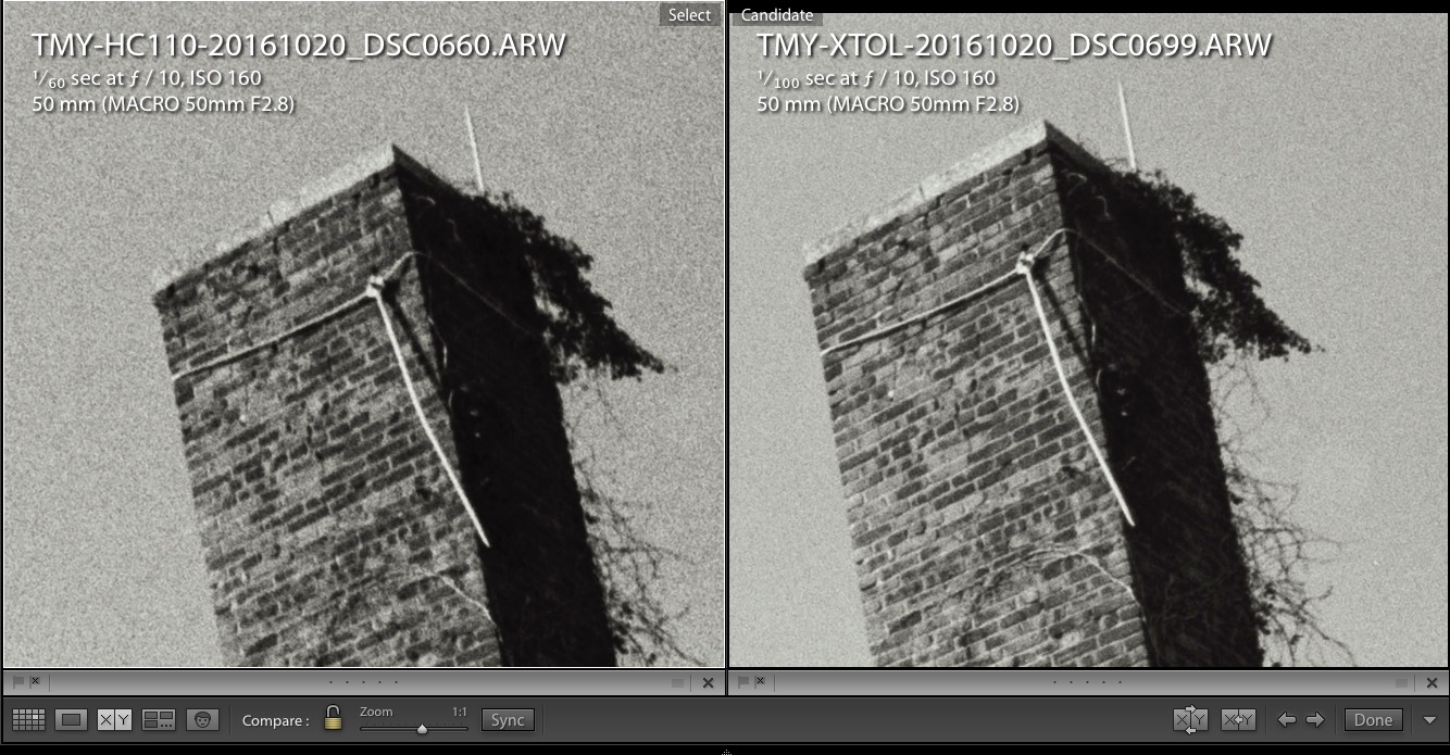

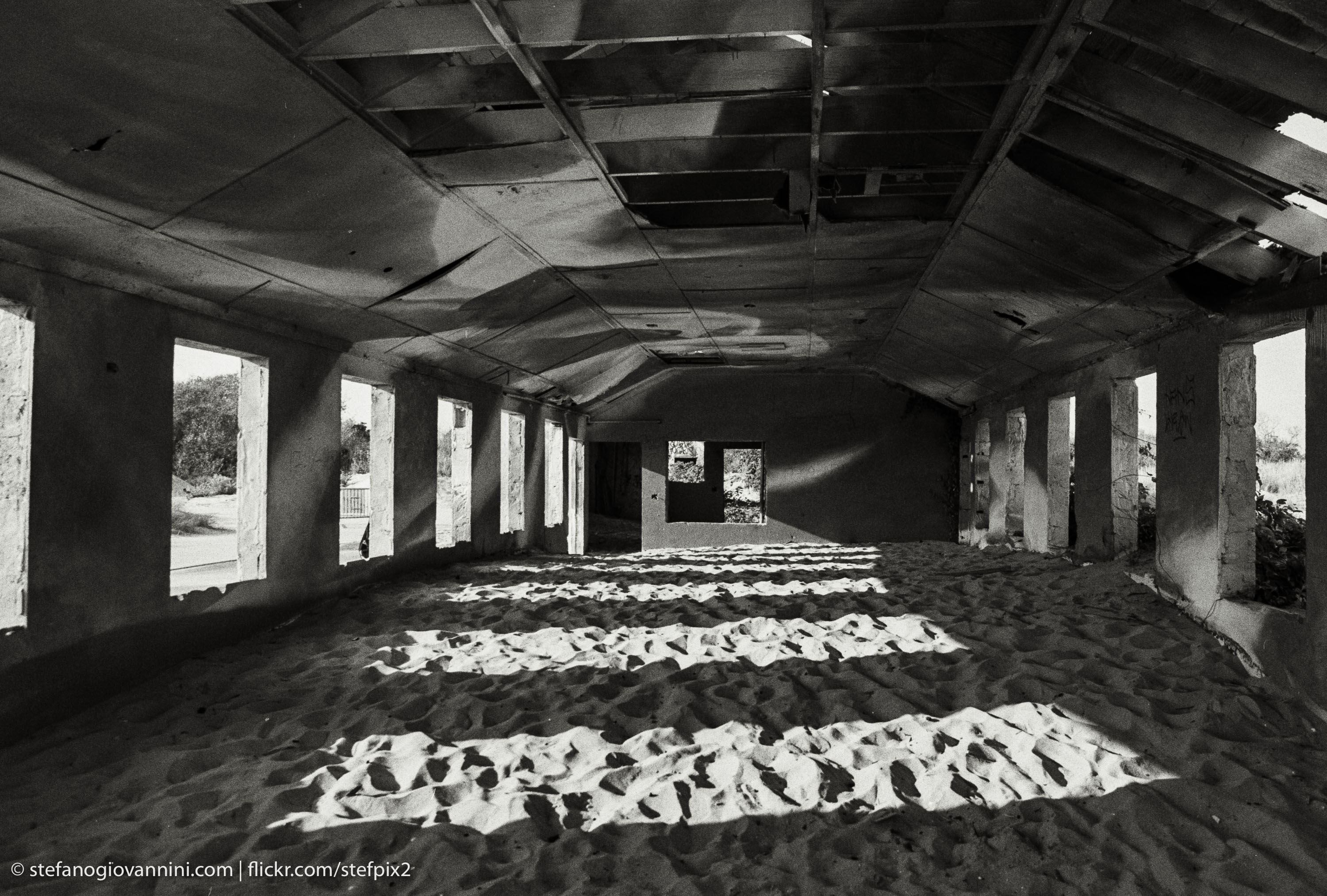

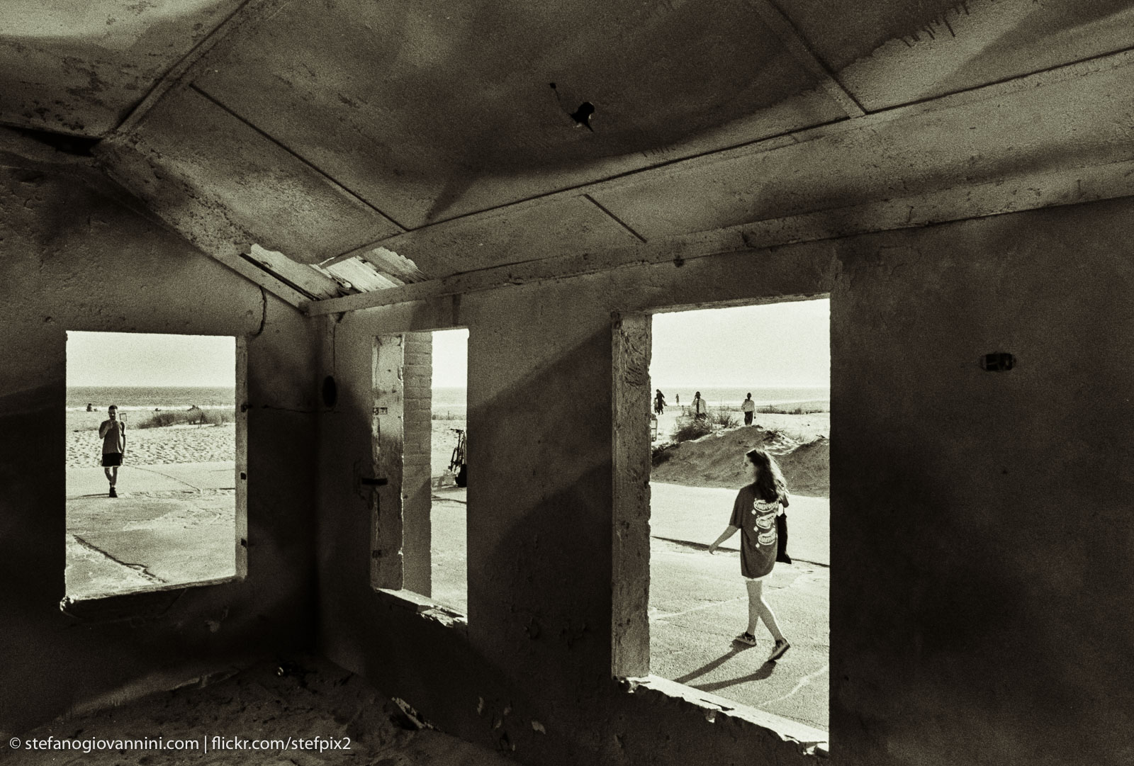

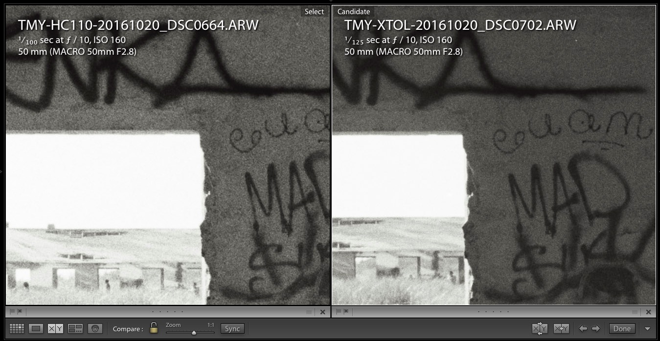

SO I uncorked the HC-110 and made a comparison.
2 Minolta Maxxum 5 SLRs, 24-85 mm (I have 2 of each), 2 rolls of TMY-2 Tmax exposed at 400. Some photos with yellow filter.
Shot the same photo with each camera handheld
developed
XTOL 1:1 21.5 C for 8' 45" (probably the developer was 20.5 C when I poured it in thePaterson plastic tank, but temp increased when I checked half way).
HC-110 dil E (1+47) 22.3 C for 8' 15"
Agitation every 30" (maybe skipped one halfway to check the temp).
Digitized the negs with Polaroid slide duplicator attached to 50mm macro lens and Sony A6000 (ISO 160 f 9.0)
and LED video light.
negs developed with XTOL were 1/3 of a stop lighter (HC110 negs got an average of 1/80 sec exposure, XTOL 1/60 for digitization)
here are some samples adjusted in LR. very basic (apart with barrack between the dunes that I used some burning and dodging, more or less teh same in both versions).

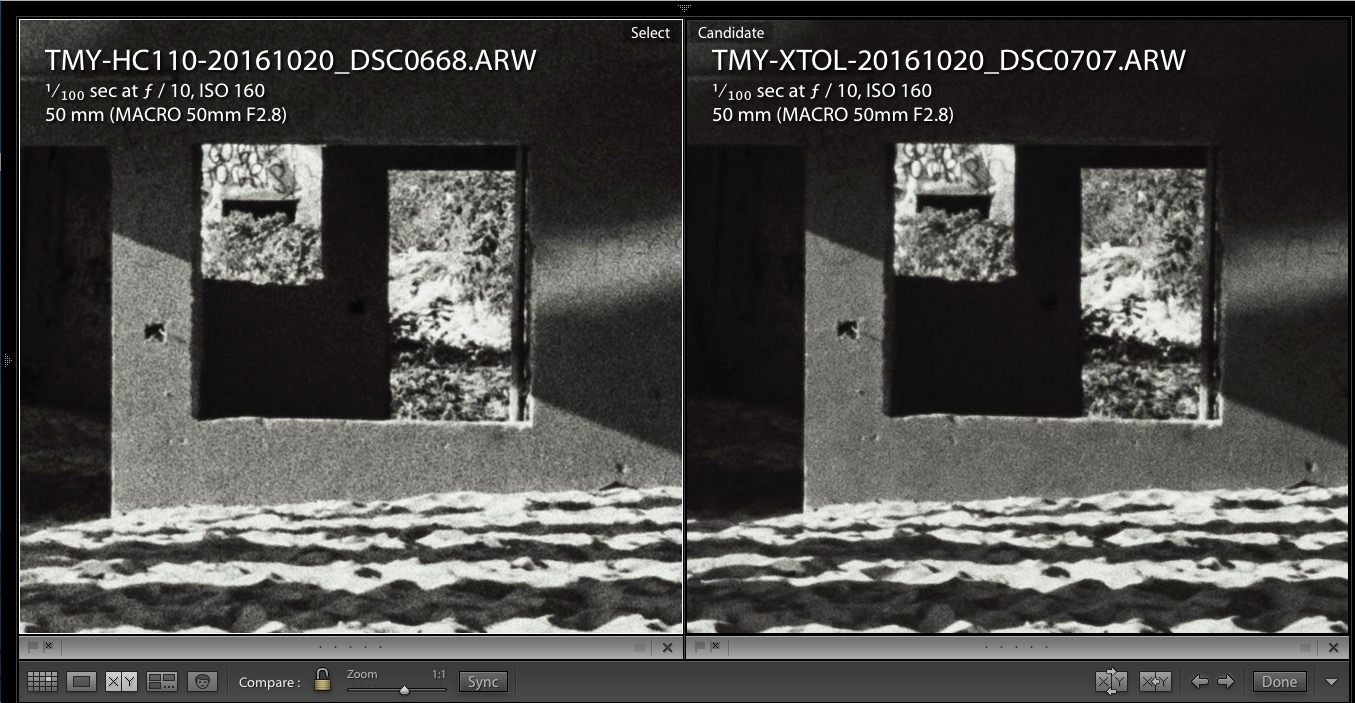

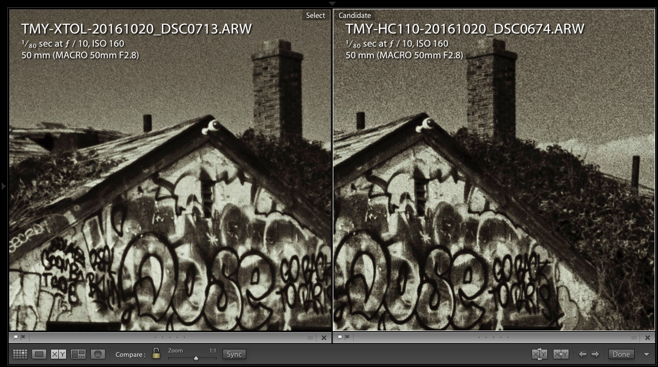

My observation: HC 110 negs are grainier but they look sharper. with XTOL the sky is smoother and less grainy, but hard to get deeper blacks (some graffiti tags look punchier / darker with HC110 neg).
Do not see a lot of difference in highlights / shadows detail.
Best would be something in between.
I feel HC-110 may produce more pleasing negs out of the box, while XTOL negs are a little easier to manipulate with gradients / burning and dodging, with a smoother transition.
Maybe I could have developed the XTOL negs for 45 seconds more and got a little more punch. I like the environmental qualities of it, and once mixed it is faster to dilute 1+1 rather than diluting HC-110 12.5 ml for about 600ml of water.
One thing I noticed in the Kodak datasheet there must me an error as TMX 100 ISO times are longer than 200 ISO push processing (I think for XTOL) also Kodak does not make it very clear to distinguish between new and old TMax that have very different times.
XTOL above
HC110 above
comparison at 100%
comparison
XTOL above, HC110 below

I prefer the Xtol results, if you look at the chimney closeup, it looks sharper on the Xtol side to me. The fine detail of the leaves and branches is more apparent while some disappears entirely on the HC-110 side.

Yes probably XTOL is slightly better in some shots, but yet I feel with the graffiti details HC-110 is sharper.

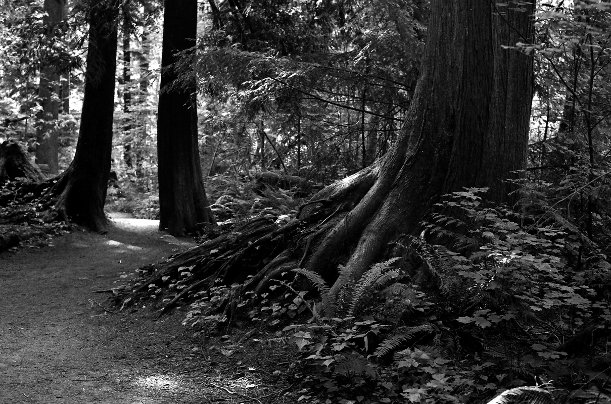

FWIW, from my relatively small stock of scanned images, this is 35mm TMY-2 developed in HC-110 dil E (replenished):

Matt,
That forest scene looks excellent as to the tonal range for the lighting in that shot, but I bet a shot taken on the same roll at a marina with a lot of white boats in it would be a whole different ballgame. That's the problem with roll film over sheet film. Of course you focused on the lower values in the forest scene when metering and for a very brightly lite marina scene you'd cater to the higher values and let the shadows go a little. Either way metering is very important and auto-cameras don't always work well in either extreme. I'm fond of Xtol-R myself, but no matter what you use, the procedure up to the point of development has a bearing on helping your developer look like it's doing good too. Stefano's shots are all very good in my book.

Matt,
John:
Now you've got me looking for my marina shots :laugh:.
I agree that you need to make your exposure choices based on the film, the developer and the light/subject, but you also have to keep in mind your final destination - which in my case is usually a print. For those relatively rare situations where I'm looking for a digital result, I'm usually trying to adapt something that was originally intended to result in a print. The combination of my relatively low level scanning equipment, my relatively low level of scanning knowledge and experience, and my low level of enthusiasm for the process usually results in something that I have a low amount of satisfaction with.
