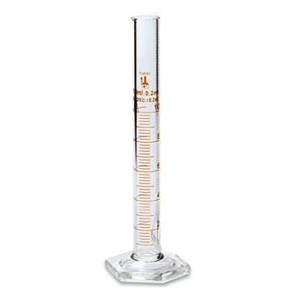

Get a Paterson 45ml measuring graduate (or something similar). Put in something like 30ml of water. Slowly add 6ml of the syrup, until the volume reaches 36ml. Careful observation of the meniscus of the liquid in relation to the markings on the graduate will yield sufficient accuracy.
Dump the result into a larger graduate. Rinse the 45ml graduate into the larger graduate a couple of times, until you are sure that you have rinsed out all the syrup. Then add enough water to bring the total volume to 300 ml. You will then have 300ml of 1+49 dilution HC-110.
If you use the same small graduate and technique each time, you will get consistent results.

I've tried both, and the small graduate works better for me.

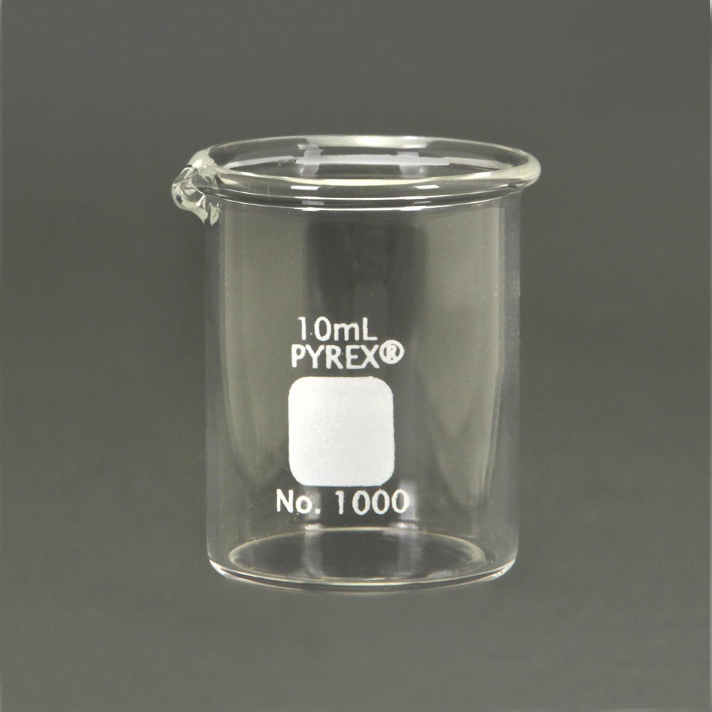

I have a tiny 50 ml beaker that I pour the HC-110 into and draw from that. Problem solved.

How hard is it to get a 50 ml beaker? I have one and pour an approximate amount of HC-110 into that. Using a syringe in that way is trivial.
Ratty, I agree that a syringe isn't very hard to use but I do find it easier to pour directly into something like this directly from the bottle.
Rather than something like this plus a syringe.
