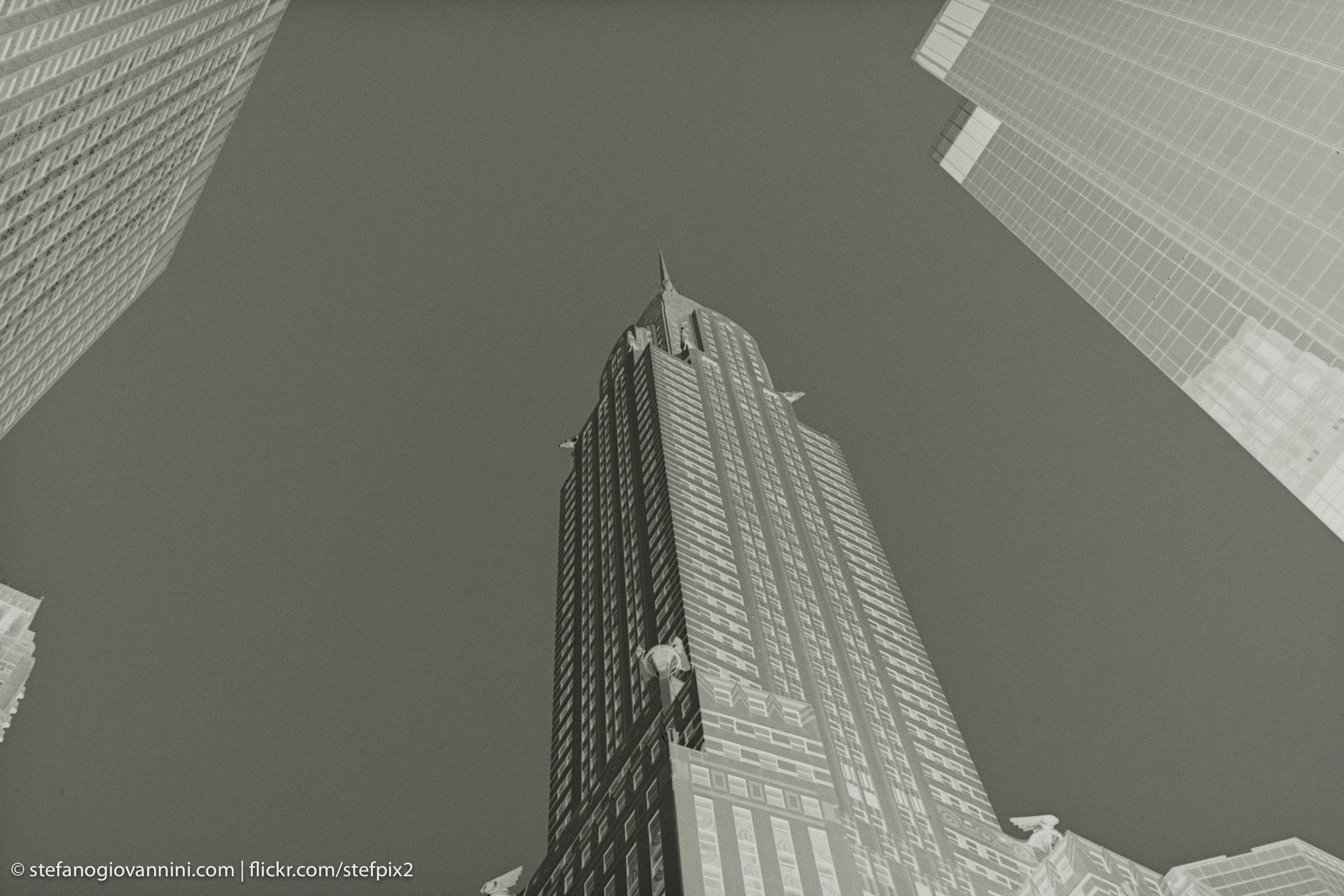

after 10+ years of digital photography and pressing deadlines I bought some analog 35mm cameras (Minolta Maxxum 5 and 70, Nikonos II / III and looking for a P&S).
Doing my own film processing with Paterson tank. I used to use TX and HC-110 in the late 1990s, but after trying TX and getting grainy results I think I will go with T Max 400. I purchased XTOL, I liked the price, the 1+1 single use, environmental concerns.
I always thought turning a digital photo in BW was a bit like cheating, now I turn BW negs into digital photos instead with a repro stand / light box.
I am including some samples of recent photos on TX and TMY-2. and also the negative repro as imported in Lightroom.
I bought a bottle of HC-110 that is still unopened. I have 1.5 l of XTOL still to finish. I am conflicted whether opening it (will not be able to return it) if the results would not be to my liking.

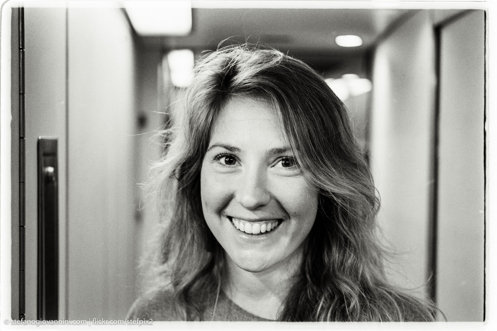

I would like some deeper blacks keeping skin tones a bit light.
Any advice (the portrait of the young woman smiling were in subdued light and probably 1 stop underexposed).

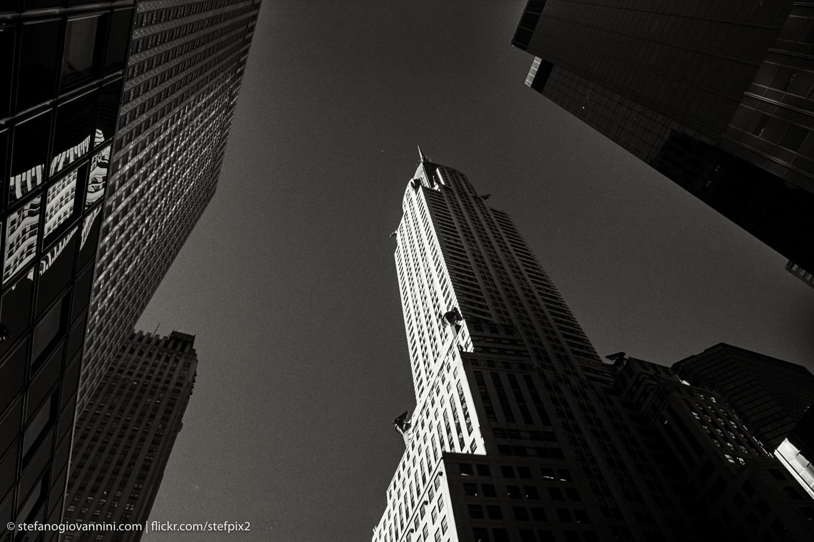

There is a photo of the Chrysler building, one shot with TX and other with TMY.
I processed TMY and TX together in XTOL 1:1 as according to Massive dev chart it is 9' 15" and 9' develop time at 20 C / 68 F (probably developed at 22 C and adjusted the time according to the chart)

I included some photos of TMY-2 and TX in XTOL. I wonder if with HC-110 I would get deeper blacks. DO you think I need to develop longer? I included some samples, and a reproduction of the negative without any adjustments.
TMY-2 is gorgeous in Xtol 1+1.

If you are viewing the results on a computer screen, the qualities of your highlights and shadows will be as much or more to do with how you convert the results to digital form as they will have to do with the film and developer combination.

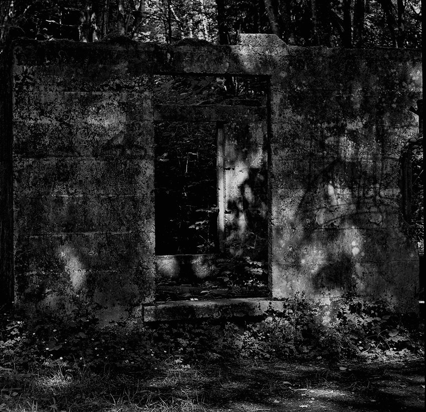

This photograph prints really well in the darkroom. Just as Andrew's photographs print really well when he uses the alternative processes he favours.
Deeper blacks are a function of contrast, not of what developer you use, and contrast is usually adjusted in post (i.e., darkroom printing, or scanning). The job of the negative is to record all the tonal values of the scene properly, and it looks like your negatives are properly exposed and doing very well. Using HC-110 instead of XTOL may give you a bit more contrasty negative, but you're better off adjusting the contrast as you're printing or scanning. Keep in mind Ansel Adams' saying that the negative is the score, and the print (or scan) is the performance. Keep your "score" the same and just play with the "performance."

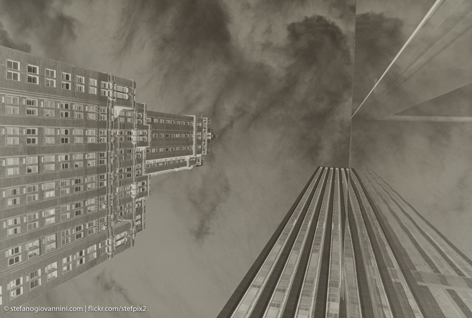

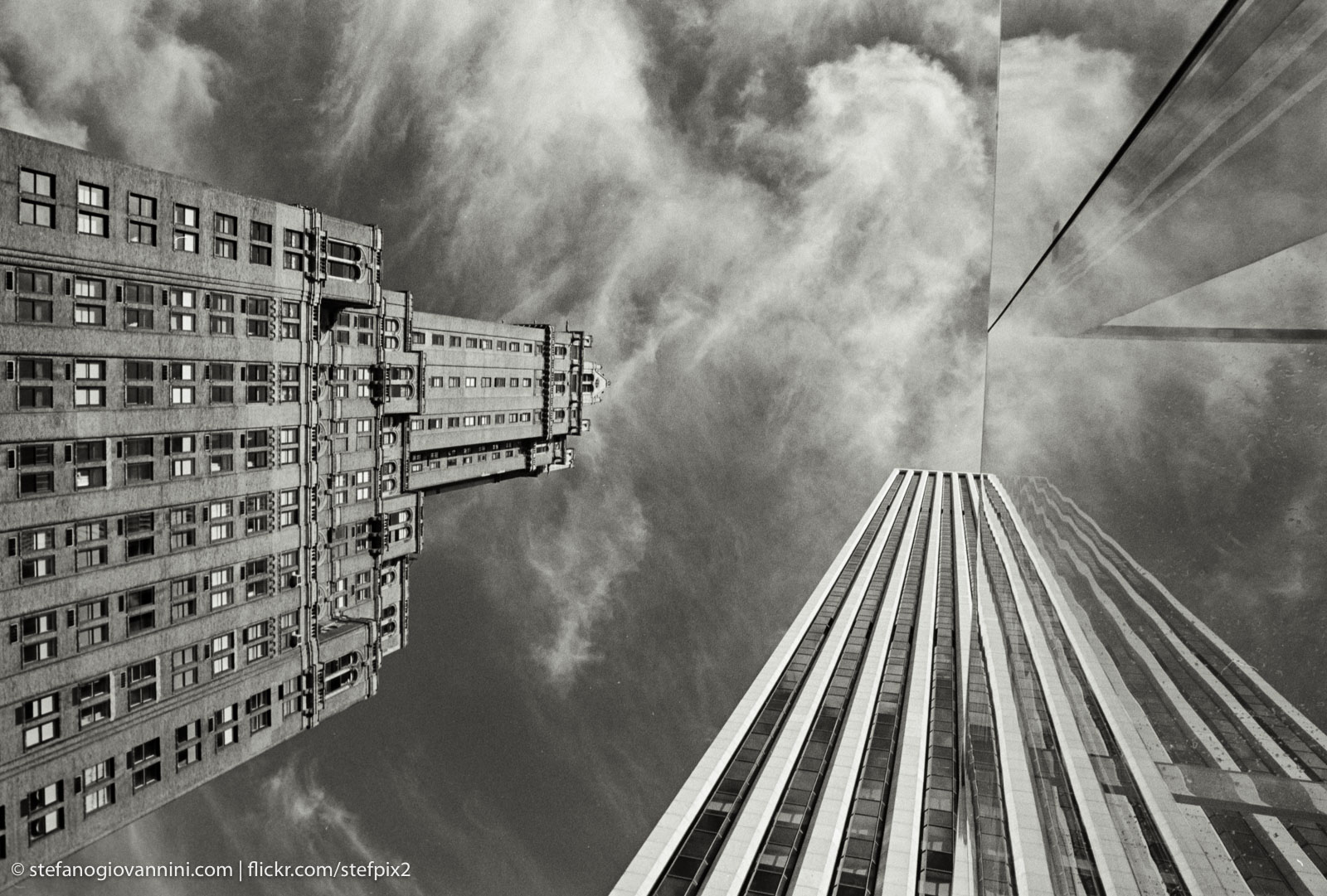

I photograph my negs with a macro lens on a Sony mirrorless and invert the curve in Lightroom ( i made a S shaped curve as linear is too flat)
the sliders become inverted and small adjustments change the aspect a lot.
I am considering after inverting and adjusting basic exposure exporting as a hi res JPG and make fine adjustments there.

here are adjusted images and how they look just with an inverted curve and as a negative

It seems that XTOL keeps a lot of detail in the highlights (skyscraper shots, where one side was in direct sun and reflective).
The highlight detail that gets caught on the film isn't greatly affected by the developer choice, there is more difference at the shadow end but, if a shot received enough camera exposure that isn't an issue either.
