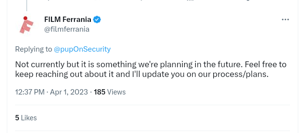

When asked bout P30 in bulk, this is what they said:

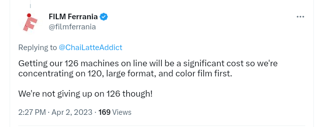

They were also asked about 126 film, this was their reply:

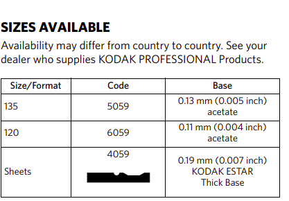

Ok, thank you. How about 35mm cine film, which I find to be quite a bit thinner than still film?
Don't know about the b&w stuff, but 35mm Vision3 isn't any thinner than e.g. Portra AFAIK. In fact, it seems slightly thicker with the remjet still on.
Hmm. I just checked some of my processed film and Portra feels thinner than HP5. I don't have any Vision2 or 3 handy.
Ilford HP5+ datasheet: "HP5 Plus 35mm film is coated on 0.125mm/5-mil acetate base"
Portra 160 datasheet:
The Eastman Kodak motion picture film datasheets don't seem to list details about substrate thickness.
