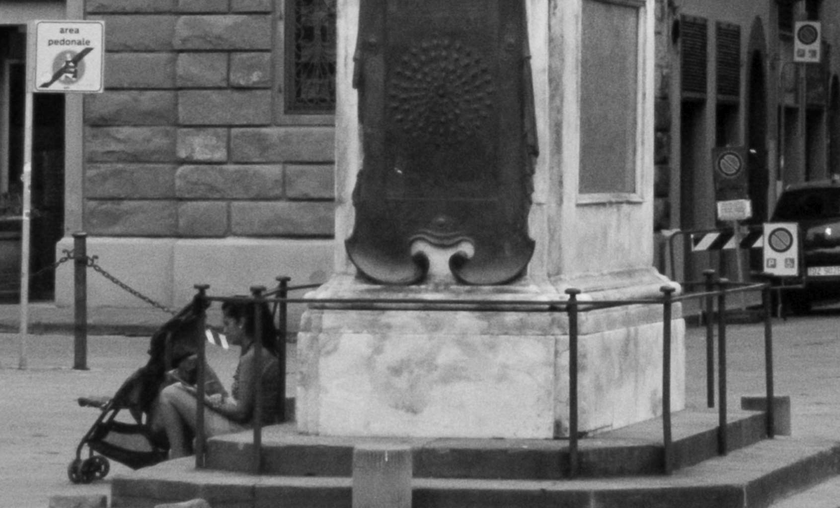

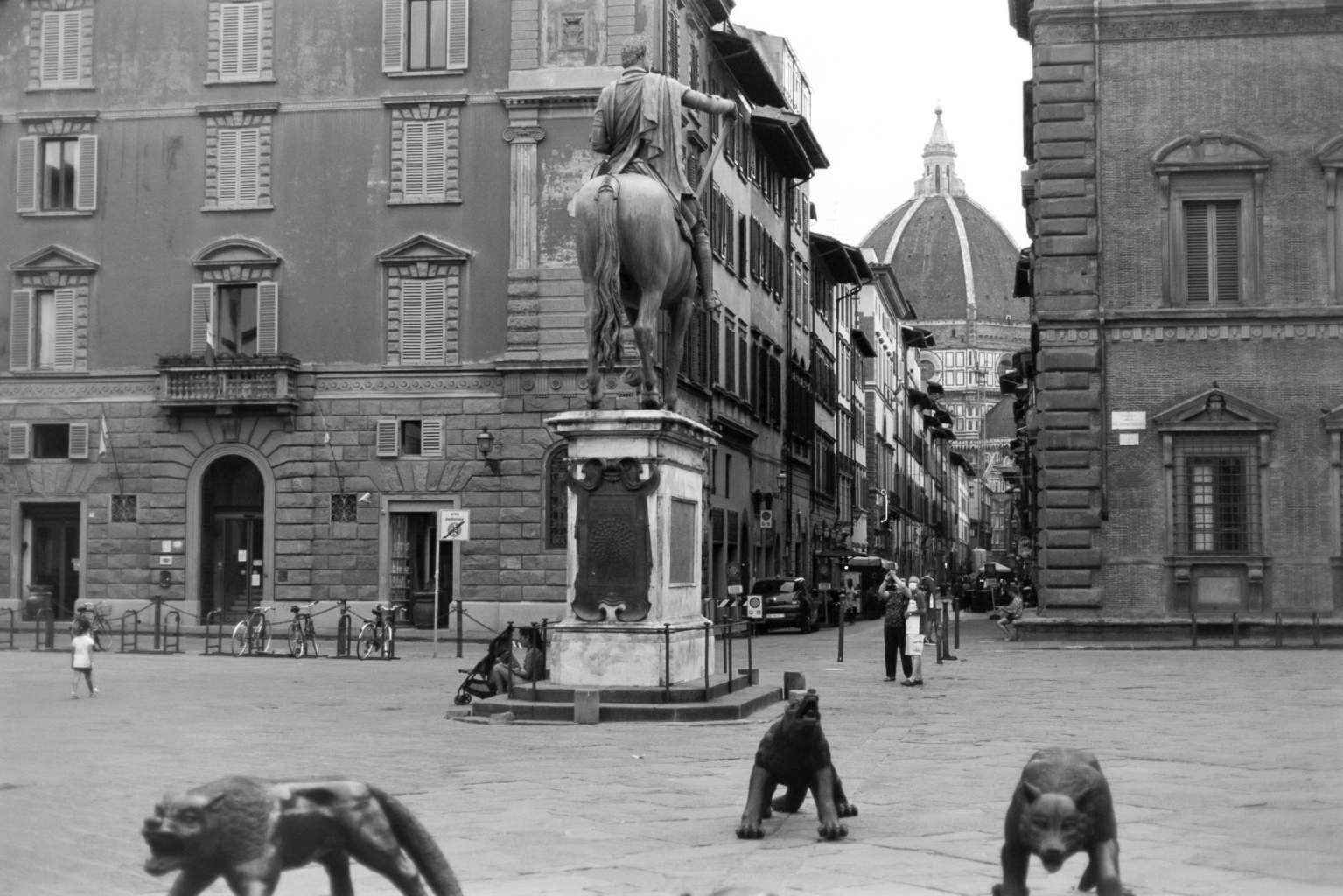

Here is a scene from Firenze, almost too late in the day for hand held exposure. Wide open, or almost, at E.I. 80, developed in D96 (home brew). It is a digitised negative, I don't have a print of that one. At least not a digitised one. The building on the left is orange-red. The bricks on the right are more brown-red, maybe with dirty yellowish ones in there as well. I found the scene on Google maps to compare. The roof of the cupola is reddish, as well (Duomo of Firenze). The wolfs, from a Chinese artist, have a red-brown, glossy patina.
In the detail picture you can see signs to the left and right of the monument. The round bit in the left one is blue and the diagonal strike through is red and rendered very dark. The no parking sign should be blue inside with a red ring around, which is what they generally are like in Europe. Again the red here is very dark. Perhaps the film simply cuts off earlier in the reds than other pancro films but not quite as extreme as an ortho film.
