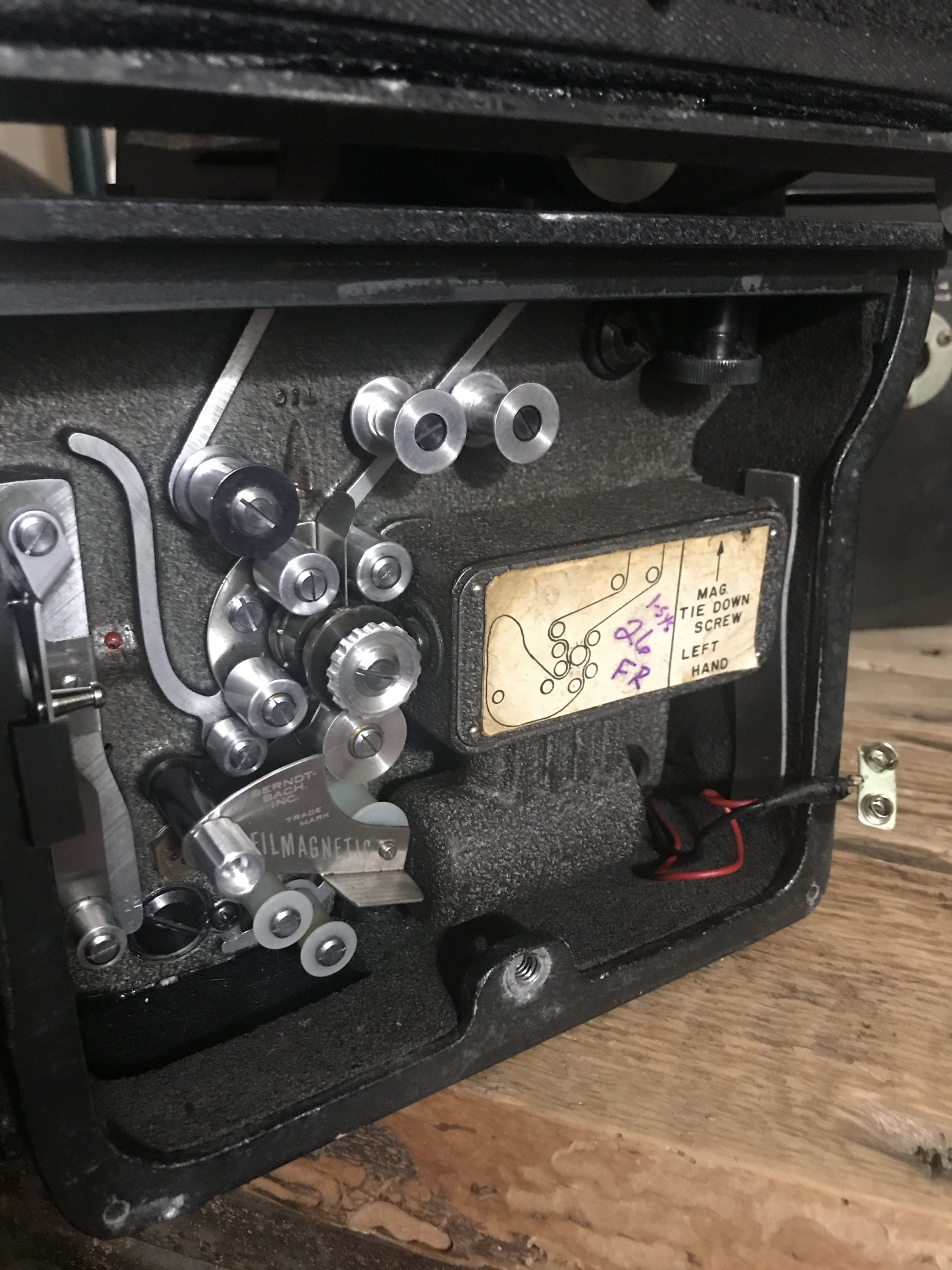

I also just bought an Auricon and some seperate accessories (hopefully they’re the right ones). I think it’s a chop top - maybe by general camera Corp. I have 2 seized magazines and I’ll try the penetrating oil tomorrow. I bought some random cords and the camera seems to run on AC power - not sure if it is to speed. Does anyone know why there would be a 9V battery connector inside the camera body near the galvanometer? The lamp is 7V. I also bought the NR-40-S7 that I need to figure out how to power. Will this amp work with the CM-72 or CM-72A? I don’t know which one I have. I could send more pictures...
Is that 9V blockbattety connector not too modern to be original for this camera?
There are 7,2V reloadable blockbatteries of samec size and connector.
