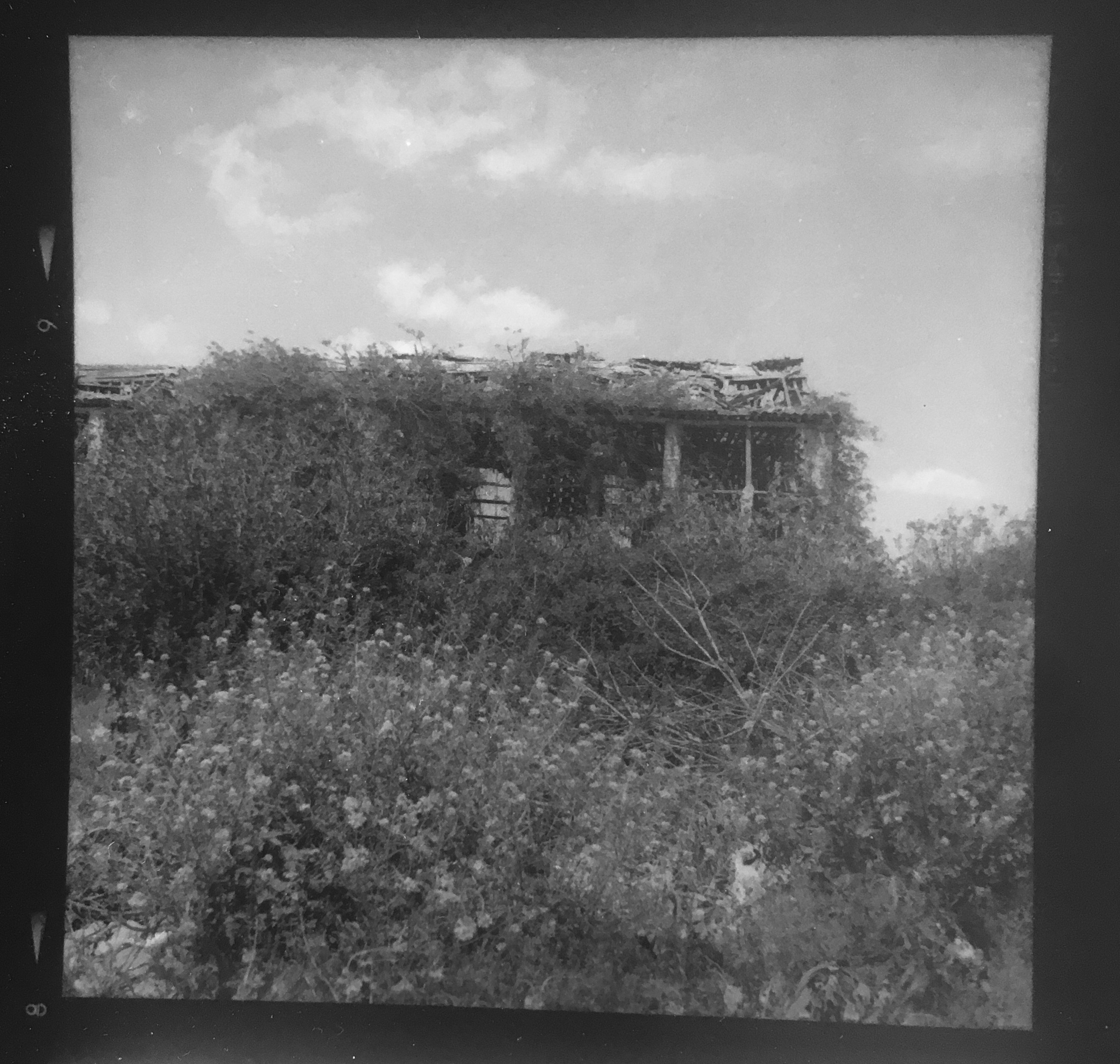

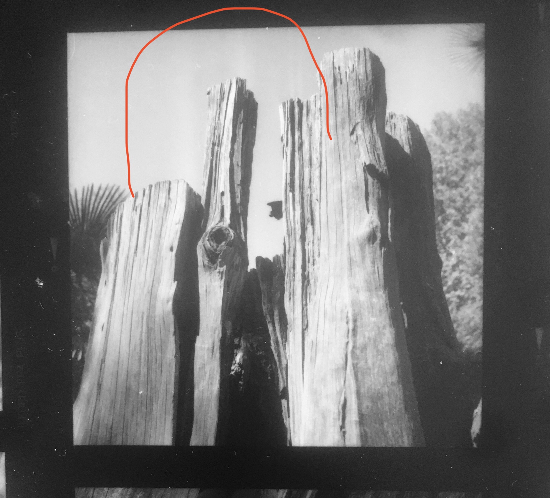

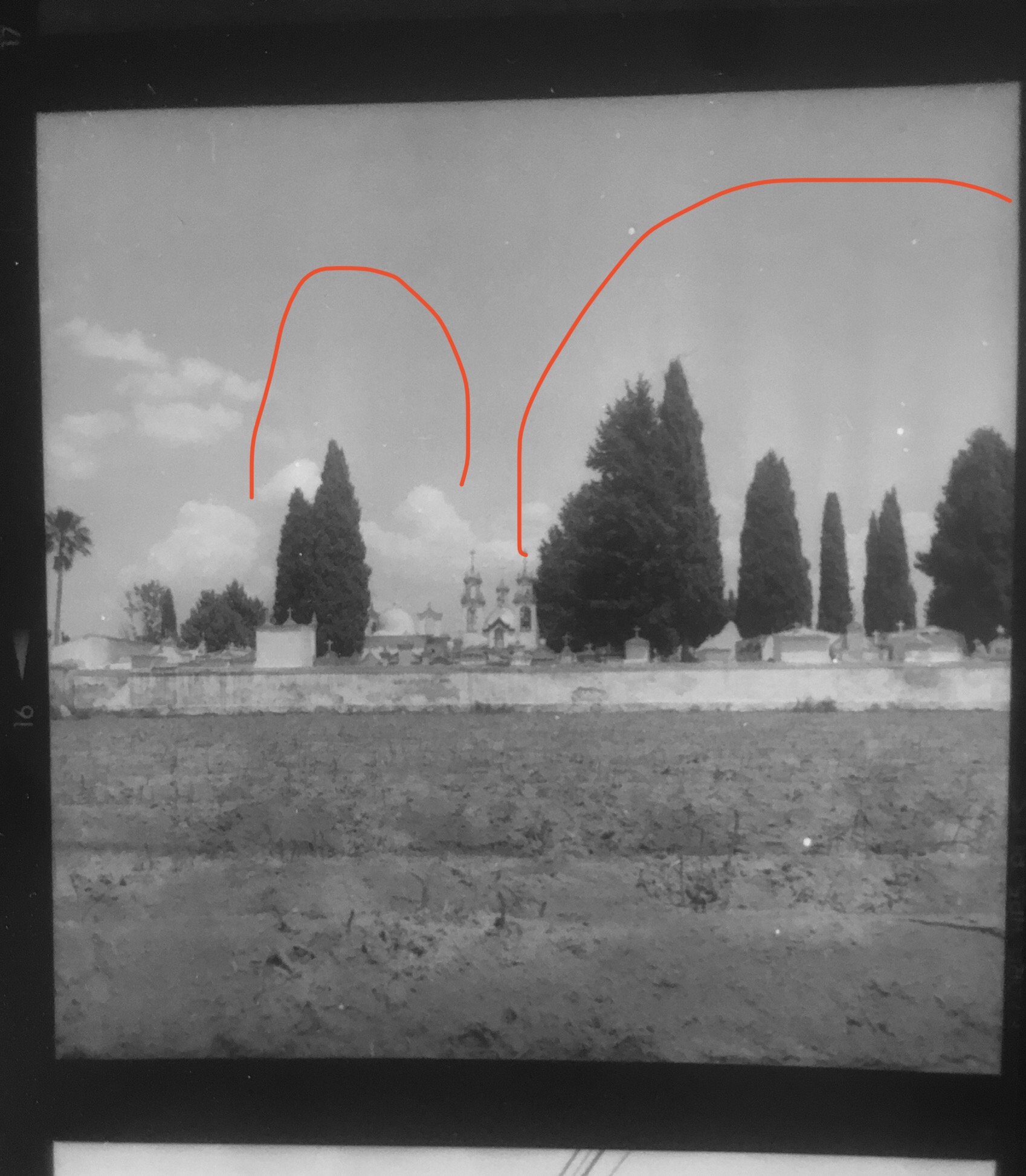

Hello all, I have recently been experiencing some uneven development in the form of streaking which seems to bleed from lower density areas into the higher density ones.
Is this a consequence of bromide drag?
Nothing has changed in my processing regime (including chemicals - DDX/Water stop/Rapid fix).
I have always used a manual rotary tank with consistent results.
Any thoughts, help or advice would be much appreciated.
I have attached examples from two contact sheets.

The streaking seems to be happening when there is a pointed subject (eg: a tree) against an area of high density. In this case the sky.

Actually, I just realised that you are showing us the positives. The drag marks are lighter. Bromide drag marks should be darker in the positive (clear in the negative). Maybe the marks are due to excessive agitation, in one direction. When I do constant agitation, it is when I use BTZS tubes. The tubes spin in the water bath, but the bobble, making the developer flow kind of randomly. In your case, it would be similar to using a swivel stick in a Paterson tank. Can you agitate more gently/slowly?

Here is a frame (again with sky) from the same HP5 contact sheet which does not exhibit the same problem. It seems that the streaking always emanates from a pointed (for want of a better word) object of lower density.

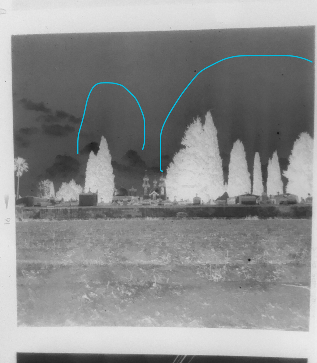

To aid in discussion - copies from the scan posted by the OP, then inverted and re-sized for uploading. For what it is worth, this is the best way to display this sort of problem:
Noted. Thank you.
I could take photos of the negs on a light table should it be of more help.
