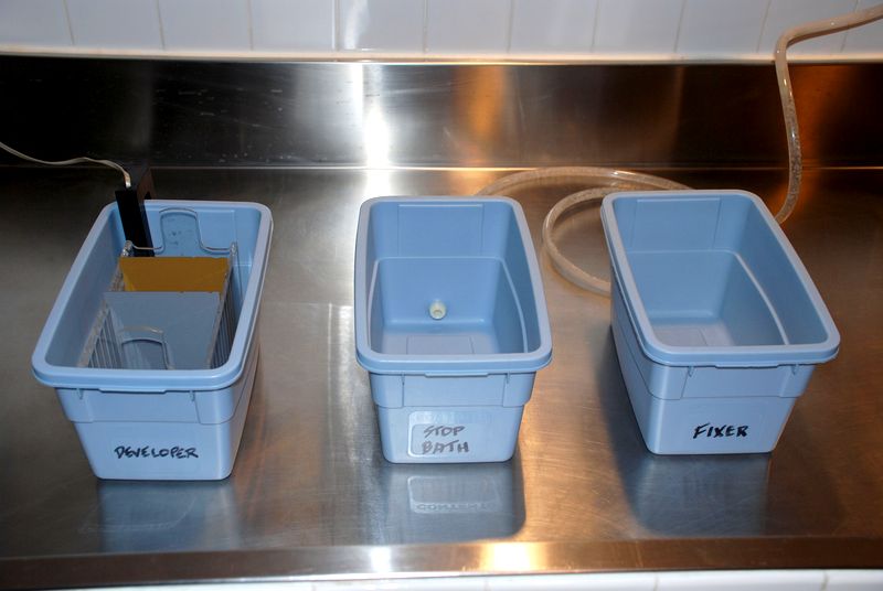

As I recommended above, get a stainless Nikkor reel and lift rod and process the film in an open tank and see what happens. I agitate by lifting the reel with the rod and rotating it in the direction of the wind at the same time (so the film doesn't come off the reel).
You don't have to buy a fancy open tank. Any 1-2 litre plastic container will do, if you are willing to work in the dark. During development. I use three such containers:
1. Developer
2. Running water "stop bath"
3. Fixer
I develop and "stop" in the dark, put the film in fixer, and then lights on.
Here is one such configuration (I have several different ones depending on film format):

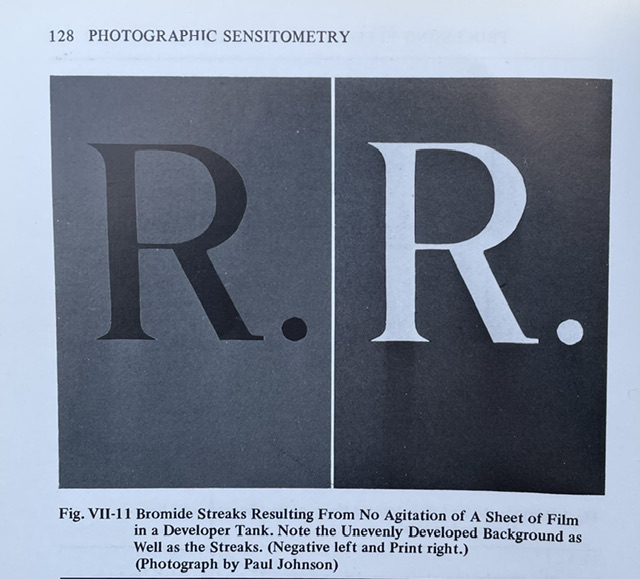

So George, you can get bromide drag with continuous agitation and if the streaks are bromide drag then is Andrew O'Neill point nonsense His point was this "Actually, I just realised that you are showing us the positives. The drag marks are lighter. Bromide drag marks should be darker in the positive (clear in the negative).
pentaxuser
@Andrew O'Neill is right about Bromide Drag. This case is the flow of fresh developer into an adjacent area accelerating development.
Bromide slows development, as is well known based on how many comments in this thread point out.
The classic reason is no agitation (stand) and a textbook example is white billboard type on a gray background. The gray background would print with dark streaks.
