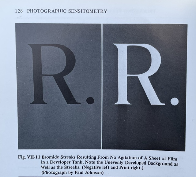

@Andrew O'Neill is right about Bromide Drag. This case is the flow of fresh developer into an adjacent area accelerating development.
Bromide slows development, as is well known based on how many comments in this thread point out.
The classic reason is no agitation (stand) and a textbook example is white billboard type on a gray background. The gray background would print with dark streaks.
The example here looks identical to what I am experiencing. Thank you for sharing. However this is a result of lack of or no agitation. So I am presuming that these artefacts are also possible with constant agitation. Correct?

Bromide, in a developer, is a restrainer. When film is developed the crystals of silver bromide are turned to metalic silver, releasing bromide into the developer. If there is no agitation the bromide laden developer from the highlight regions sinks - this developer has less activity both from extra bromide and from developer exhaustion. Chloride and iodide ions are also released in development and they also act as restrainers and add to the 'drag'. The effect is subtle and if you aren't looking for it you probably wouldn't notice it.
To get drag the film must be vertical in the tank and there must be no agitation.
Whatever is happening to the OP's film, it is not bromide drag.
