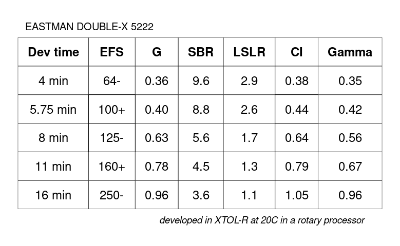

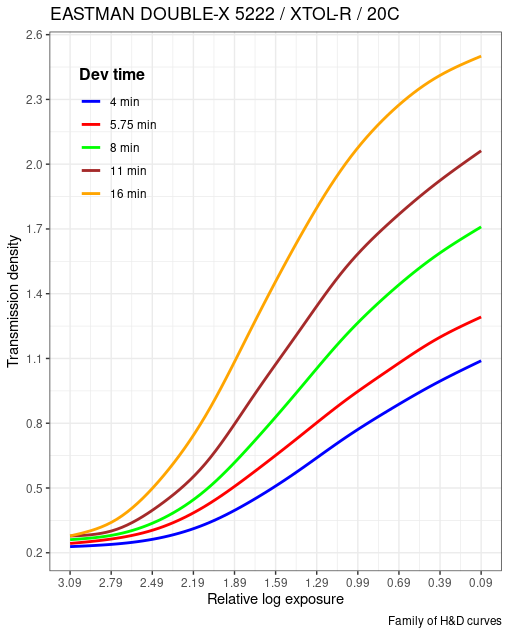

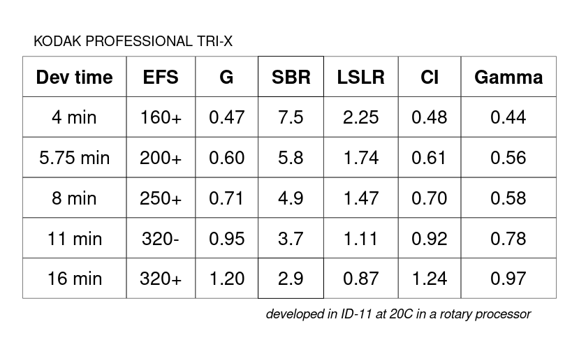

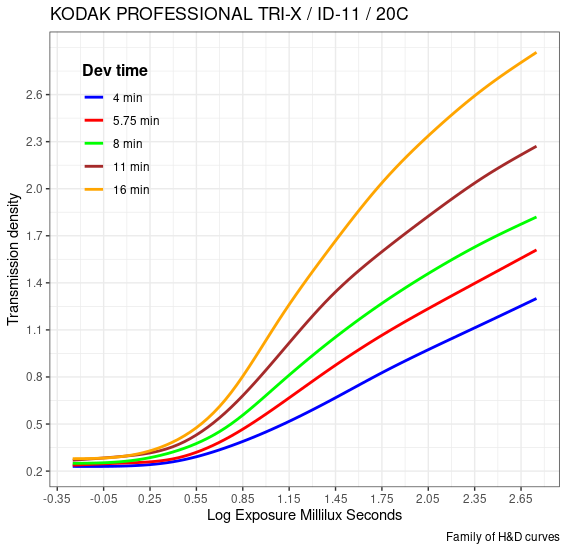

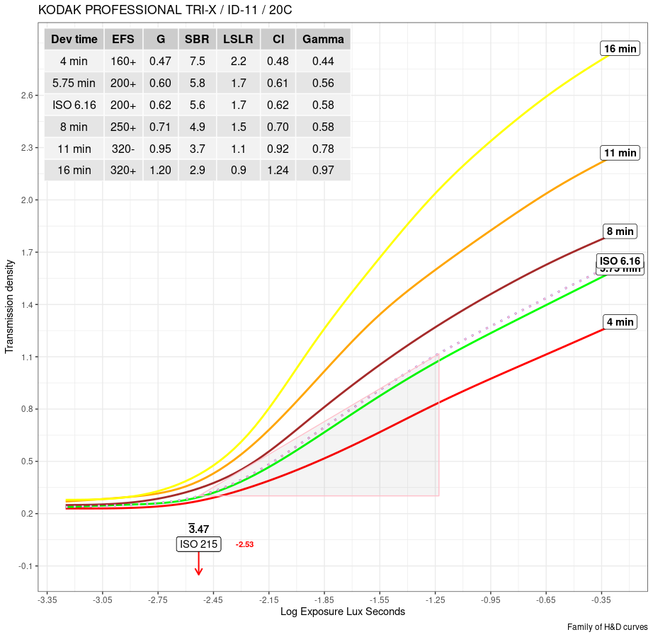

For those of you who would like to move on from your X, here are my results of KODAK PROFESSIONAL TRI-X (400TX) developed in ILFORD ID-11 (stock) at 20C in a rotary processor.
I have been working on an unrelated project and have the data available so I thought share it. By the way, in my previous test, I gave TRI-X the same amount of exposure as DOUBLE-X in order to help compare the two. This time, I gave it a bit less exposure so you can see how the toe transitions to the straight-line portion of the curve. Overall, the results are similar to XTOL-R, at least in this test. You lose a tiny bit of speed, and contrast tends to build up a bit faster than in XTOL-R, which could be important, esp. if you're interested in pushing the film.
I just found myself looking at this website with fascination, although I expect it has been flagged on Photrio before. Like many people on this forum, I have rung the changes of films and developers in the past, but I never had the drive to do systematic testing like @aparat or like this Norwegian website. Characteristic curves do show appreciable differences, but visually the differences between different developers on the same film are far more subtle than I thought.
Not surprisingly, negative characteristics are mainly driven by film characteristics and much lesser so by developer or development characteristics.

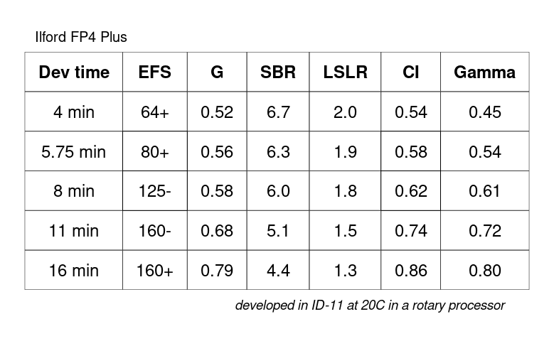

So, yeah, I get it. It's hard to move on from your X. But I want to make it easier for you to see the light and get out of Dodge (or whatever the cliché is). It's a toxic relationship. You need to put yourself first. It doesn’t mean completely quitting your X. It’s all a matter of priorities and understanding the interplay between taking care of yourself and your X. Having said that, total freedom is just a mouse click away. I am talking about switching to ILFORD.
You can start by ordering some ILFORD FP4 Plus and ID-11. This combination of film and developer will enable you to see yourself in a new light, full of new possibilities.
EASTMAN DOUBLE-X 5222 in XTOL-R:

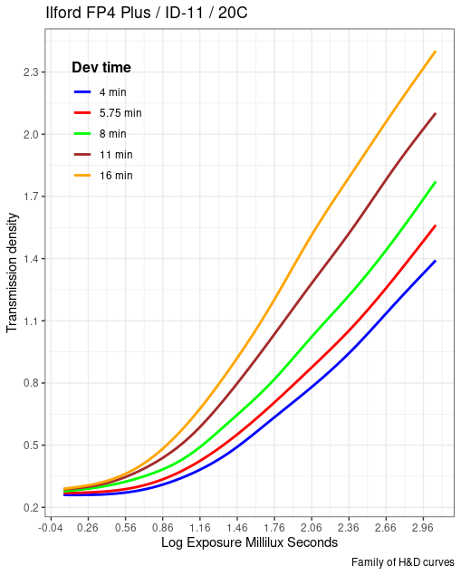

ILFORD FP4 Plus in ID-11:
As you can see, with ILFORD, you can still get some of the benefits of that old relationship, i.e., similar film speed and price (if you're willing to shop around), but you can have performance that's sufficiently different and, frankly, refreshing, that it will extinguish whatever feelings of guilt and remorse you may be struggling with after walking out on your X.
View attachment 324121View attachment 324122
View attachment 324123View attachment 324124
I realise you are having fun, but nevertheless explain something to me. Why are you suggesting that FP4's straight line response to log(exposure) is better? And actually, why compare it with Double-X in XTOL-R rather than your earlier curve of Double-X in XTOL stock? A straight line means clean separation of tones throughout the range, but you will have to compress that scale somewhere to squeeze it onto printing paper. Sure, you could develop to an overall lower contrast, but the result will be lifeless. Having a shoulder on the curve is arguably a good thing if it means highlight details are easily printed without sacrificing mid-tone separation.
In a recent Photrio poll I named FP4+ as the one film I couldn't live without. But recently I fell in love with Double-X too, so I'm feeling kinda defensive.
You said it. I am just having harmless fun. There's absolutely no reason for anyone to "switch to Ilford." I love the Double-X, and I love the FP4 Plus. Both fantastic films, and both XTOL and ID-11 are fantastic developers.

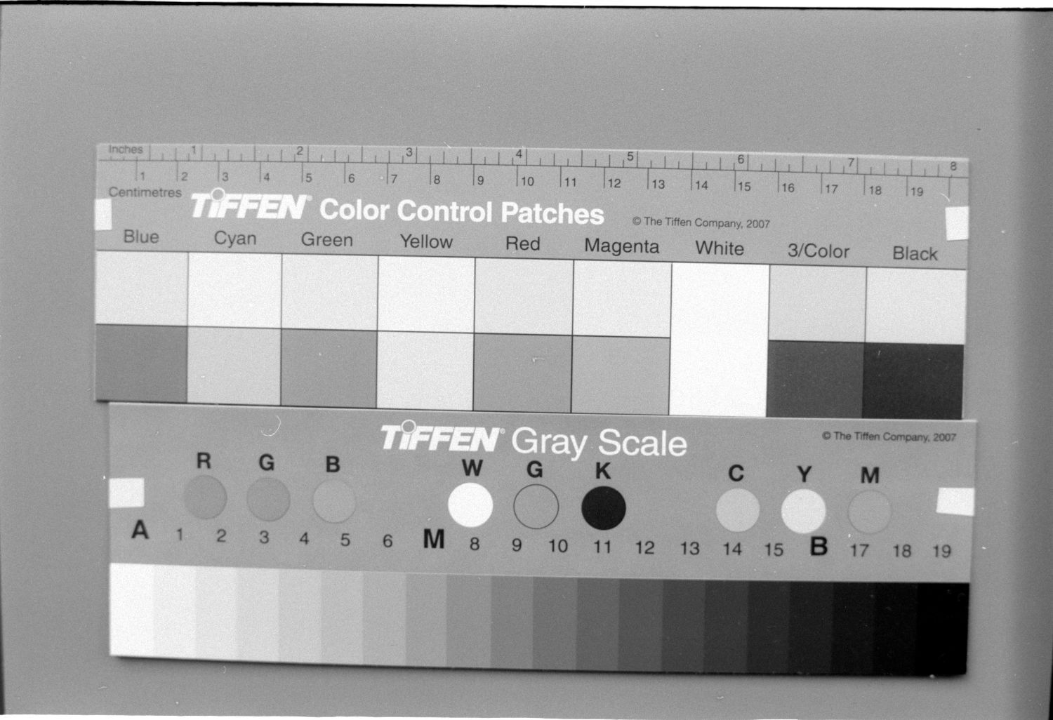

EASTMAN DOUBLE-X 5222 in XTOL-R color chart. I am sure you'll agree that it's a very nicely rendered tonality.

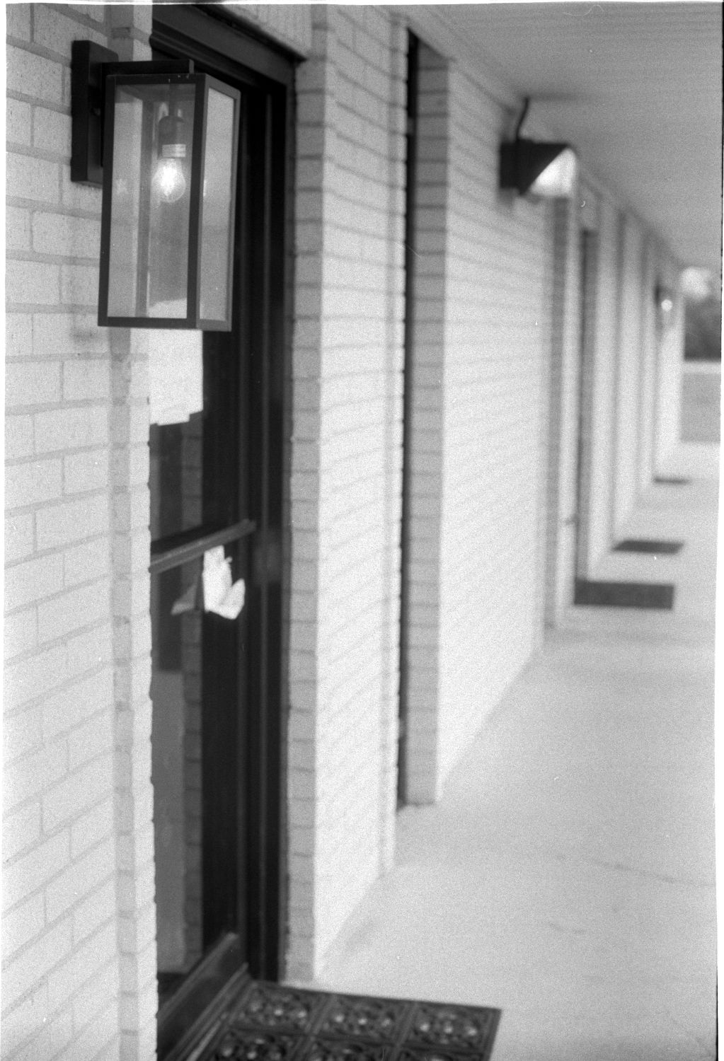

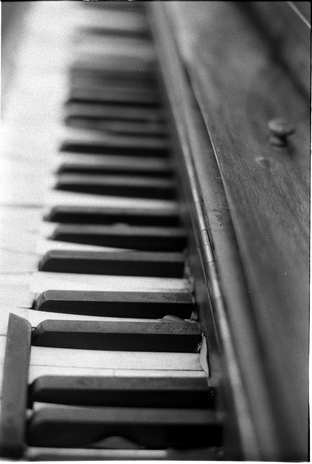

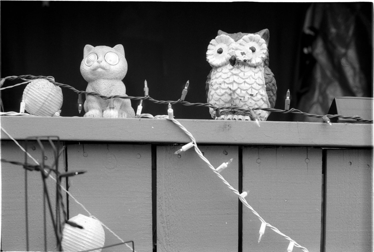

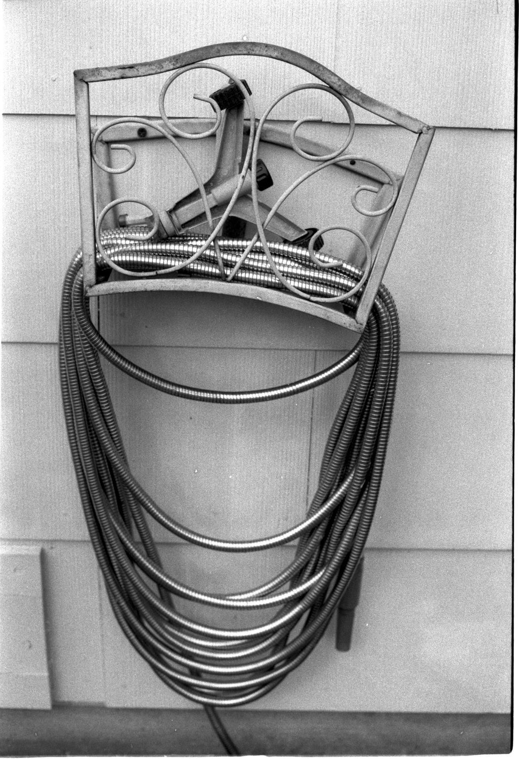

And some sample photographs. It was a dull, overcast day, so I exposed and developed the film at N+1 to give it a bit of extra contrast. These are Vuescan scans using default settings. Overall, I am really pleased with how XTOL-R handles this film. It gives it a very smooth, extended tonality, with ample shadow detail and nicely controlled grain. I would not hesitate to call this a classic kind of look, if that make any sense.
2022-12-14-0020.jpg2022-12-14-0017.jpg2022-12-14-0004.jpg2022-12-14-0015.jpg2022-12-14-0013.jpg2022-12-14-0011.jpg2022-12-14-0006.jpg
View attachment 324134View attachment 324135View attachment 324140View attachment 324136View attachment 324137View attachment 324138View attachment 324139
There is clearly tonal information throughout the scale, including the light bulb in the last shot, and the tonality of the fifth (coiled hose) shot is especially pleasing to the eye. The others - dare I say? please don't be offended! - are nice but have a kind of concrete-grey monotony, which I sometimes get with this film too.
Tinkering with your images in GIMP, I confirmed what I'm sure you already realise, that they can be given a distinct lift by slightly increasing brightness and contrast - but then of course in printing you would have to do some burning in to avoid blank highlights.
I wish someone could explain to me why the tonality of an image can sometimes be so eye-catchingly beautiful and sometimes dull as ditch-water. I used to think it was only a matter of sticking with one combination of film and paper and learning how to get the result I wanted, predictably. My own combo of choice was Ilford FP4+/HP5+ and Multigrade paper. But then I started to notice how different photos by other people on Double-X looked, and I wanted that too. It does give a different result. But what exactly is it exactly that is different?
I agree completely. These were meant to be "straight" scans from Vuescan's default settings. They are not really linear scans because Vuescan does some processing of its own, but they could certainly be improved upon in further post-processing or wet printing.
As far as determining what makes a beautiful print, there have been studies trying to answer that very question, going back to the seminal paper by Jones and Nelson (1942). Their conclusion, which has been subsequently confirmed by other studies and by thousands of darkroom master printers, was that "This situation might be interpreted to indicate that the reproduction of shadow detail is of greater importance than the reproduction of highlight detail, or that the reproduction of shadow detail is the requirement for good print quality." In other words, observers prefer prints with ample shadow detail and a decent amount of contrast. Nothing earth-shattering there from today's perspective, but, back in the 1940s, this was a novel approach, i.e., using psychometric data along with sensitometric data to determine what makes the fine print.

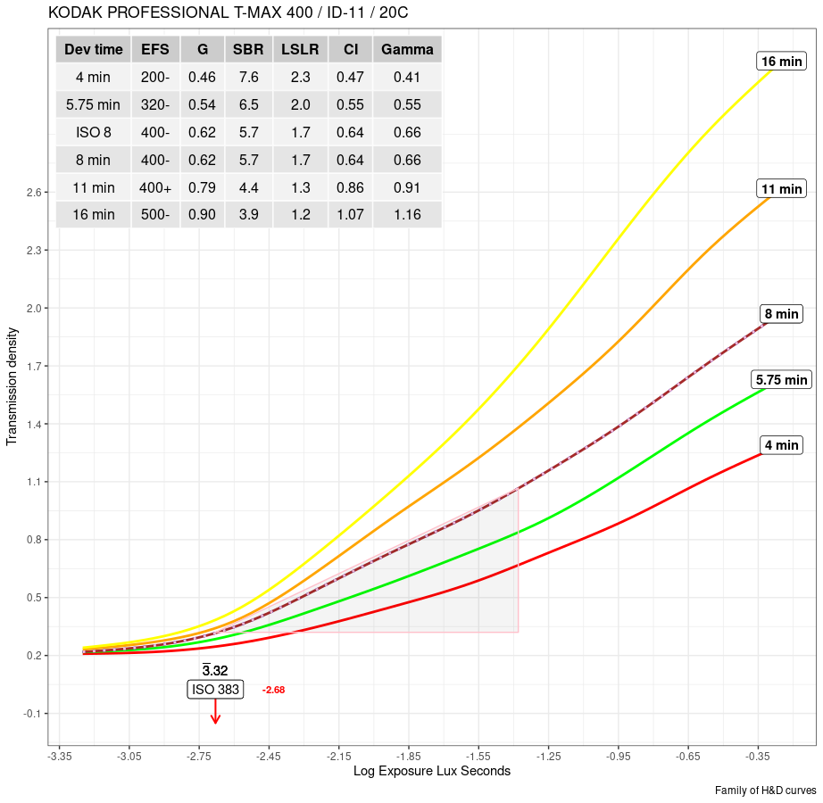

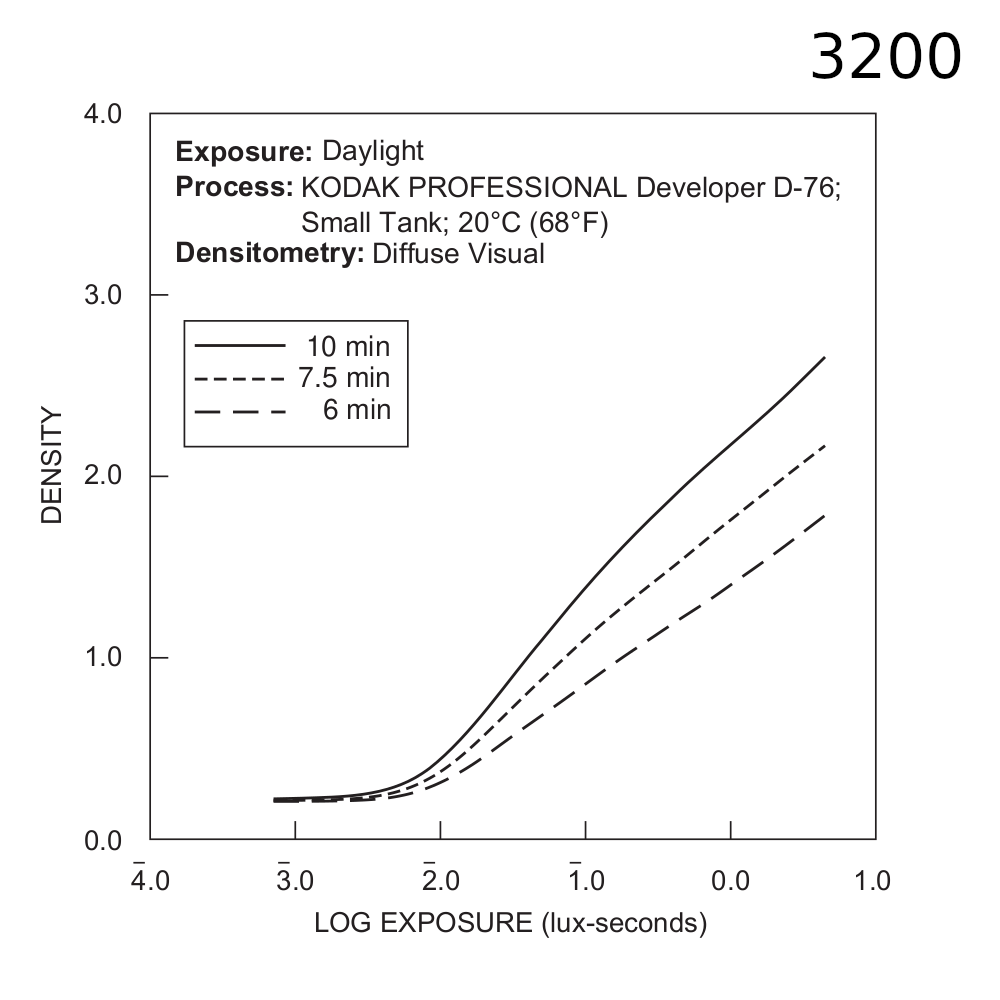

First of all, sorry it's taking so long to add more data to this thread. I am working on it, but it's slow going.

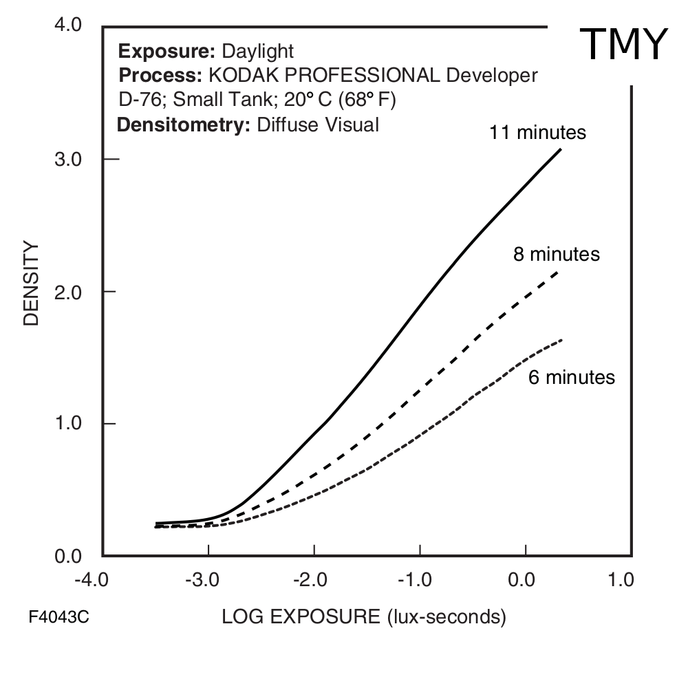

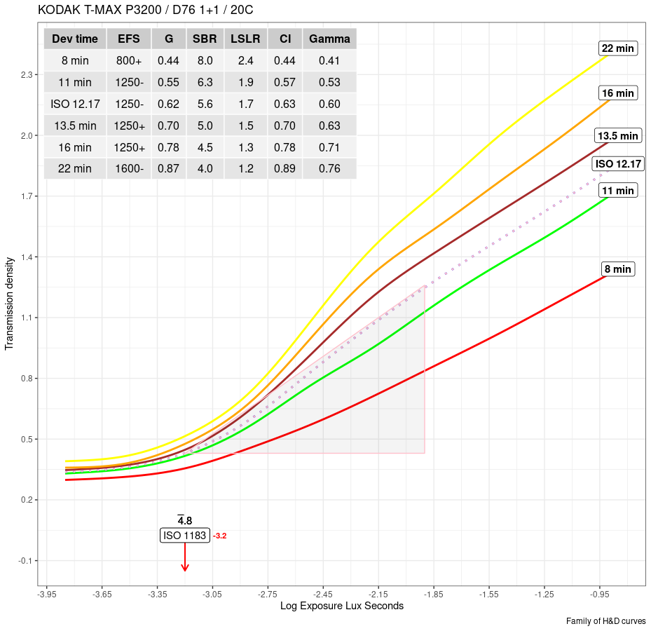

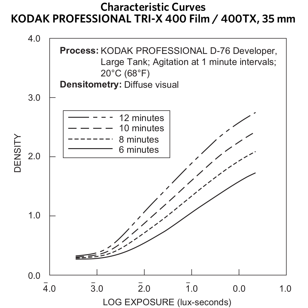

Meanwhile, I went back to the Kodak data sheets for TRI-X 400, TMY(2), and T-MAX (P)3200 to see how the curve families compare with those obtained in my tests. I picked the D-76 plots because they were closest to mine (I used D-76 and ID-11). Yes, I know some of you want to see more XTOL-R data, and it's coming. Soon :smile:.
It seems to me that Kodak's T-MAX 400 and T-MAX 3200 plots are for the older, now discontinued emulsions (TMY and TMZ), even though these plots come from current PDFs downloaded from Kodak Alaris. It's not a big deal. Kodak's technical literature is generally excellent.
KODAK PROFESSIONAL TRI-X 400:
KODAK PROFESSIONAL T-MAX 400 (TMY and TMY-2)
KODAK PROFESSIONAL T-MAX 3200 (TMZ and P3200)
