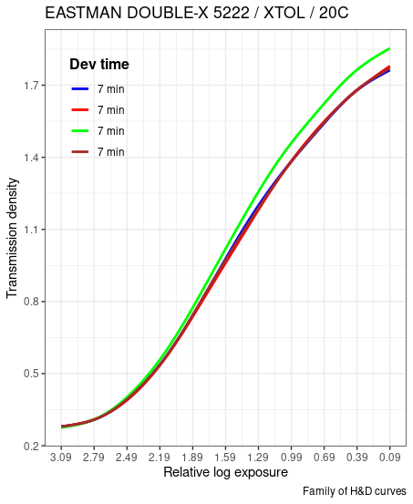

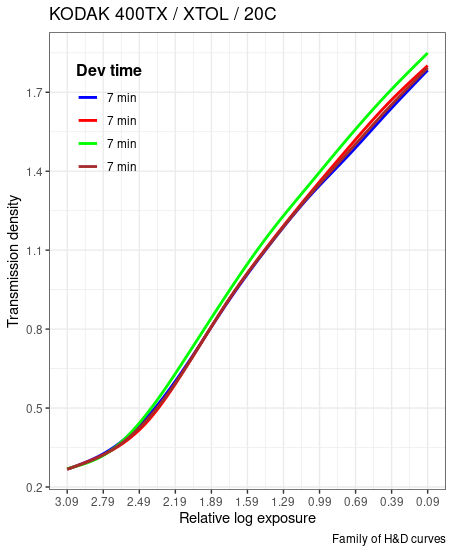

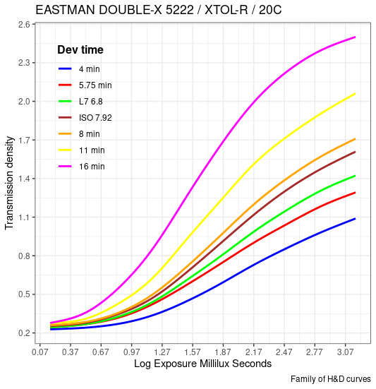

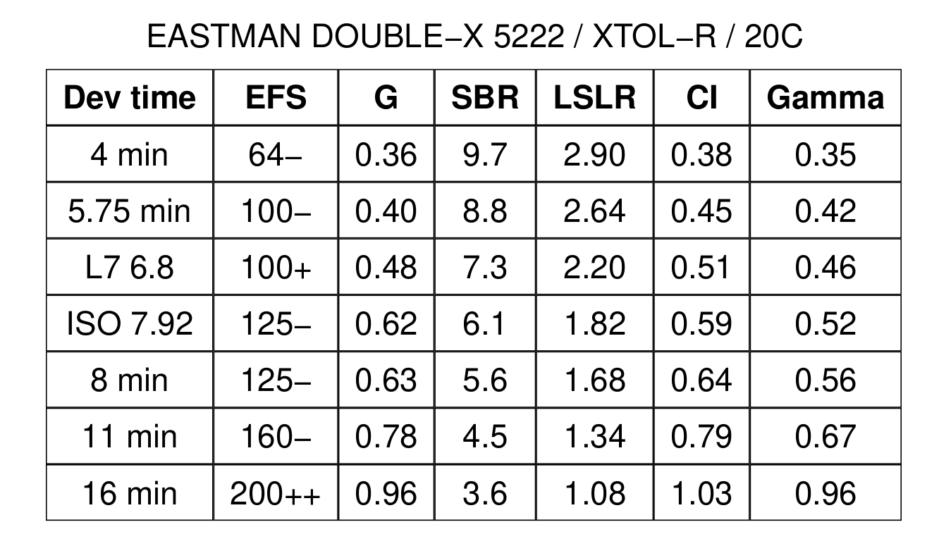

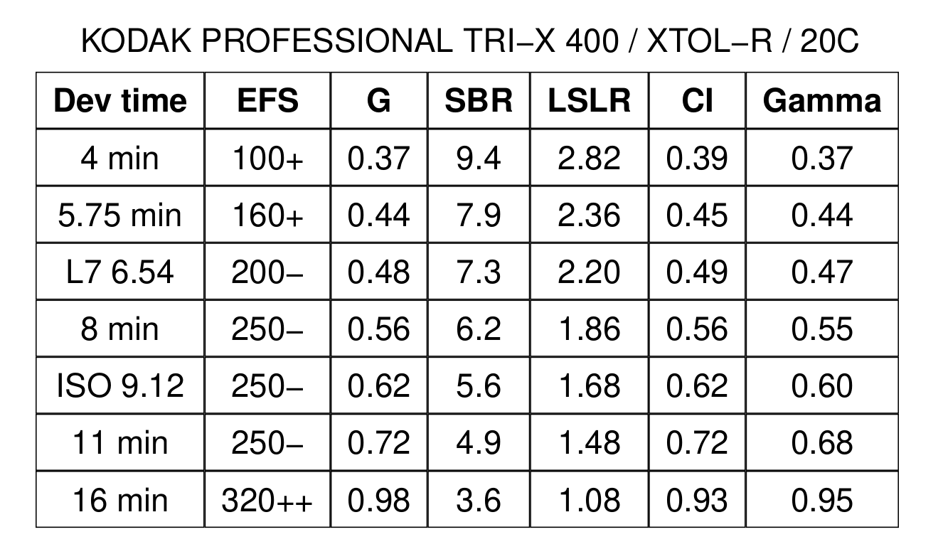

I ran a five-curve film test of the EASTMAN DOUBLE-X 5222 (ISO 200-250) and KODAK PROFESSIONAL TRI-X 400 (ISO 400), developed in seasoned, replenished XTOL (XTOL-R). I bought my 5222 from the Photo Warehouse, who assure their customers that the film is from “all Cold Stored FRESH stocks.” I seasoned my one-liter stock solution of XTOL by developing twelve 36-exposure films in it and replenishing at the rate of 70 ml of replenisher per film.
But before I show you the results of my analysis, I want to share some of my calibration data.
I run a calibration procedure before each film test. It involves exposing and developing a sample of the films under study four times to make sure that my process is reasonably consistent across trials, both in terms of exposure and development.
I exposed the EASTMAN DOUBLE-X 5222 and KODAK TRI-X 400 for the same amount of exposure and processed in the same Jobo 1510 tank by rotary agitation. To establish a baseline, I processed these calibration samples in stock XTOL (non-replenished) for 7 minutes at 20C.
I guess I overcooked the "green" development a bit, but, overall, the results show reasonable consistency. The curves of both films are well-formed, showing a long, smooth tonality and excellent tonal separation along virtually the entire range. Given enough exposure, these two films are obviously capable of excellent results. Yes, the two curve families have a slightly different overall shape, but it remains to be seen whether XTOL and XTOL-R differ in how they affect contrast, tonality and film speed.
More data coming soon. Your comments and suggestions are most appreciated!
I'm surprised, would have thought double x would have a straighter curve, TriX looks a lot like Tmax 400, may be just poor visual memory, I need to pull up the Kodak data sheet for Tmax in Xtrol to compare.
@Paul Howell You're right. The Double-X curve does look different. Keep in mind, this is just one development time. Also, Kodak recommends using D-96 with the Double-X, so that is going to affect the shape of the curve to some extent. I may end up testing D-96 at some point.

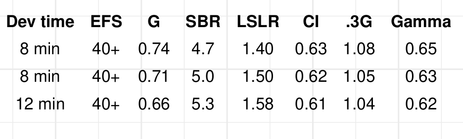

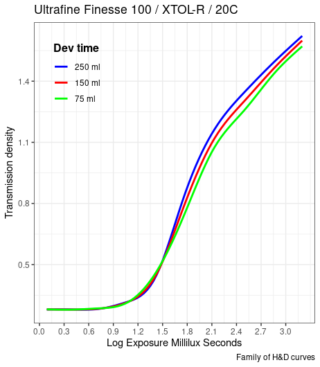

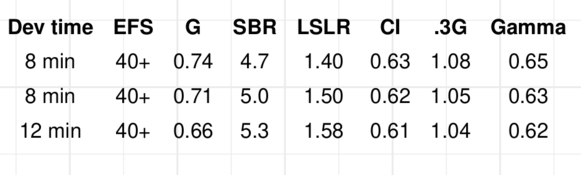

As I am new to replenished XTOL, I tested how different developer volume affects film speed and tonality, especially contrast. I did a quick test whereby I exposed an entire 36-exposure roll of Ultrafine Finesse 100 for Zone VIII, minus a four-inch piece for the step tablet (using my professional sensitometer), and another inch for d-max. I developed the film in three developer volumes:
  1. 250 ml in a Jobo 1520 tank for 8 minutes
  2. 150 ml in a Jobo 1510 tank for 8 minutes
  3. 75 ml (1+1) in a Jobo 1510 tank for 12 minutes
I guesstimated the 12 minutes 1+1 to be roughly equivalent of 8 minutes 1+0, but it's far from exact. I ran the test three times and averaged the density values over the three trials. The results are interesting. The film ends up being underexposed (due to my sensitometer's exposure for an ISO 100 film), but contrast index does decrease slightly (0.63 to 0.61) along with the decrease in developer volume. Is it a significant reduction in contrast? I guess it's up to an individual user to decide. Zone VIII density was very close, as was d-max, in all three trials, well within typical equipment / user variability. I noticed no issues with unevenness, or any other artifacts, across the trials. Having said that, this is far from a definitive test of developer volume.
I used Ultrafine Finesse 100 because I'd just bought a 100 ft. roll and have a lot of it left. Having to burn nine rolls of TRI-X for this kind of test would have been expensive and potentially a very traumatic experience :smile:.
If you want to be certain, it's best to follow the manufacturer's recommendations. To me, in XTOL-R, the 150 ml volume in a Jobo 1510 tank is just fine for one 36-exposure roll and 250 ml for two rolls in a Jobo 1520. Perhaps a 10% increase in development time might be needed.

This is really interesting, thank you for doing it and sharing the results. If you had left those graphs un-labelled, I would have guessed that the top one was the Double-X, purely on its reputation.

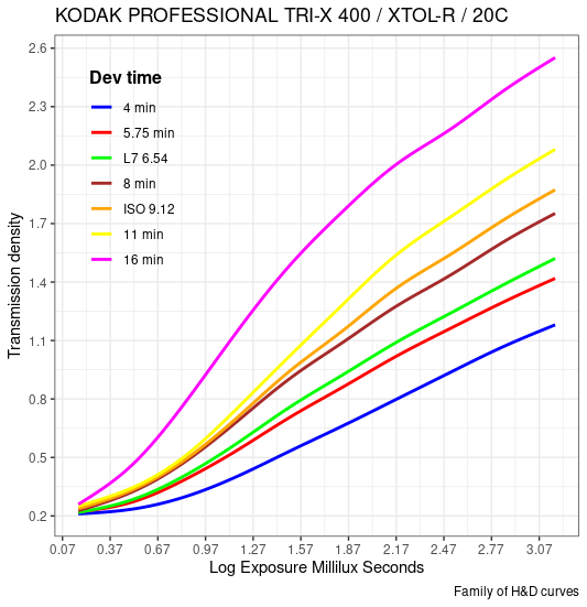

I have the curve families and summary tables for KODAK PROFESSIONAL TRI-X 400 and EASTMAN DOUBLE-X 5222 in XTOL-R in a Jobo 1520 rotary processor. One thing to keep in mind regarding DOUBLE-X is that Kodak recommends using D-96, presumably to get just the right kind of contrast and tonality for motion picture purposes. I suppose I should also test DOUBLE-X in D-96 to keep things fair. For now, however, I have the curve families for XTOL-R. Also, while I can be sure of TRI-X being in date, I have to take Photo Warehouse's word that their product is fresh, as well. I have no reason to distrust them, and, judging by the low B+F values, I'd have to say the film seems fresh.
The curves marked "ISO" and "L7" are theoretical curves for the =0.62 (ISO standard) and LSLR=2.2 (considered "normal"), respectively. To cut to the chase, as they say, TRI-X turns out to be around ISO 250, whereas DOUBLE-X is about a stop slower at ISO 125. Both films show excellent responsiveness to XTOL-R, showing nice tonality and well over a stop of gain in speed (shadow detail) over the range of development times.
And, finally, I must point out that these data were obtained with a DIY, uncalibrated setup and, as always, YMMV.
