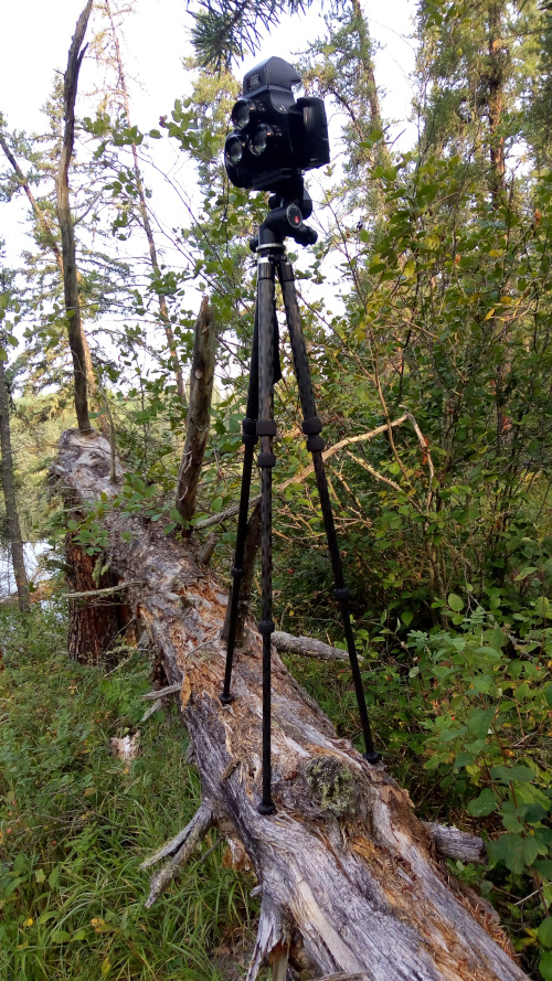

I primarily shoot with the TL-120, a camera created by the now defunct Chinese company "3D-World". Here's a photo of it in action:
