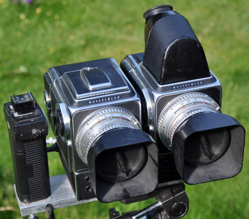

You do MF3D! Wow! What do you shoot with? Picture of my rig attached.
The UK stereo photo club "The Stereoscopic Society" are now only left with one 41 x101 folio group, and no one is doing MF. You've got a MF3D folio group in Canada? Cool. I though I was the only person on earth to this!
Anyway, even if I got my Agfa Alto working I doubt if it would ever produce trannies as good as a MF camera original. Where would I get the pixels from? I'd need at least 50M pixels to do even 8k justice.
