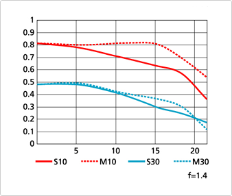

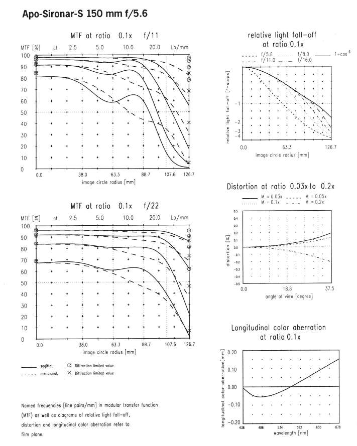

George, LF lenses are very good, 35mm lenses are only slightly better in practice, once you expose the film other degradation factors are dominant. Optically, compare those graphs:
Nikon 50mm 1.4G:
APO Sironar-S 150mm
The 50mm blue line hits 50% MTF in the center for 30lp/mm wide open
The (also normal 4x5 focal) 150mm hits 80% MTF at 20lp/mm 2 clicks closed.
This comparisson gives an advantage to the LF lens, but's not totally fair because the 50mm 1.4G is wide open...
Anyway results may surprise many... Please read this: https://www.kenrockwell.com/schneider/150.htm
I was thinking he was joking until I tested my convertible 150 with CMS 20, if I find the scan I'll post it... crazy...
In general what is sharp is the photograper, not the gear...
Of course, in theory, 35mm and MF lenses should be lp/mm sharper than LF, but YMMV a lot !!!
