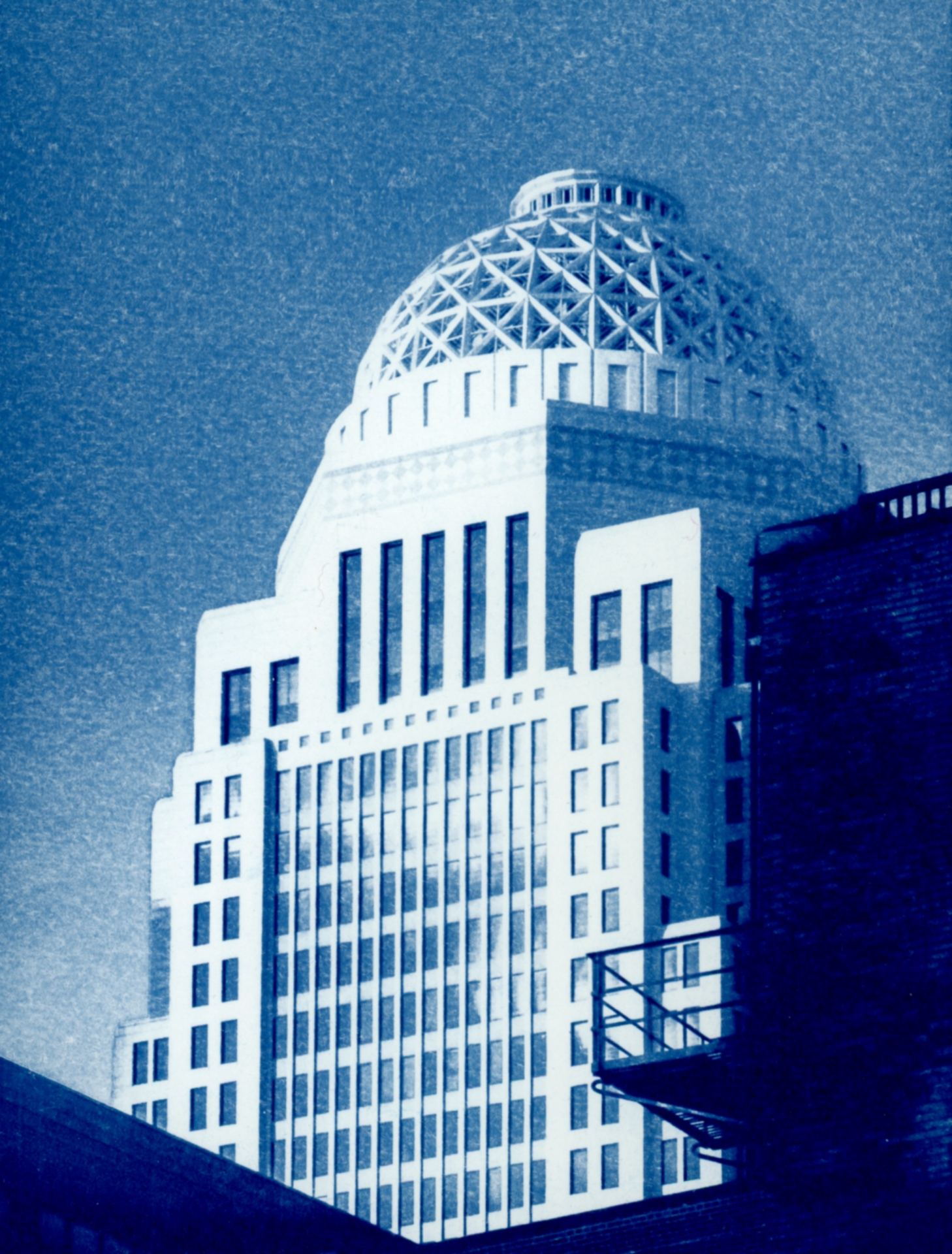

interesting thread - I recently was "gifted" 20-30 sheets of 22X30 sheets of Arches Aquarelle 140lbs CP ( by a retired watercolorist) , and tried it on Van Dyke Brown with fairly good results ( I am trying VDB for the first time) Attached is aVDB image ... came out fairly nice. The neg was made with a cyano curve but printed OK. Personally I don't care for the CP surface, I think I did some cyano also with it and the rough surface make it look a bit grainy in my opinion. I did initially acidify the paper with (citric acid solution) but the second time I used it - I just added 1 drop/ml of 40% to the sensitizer, along with a drop of tween and it came out looking just the same as the acidified paper and a lot easier to deal with. Overall it seems to work pretty well with VDB. I will have to try some more with cyano, since I have a lot of it.
Regarding cyano, I have used some canson Montval water color paper and that worked great for cyano - however I have the same issue with the rough surface- looks kind of grainy ( see attachment) I have also used Canson Bristol XL recycled for cyano and had good results - a pretty inexpensive paper - Oh BTW I am having issues with my home brew contact frame with make some areas not as sharp... need to fix that. I am glad that people like the Arches Aquarelle, I will have two work with it more.
