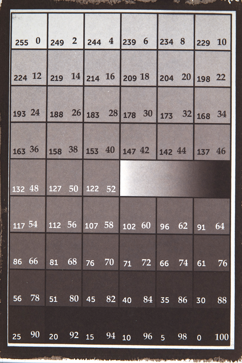

Here's a quick digi-snap of yesterdays step tablet (Clay Harmon's) using Arches Aquarelle. Paper came from a 9x12 300gsm watercolour pad, with no pre-acidification treatment. It's a fairly accurate representation. Used 4 lights on a DIY copy stand, so the texture isn't emphasized in this photo.
One coat of 2% salt and two coats 12% silver nitrate, toned in a gold borax toner. Sequence: 10 minutes in 4 changes of water, 30 seconds dilute salt bath, 5 minutes toner, 4 minute wash, 4 minute first fix, 4 minutes second fix, 4 minute wash, 4 minutes HCA, 30 minute wash. Believe it or not, the toner did take away quite a bit of warmth.
Used a manual salt curve I came up with for HPR. The first one was weak in the dark areas, so this one got a double coat of silver and increased the negatives density by changing Epson's ABW from 'Light' (which I was using for HPR) to 'Normal' as a stab-in-the-dark attempt at a good dark tone and maybe luck out with the high tones. Kept the same exposure time as HPR.
I like what I'm seeing in terms of colour and texture, so will continue playing with this paper.
...I guess if your pints come out OK (Dmin's at paper white or close) then all is good.
:Niranjan.
Looking at what is supposed to be the 'max white' border along the tablets edges, it appears to be fogged a bit...is this an indication that pre-acidification is required? Will try that today or tomorrow, just to be sure.
That might help. Also noticed you are not using any citric acid. Perhaps you didn't need it on HPR, but might be useful here. That would be my first line of defense - I'd rather not do acid treatment if I don't have to. Also, does it look like the shadows from 92-100% are kind of clumped up. Exposure time could be shorter? That might cut the fog somewhat too.

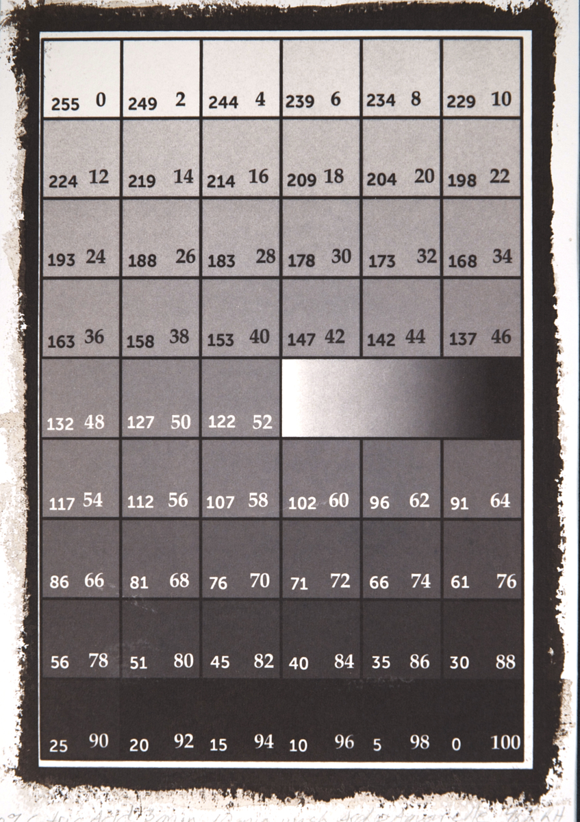

Here's the one from earlier today; the one that got the decalcification citric acid bath and then dried before coating. Photo is a fairly good representation, but nowhere near precise! (The white is overly warm in an attempt to get the gray tones to look something like the print).
Looks like you were right, Niranjan...the dark tones got some separation with reduced exposure.
Much less warmth than the last one, has smoother grain structure overall, has less 'fogging' in the white border of the step tablet, and the lightest square is closer to paper white.
Will do a max black test next, because it might need another minute or so of exposure. Will also probably make another negative and go from either Epson Advanced Black & White 'Normal' to 'Dark' density, or stay at 'Normal' and add 75 yellow.
Being pretty loosey-goosey at this early stage...laying a base for what I hope may become an intuitive level of understanding. Also, haven't settled on a paper yet and intend to tone in either platinum, palladium, or a combination of both once things get serious.
Wow...that is a great improvement. I like the tone better here, almost like eggplant and the highlights look more cheerful. Most of all, the grain and surface imperfections in the earlier print are nearly gone - I wonder if one of the side effect of doing the acid treatment is homogenizing the surface chemistry/physics somehow. Perhaps just the act of washing is responsible for this change - irrespective of the pH. Might be worthwhile to do this even if you don't need the buffer neutralization. I sense a set of experiments coming...🙂
Thanks for sharing!
:Niranjan.
The colour shift is amazing. In the initial water wash it appears to be made of cranberry with a dash of beets, changes a bit in the toner, a bit more in the fix, then radically swings to the cooler end of things as it dries.
