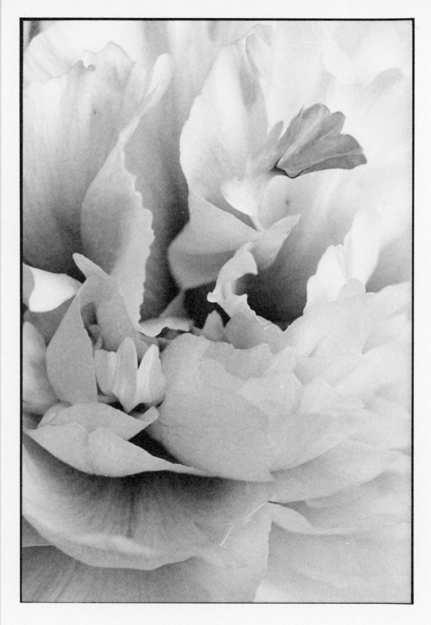

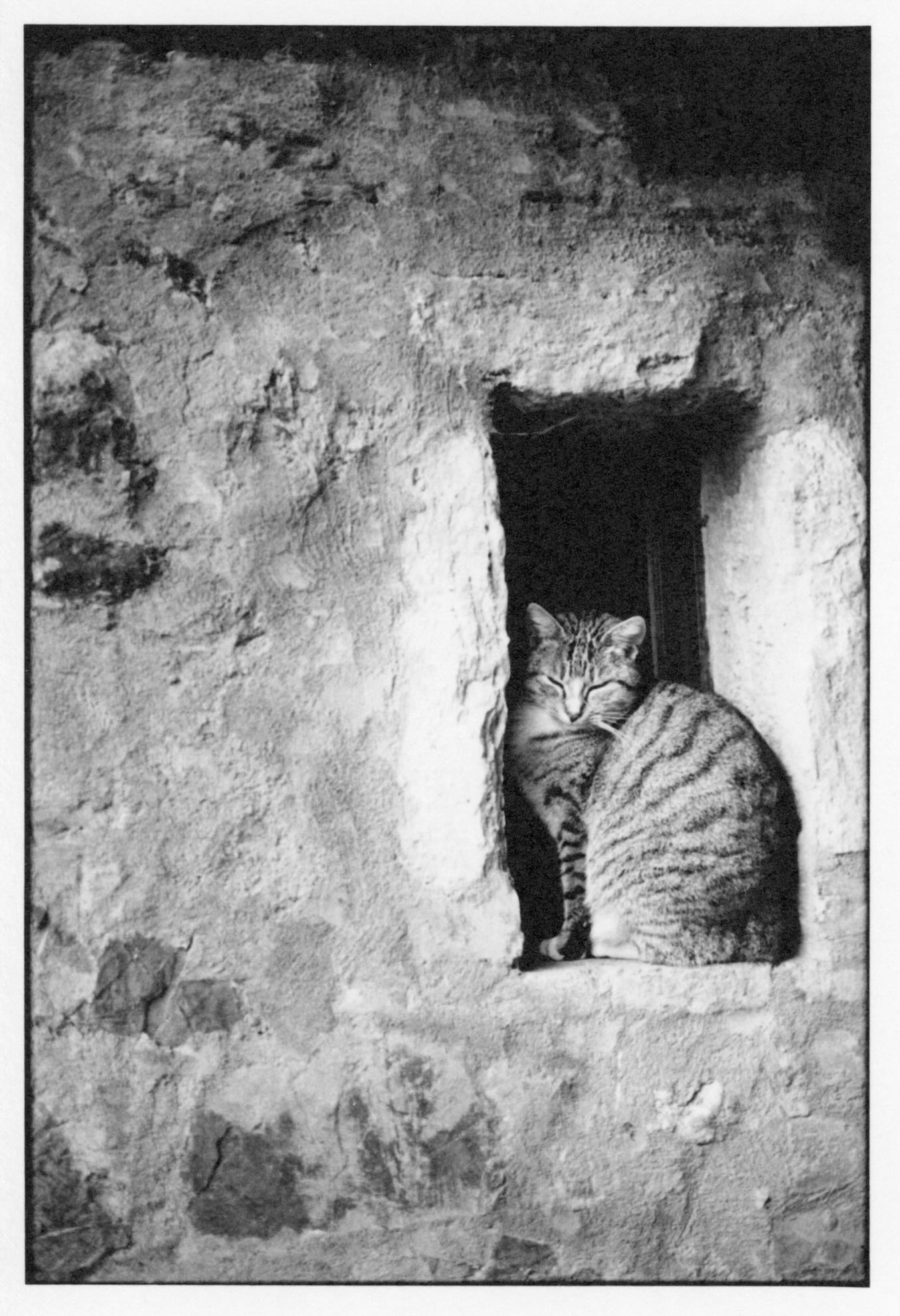

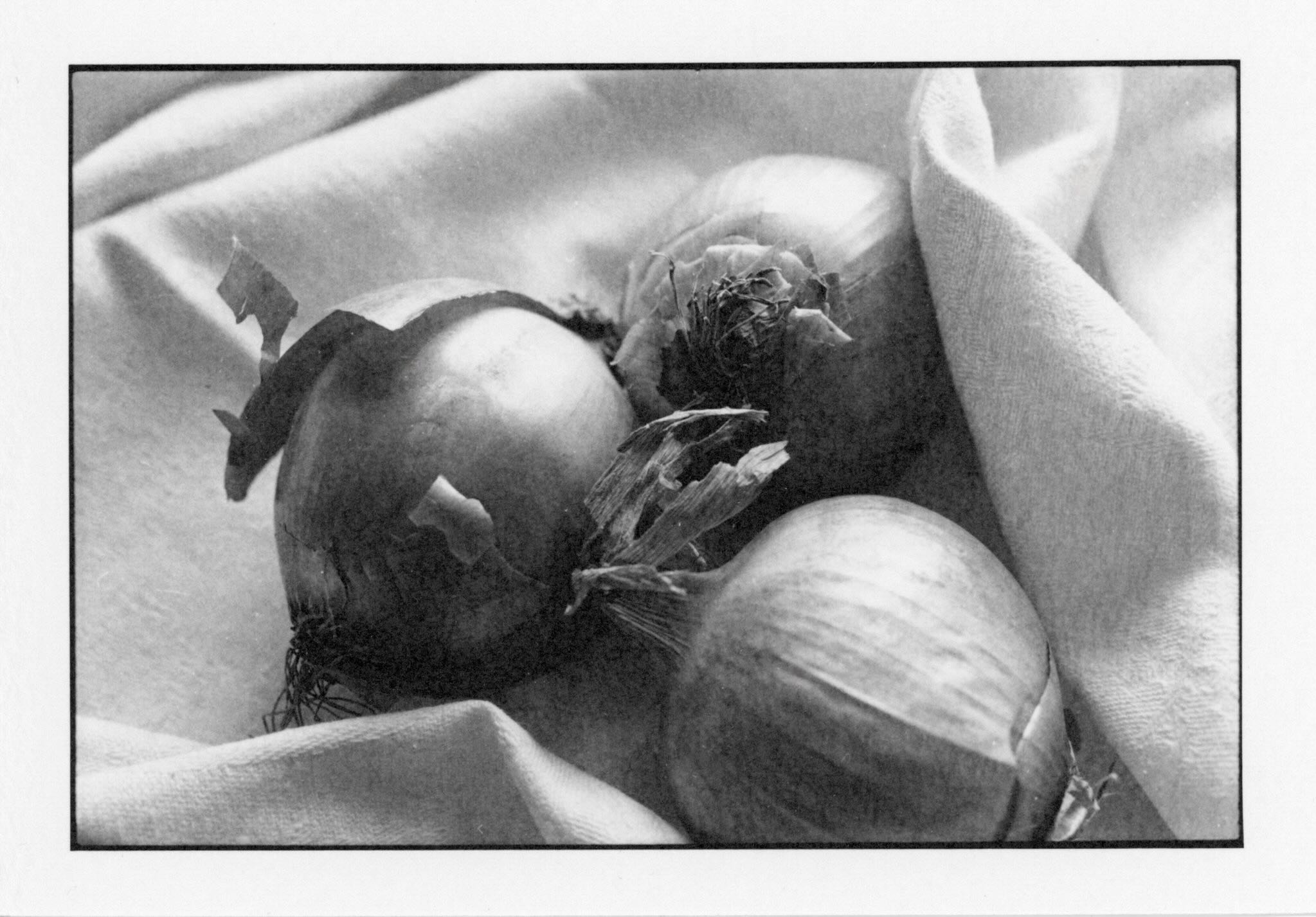

I thought the same thing when I ordered my first box of the Art 300 paper last spring.
Little did I know how wonderful it would prove to be.
I went through a box of 50 sheets in three months, then ordered a replacement.
It's a very particular paper, and some images are better suited to it than others.
Textures show up wonderfully, in my opinion.
These were all developed in Adox MCC dilution 1:4, and selenium toned.
As Matt mentioned, be prepared for this paper to float!
If left in the wash for too long a time, the edges tend to separate a bit.
I hope you enjoy this particular paper!
