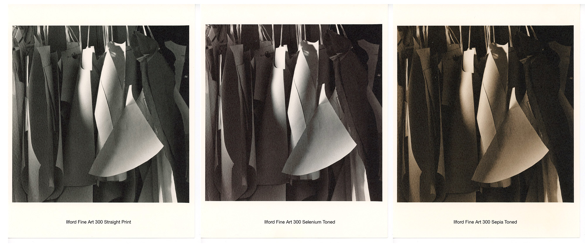

…and, fully toned in selenium, it yields a pleasing (says I) brown tone.

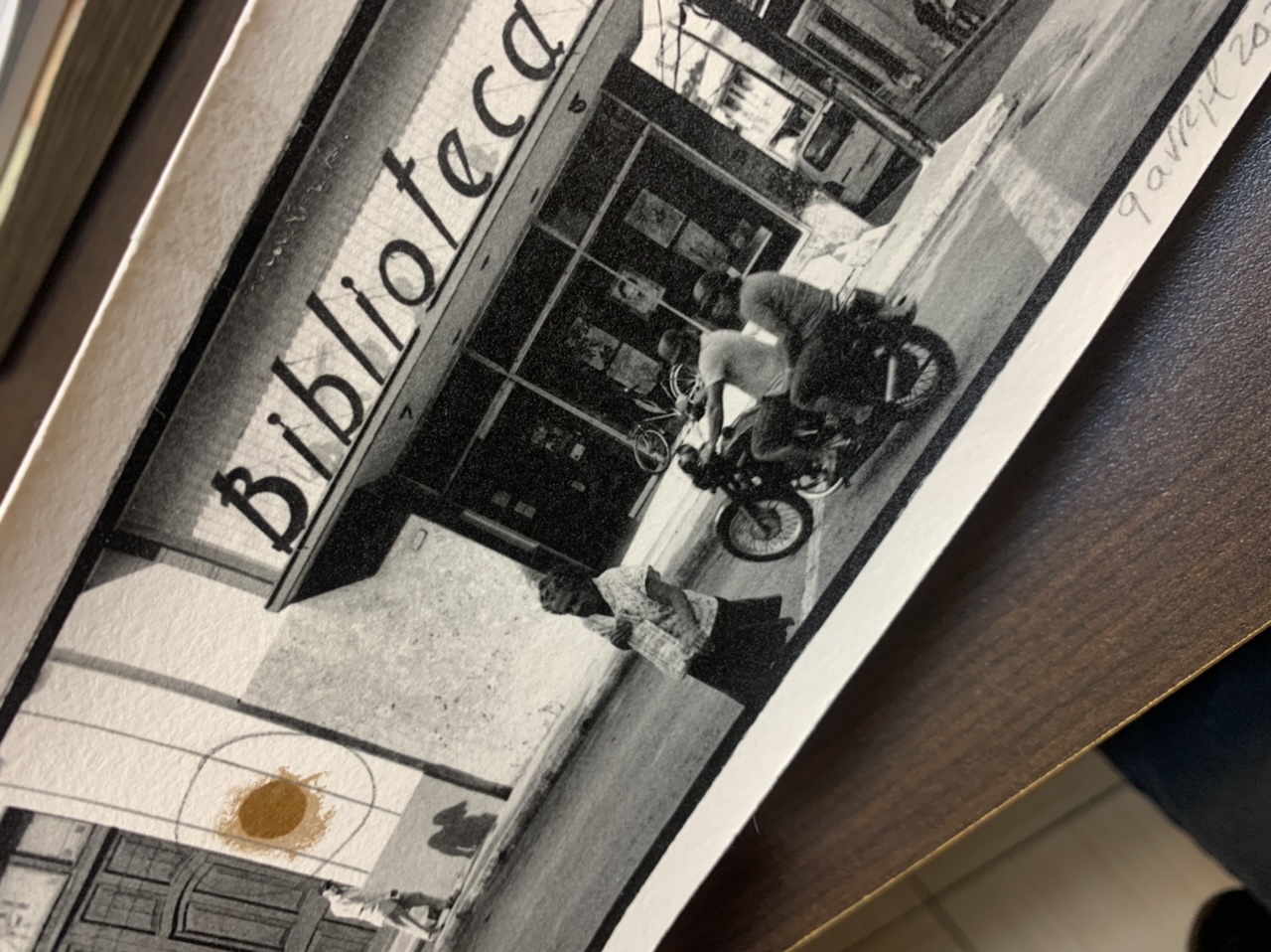

I like it, but some people don't, because -they say- its eggshell surface can't show as much detail as other papers: IMO photography has no relation with highest sharpness, resolution or finest detail.
It's supposed to be the same Ilford warmtone MG paper emulsion, but on thick watercolor paper.
I agree with you (and I like the paper), but I think it’s true that the eggshell texture eats some fine detail, and because of that, it works better for some images than others. I’ve had better luck with it for portraits than for landscapes, for instance.

Oh, yes, it's true the paper eats some detail: I didn't mean to say those worried about that, were just imagining that detail loss...

Well I printed my first ART 300 prints today. I can definitely see a use for it with portraiture but sadly, like every non glossy surface I ever printed on, I'm not a fan. The surface texture in smooth toned areas just seems like a distraction. Listening to the print hiss in the stop bath was a hoot though! I'll print a few other negs with it to see. I printed it under a diffusion and condenser enlarger and strangely I preferred the prints from the diffuser enlarger!
Hello,
When I tried selenium long ago, I didn't like its purplish tone, so I never used it again. I guess it was with neutral MG IV back then...
It's said Art300 has the warmtone paper emulsion too: have you seen current MG warmtone go brown instead of purple in selenium?

I haven’t tried selenium on warmtone, as I do not usually use warmtone. That said, I do have a box somewhere, so it would be easy to compare.
I am familiar with the purple— I’ve seen it on RC and, to a much lesser extent, the Matte. Very different outcome on the Art 300.
Possibly some forum members have a MG Warmtone or Art300 print, toned in selenium, just to see general tone...
Yes MGIVWT goes brownish in selenium
I haven't tried many sheets of this paper yet, but selenium toning this paper after a light bleach and sulphide toner turned one of my prints a dark brown. The color was rather pleasing, though not the effect I was attempting. I've had other papers turn very brown after a light sepia toning followed by selenium toning. It is not unique to this paper and I haven't quite figured out why that happens yet.

Just to be clear, I am talking about complete toning. I tone for about 8:00 minutes in a 1:9 solution. Less-than-fully toned can yield an eggplant tone I do not particularly like. But fully toned leaves a reddish-brown hue.

Yes, I've seen sometimes tone changes a lot depending on time... I'll test complete toning!
I've now printed a few negs on ART 300. I must say I love the emulsion and love the way it tones but I can't get past the "eggshell" surface, it never looks truly sharp to me. It would be great to have this emulsion on a glossy paper!
