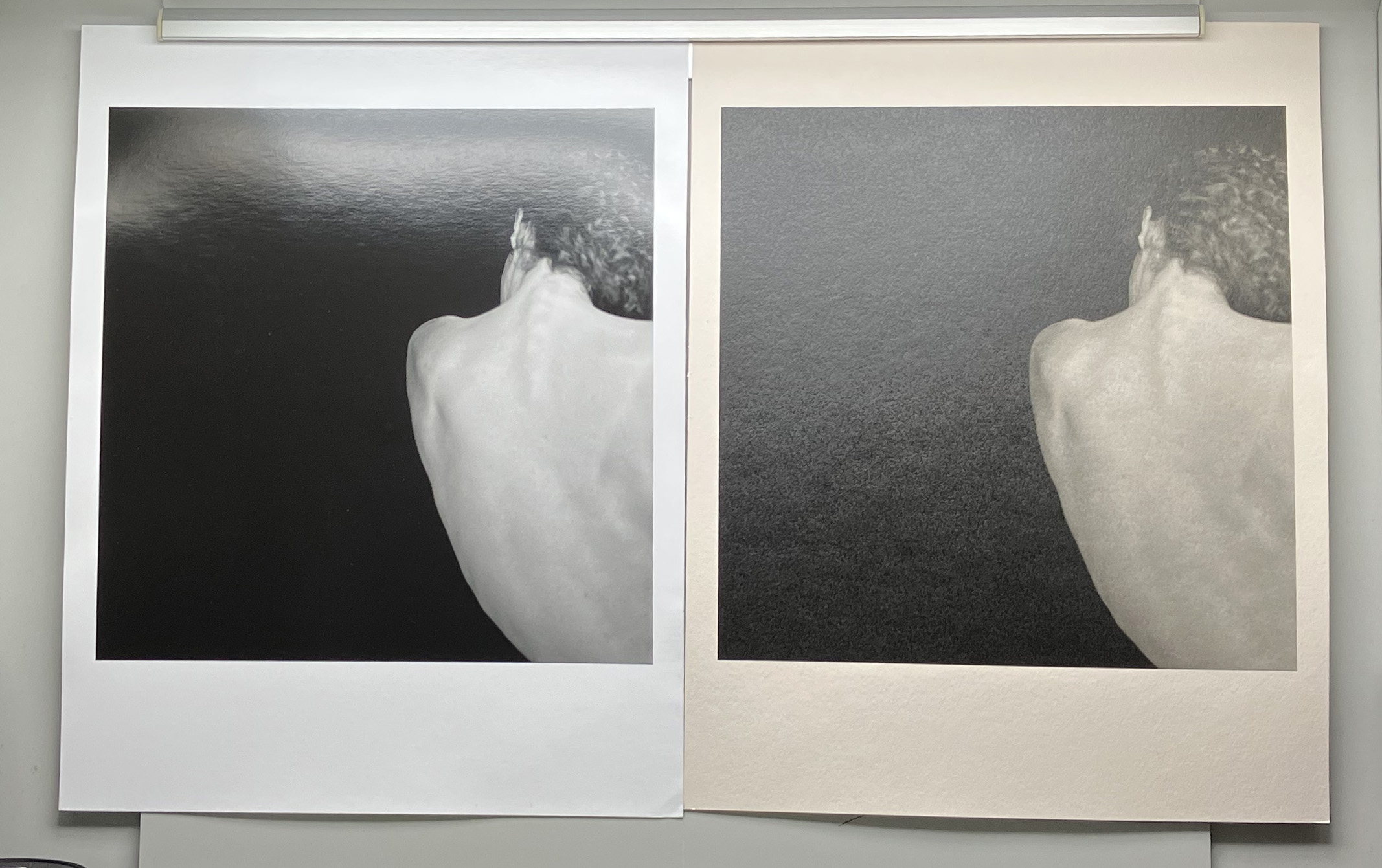

As promised, a comparison shot. There is quite a bit of dodging and burning on this, so they are not a perfect match, but you certainly get the overall difference in look. Sorry about the reflections.
Well, to be honest, I've never found Art 300 that far off white. I don't know why yours is, Pieter.
Thanks so much for posting the comparison, much appreciated.
I've read here and elsewhere that the paper is pretty contrasty and has good blacks. I don't know if it's the aesthetic choices you and others have made or the way the paper photographs, but the depth of the blacks and the overall contrast of the paper looks quite a bit lower than the MGFB paper. I saw something similar in the video posted several years ago by Chris Wartwood on his Grain channel on YouTube. Here's a screen capture from that video in which he shows an untoned print on the right and a Selenium toned version on the left:
The untoned print looks pretty low contrast to my eyes. Maybe just the contrast choice he made and/or the way the paper appears when photographed.
