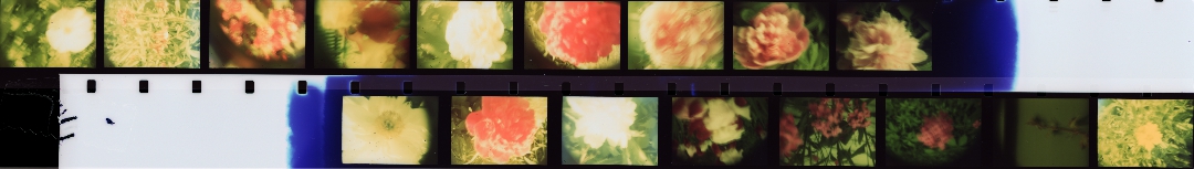

I've been experimenting with the 2383 in 16mm and been getting very... experimental results.

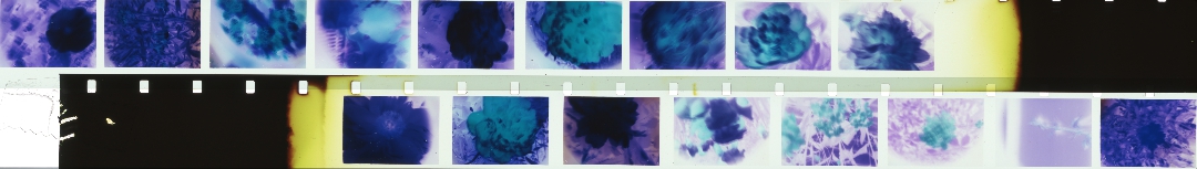

As an ECP-2 film, it responds poorly to the CD-3 component in ECN-2 and E-6 color developers. An E-6 reversal attempt resulted in zero positive image or dye formation, confirmed by bleaching away the negative image to reveal a totally clear base. The remaining negative images were quite distinct, however, and I see why they offer it as an ISO 3 b&w negative stock in 16mm (and 35mm?). I have yet to attempt a true b&w reversal.

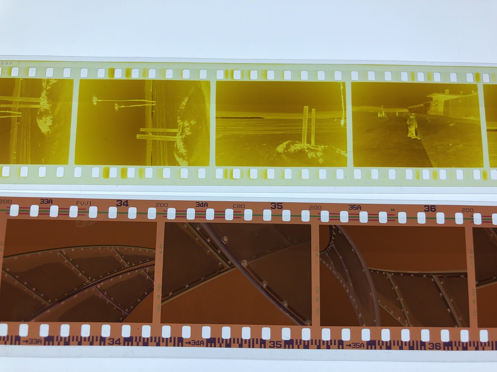

Shot in daylight and processed as color negative in C-41 yields wildly yellow negatives from the huge amount of extra blue light, precisely like the frames from Huss in post #39. Heavy filtering for daylight use is a possibility with probable impact on speed, but so far I prefer using it under controlled, artificial light (e.g. LED lamps).
