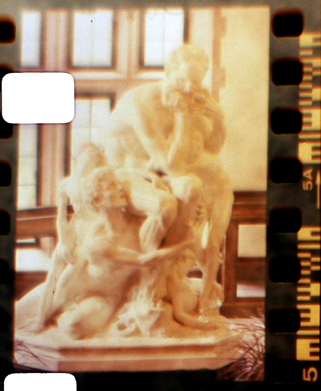

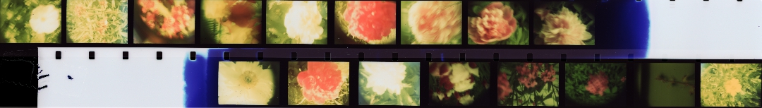

I did a color test of 3383 in daylight, filtered through a pack of Yellow 8, 85B, and a piece of cleared c-41 film base and developed C-41. The results are what you'd expect shooting hand-held bulb exposure macro on a windy day, but a direct reversal of the negatives yields close to lifelike color, maybe even a touch too warm. Film speed didn't seem to be impacted by filtering as much as I thought it would, but confirming that would take something a bit more scientific.
Edit: and a more carefully adjusted single frame from above. The yellow 8 filter definitely isn't needed. The amount of warming for more accurate color rendering is probably somewhere between a regular 85 and the 85b+C-41 base combo depending on cloud cover / season / daylight color temperature.
Most folks would probably be better off with Vision3 and an ND filter but maybe developing in CD-2 will boost it's appeal as a slide.
Next I'll try contact printing c-41 & ecn-2 negatives directly onto the 3383 and process in C-41. The film base plus an incandescent light source seems just about the right color temperature. So far, I'm convinced that the only way to get a fully analog positive image out of this stock is to start with a negative, as designed.

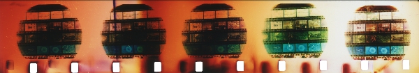

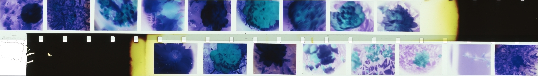

I tried photographing a variety of negatives using a very short, mostly fogged 3383 remainder from my mamiya 16 cassette. The negatives were poorly illuminated with a 40W incandescent bulb and given 1/5s exposure @ f2.8, developed ecp-2, scanned as positive.
Top to bottom: Pro Image 100 (dense), Gold 400, Vision3 500T w/ 85B, Kodak 2254. (and some ektachrome peeking in at the edge).
The last two frames are the 'cleanest' and were taken through Y50 and M50 filtration, respectively.
Not unexpectedly, 2254 needs even heavier filtration to print with anything close to a normal color balance.
Probably worth another attempt in a 35mm body with a faster lens to get the exposure into the 1/20s+ range and tweak the filtration.
Edit: Another round, same lamp. Unfiltered, Y50, M50, Y50+M50

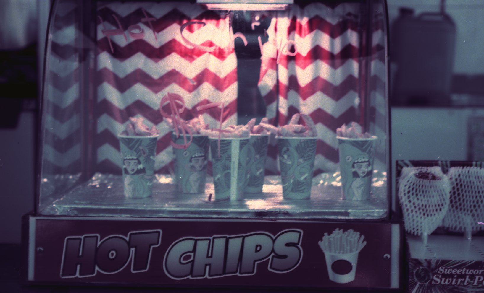

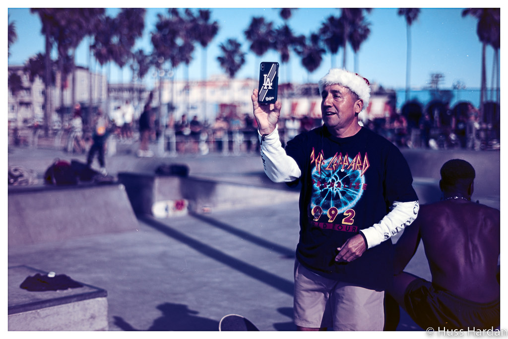

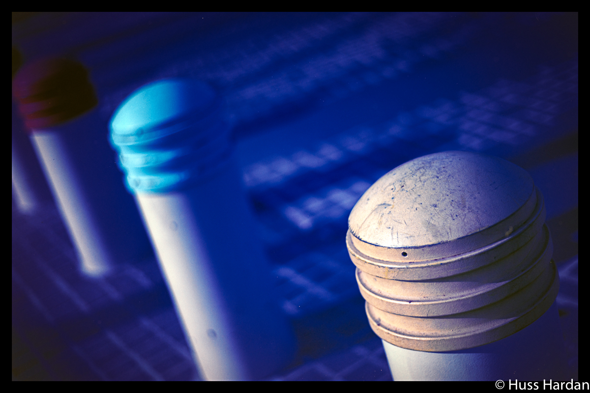

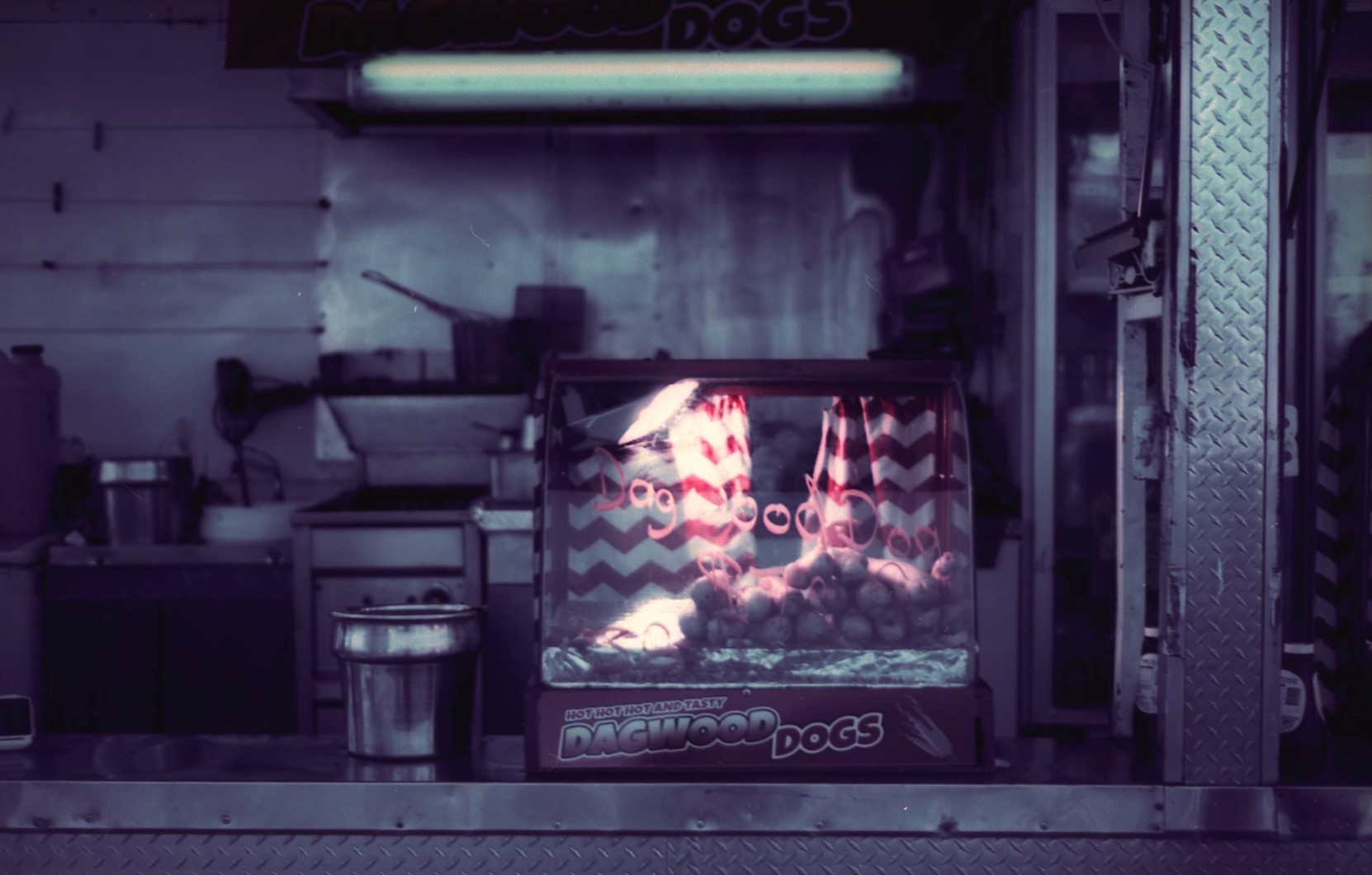

Leica M7, Summicron 28 Asph v2, Slow Your Roll ISO 1.5
I finally shot a roll @ 6iso using a Nikon f100. Results were underexposed, even with an orange filter was very blue, nearly no colour.
Will try again giving it 2 more stops and see how it is.
Looks nice with lights, can get a nice jade green with fluorescent lights and reds and pinks stand out.
How are you colour correcting?
