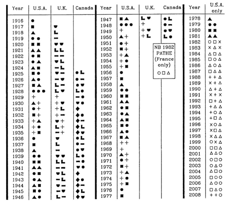

The few post-WWII Japanese archival elements I handled always had Kodak edge numbers printed through. That's not to say there wasn't Japanese Filmmakers using Fuji stock, I just never saw it in my limited exposure to the few elements I handled...

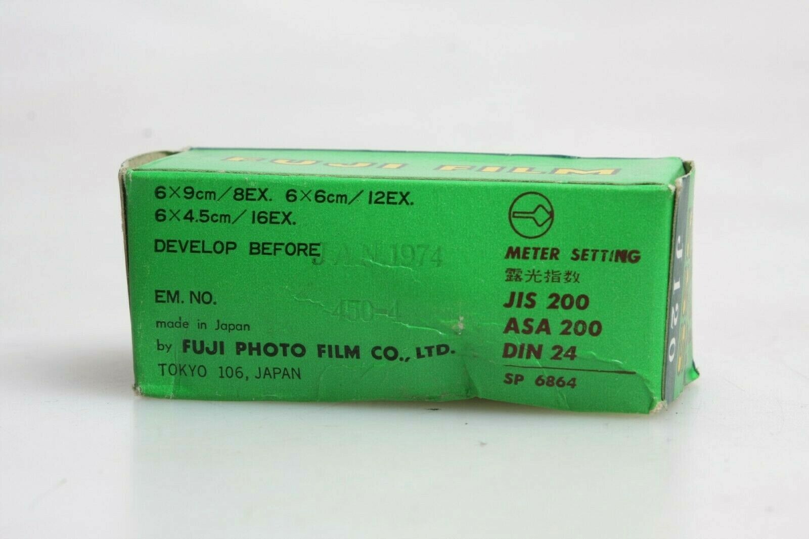

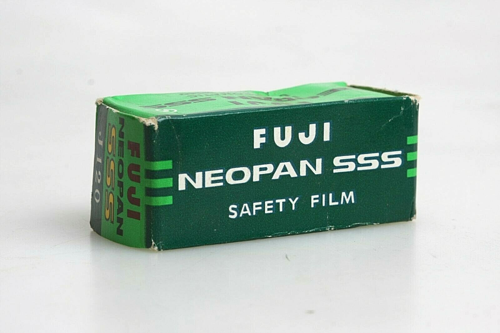

Now the oldest Fujifilm I've been able to locate is a roll Fuji Neopan SSS, 200 ASA, expiring in 1974. Marketed as a Panchromatic Ultra High Speed Safety Film.

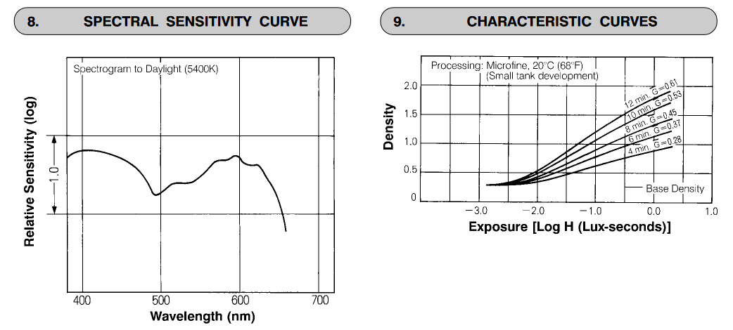

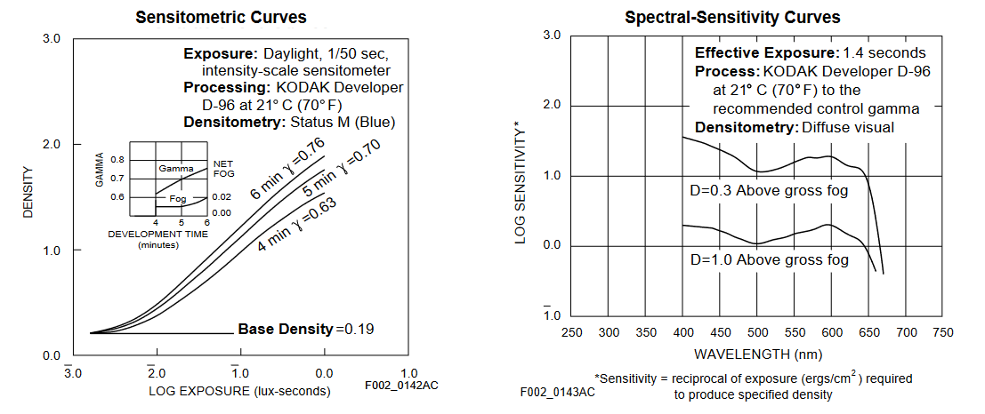

Now I've learned there was Fuji Neopan S, SS, and SSS, analogous to Kodak Plus-X, Double-X, and Tri-X. I checked out the spectral similarity between SS and Plus-X and they look very familiar to each other. Perhaps Kodak and Fuji during this time of classic-grain film really didn't have a huge difference. Maybe an old Kodak and an old Fuji film are pretty much interchangeable, though one is still being made and the other is not.
Fuji Neopan SS 100
Kodak Plus-X 125

The simplest way to discover which film was used on any of his films would be to read a film’s credits listed at beginning of movie. Japanese movies usually include film type, processor, sound and sound processor, etc. Haven’t double checked, but I believe that Ozu used Agfa for his color film.
Actually, Double-X doesn’t have frame numbers, at least nowadays. As a cine film, I don’t imagine it ever did.
