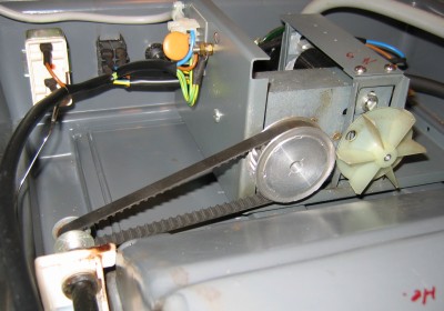

about to acquire an RCP40 (not the Vario). trying to figure out if it was adapted to RA4. paper moves about 10 cm /4 inches per minute. a 24 cm / 10 inch long sheet of paper takes 7 minutes from start to end. is that ok for RA4? would so like a copy of the manual. thanks

would it make sense to add a speed variator to the motor? what kind of motor is this?

My RCP40 has bit the dust so I can't set it up to check the speed of it but if I remember the paper should take about 2 min 20 sec to travel through the machine. I think that if you are getting a 7 min travel time it is still set for EP2.
You will have to change the gearing to speed it up for RA4. When I got mine it was already upgraded so I can't help you with the mechanics.
Here is a link to a site for upgrading a RCP20 which may be of help.
https://www.vogelstimmen-wehr.de/rcp20.htm

yes thanks I have read that. wondering if the same size gears would work on the RCP40...

anyone please can check their RCP40 and measure the size of the two gears linked by the toothed belt? please note picture is from an RCP20, so just as a reference. thank you so much
Were you able to get the gear and belt measurement that you needed for the RCP40?

nope, anyone could help.
I also tried to get a quote for a motor replacement with speed variator, to no avail.

hello RCP40 fellow users,
I need to get a new belt for my processor ( RCP 40 VarioSpeed)
The one I have is not the original one and it's too long, hence loose.
Would anyone with an empty machine be so kind to tell me what the original belt has written on it?
There should be a code like 220xl.
Or does anyone have a spare I could buy?
Thanks so much!!!!

After various attempts, I now know the right size RCP 40 timing belt should be either 192XL, 194XL or 196XL.
( I have a 200xl, way too long and a 195xl, way too short!).
If anyone has the machine not in use and could tell me what they have I would highly appreciate it.
Thanks a lot!

Just thought I'll let you know, I found that the correct timing belt for the RCP 40 Variospeed is the 198XL.
