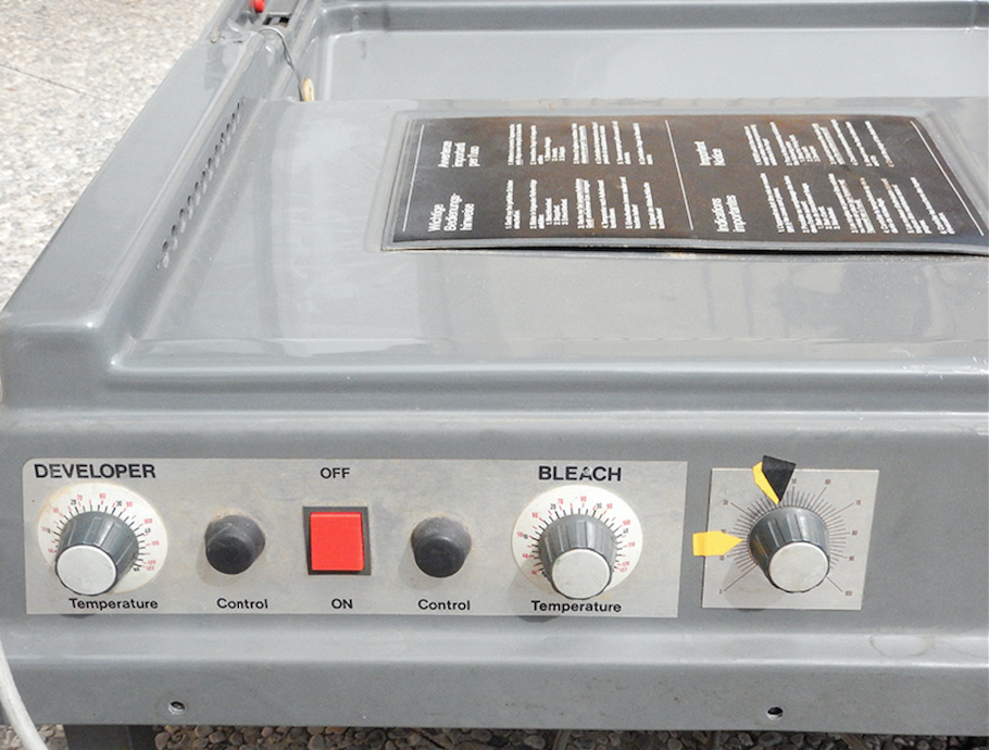

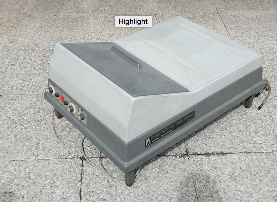

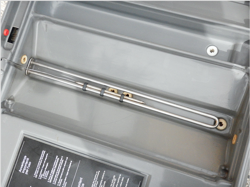

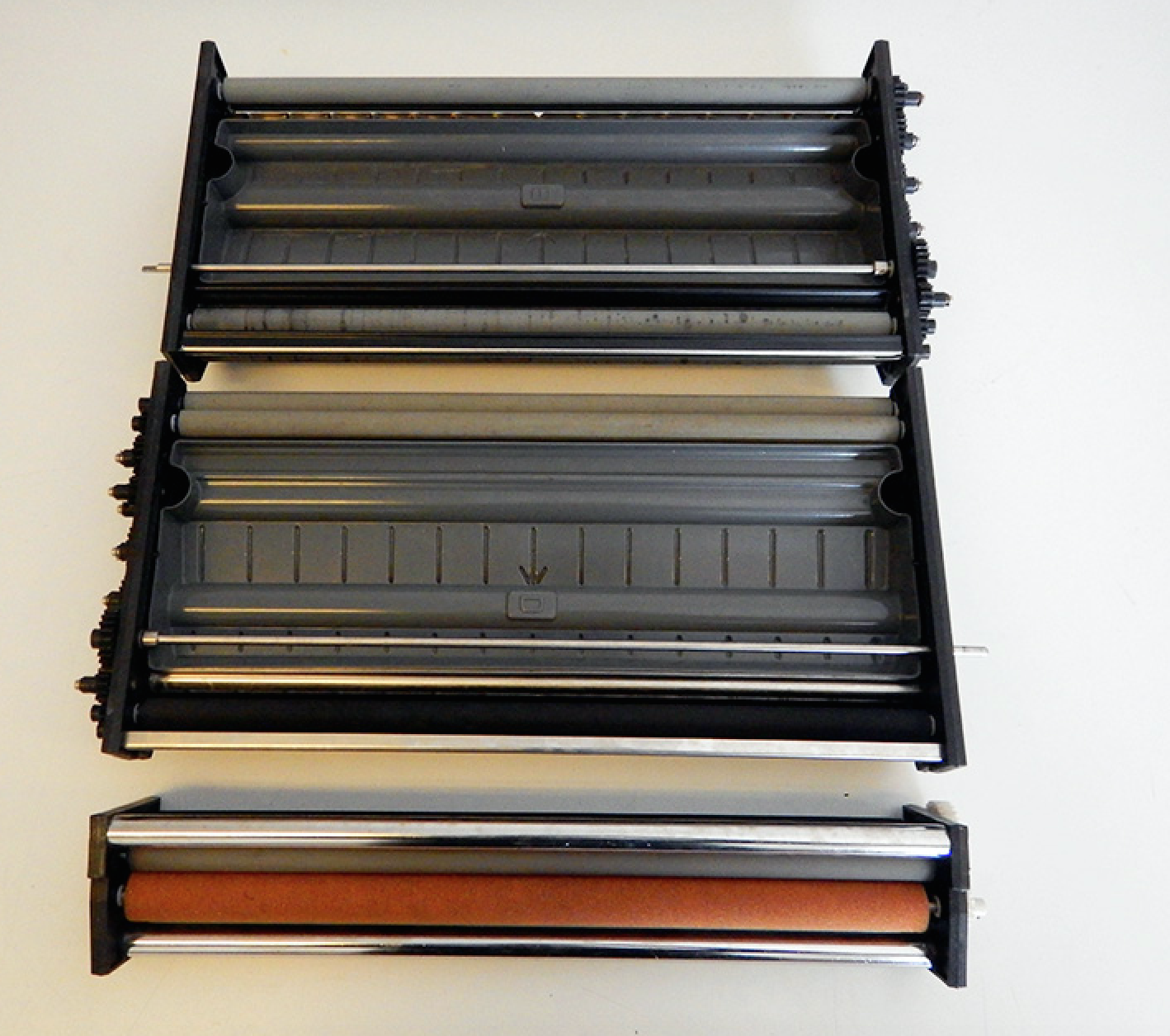

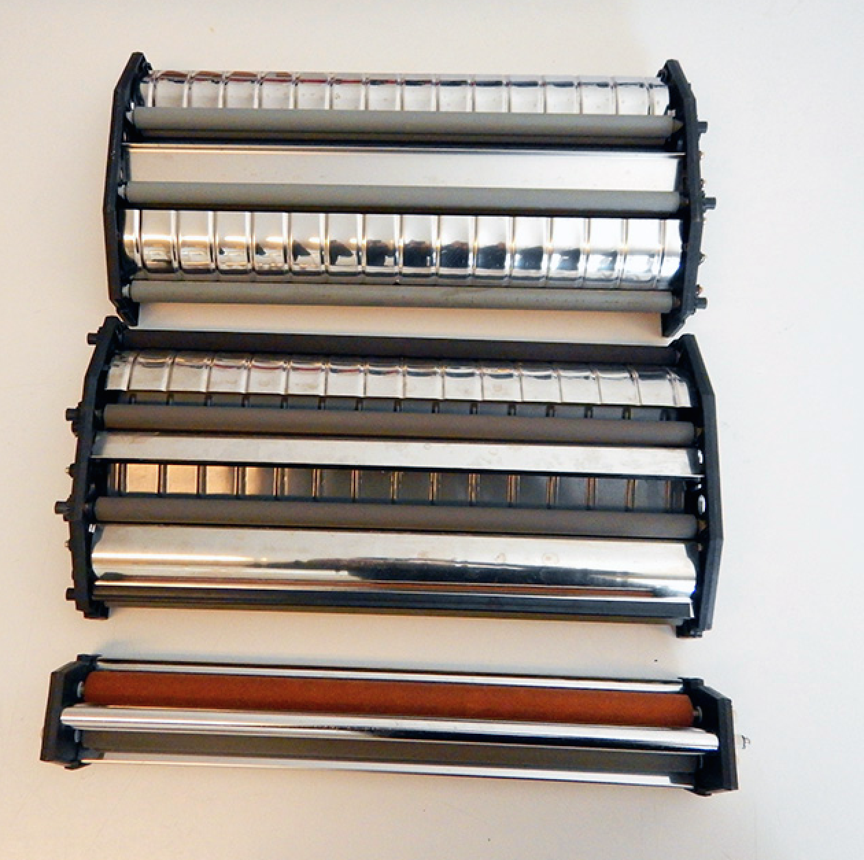

finally I was sent some photos of the RCP 40 VARIOSPEED I was telling you about ( whose engine doesn't work, but the rest seems to be in perfect condition ).
Any comment or advice would be highly appreciated....
Thank you!!!!

Jul 4, 2017
55
Montreal
Hi Roberta, again, I'm no expert, but it certainly looks cleaner than my RCP 40. I wonder if the seller would be willing to unscrew it and take a couple pictures of the insides? Perhaps it a really obvious thing like the drive belt off the pulley?

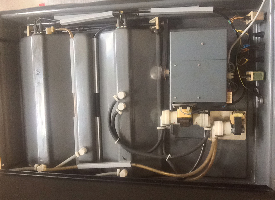

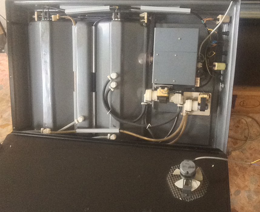

Hi, here some photos of the inside. bottlegardener, the drive belt seems fine.
AgX
Apr 5, 2007
29,972
Germany
Looks good. It actually has 4 motors and the ventilator, contrary to what I thought, is seperate.
Pull the plug (well, you seemingly already took off the wiring of the vent), check by sight all cables, contacts and the fuse filamant, if there is a fuse.
If all seems ok, set it on and report back... The 3 pumps though better should not run dry I assume. So only try for a moment or fill them. What of course makes checking the underside difficult...

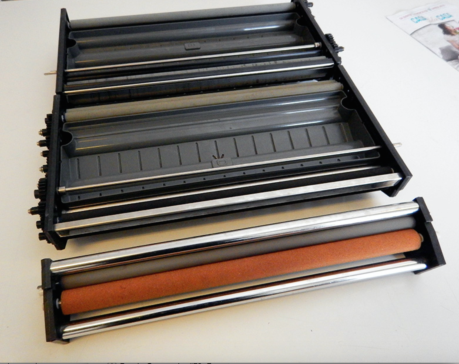

You can also check with the plug pulled if the gear train is working and not stuck somewhere.
Also check whether the rollers in the racks you pulled out can be rotated.

I already noticed one of the rollers was kind of stuck and needed some strength to be rotated.
I guess a bit of oli should do. I will get some today.

You can try and run the processor without the racks inserted, and then with just one inserted. By this you could nail down a problem related to one specific rack.

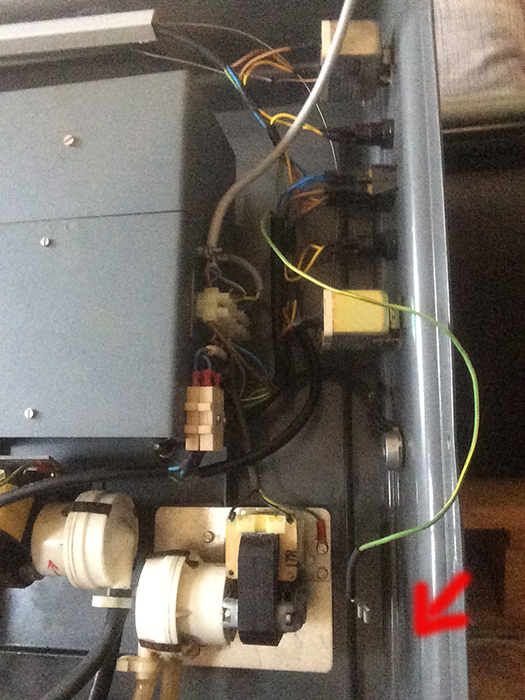

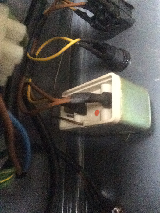

Hi AgX I just noticed one of the green cables ( where you see the red arrow in the ph ) was not connected to anything. But I don't really know where it should be going.
AgX
Apr 5, 2007
29,972
Germany
Yellow-Green by standard is the Protective Earth.
One end should go to the mains cable, to its protective earth wire. UNLESS your cable is to connect as earthing two components, then your free end should go to another component. I cannot find out from that photo.
But the type of connector may give an indication were not to put it.
AgX
Apr 5, 2007
29,972
Germany
In your preceeding photos the now free end was behind the lower right pump assembly, what might be the place were it was connected. (The other pump assembly is also connected to three wires, but I cannot see details.)
RMB10
Mar 26, 2018
53
London
Analog
perhaps it goes here. I can see the third connection on the far left is not taken.

AgX
Apr 5, 2007
29,972
Germany
That is the temperature control. Earthing does not make sense, in this case.*
(Unless its counterpart at the left, or above in the photo, has such, what I do not see. Also that earthing wire would be too long for use at the right/lower temperature control.)
*Basically earthing of such control (thermostat) would make sense, as its probe goes into the processing bath. However the probe is clamped to the heating tube and the tube's cover is connected to earth.
Earthing of the pumps though would make sense to me.
Though it seems both pump assemblies already got an earth wire at their base plates.
AgX
Apr 5, 2007
29,972
Germany
My last guess would the steel frame the base plate is mounted on, if so. Then there might be a connector to that frame, likely on top of the base plate, the side were the vent is located.
Otherwise I am clueless.

The green/yellow wire is the earth for the metal baseplate which was removed for the photo's.
There should be a flat tag bolted to the base to attach that wire. If not, then you need to make one because you are mixing liquids and electricity.....not a good mix if there is a leak while the power is on.
Mike
BTW.....looks VERY similar to my RCP20 except the '20 has only one motor.
AgX
Apr 5, 2007
29,972
Germany
It feels good to have it got right at the end...
Thank you for solving that enigma. The photos we got were not the best.
But still the whole shebang was quite simple and I was getting mad by not solving it.
That base/frame thing was my best bet, as I not even was sure it was made from metal.
With all other components seemingly already protected the large free lenght of that cable did hint at something to be removable.
