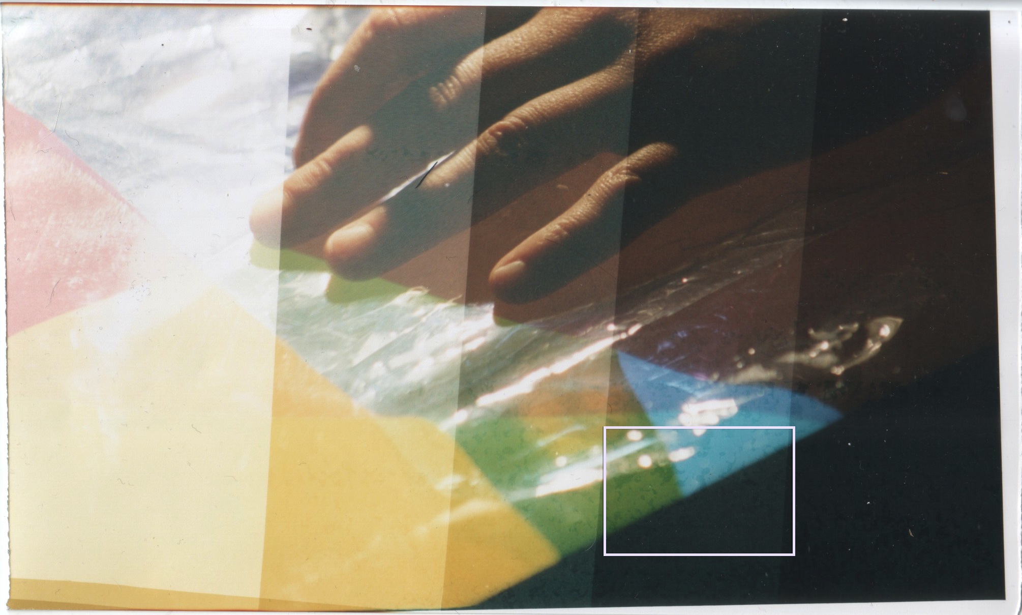

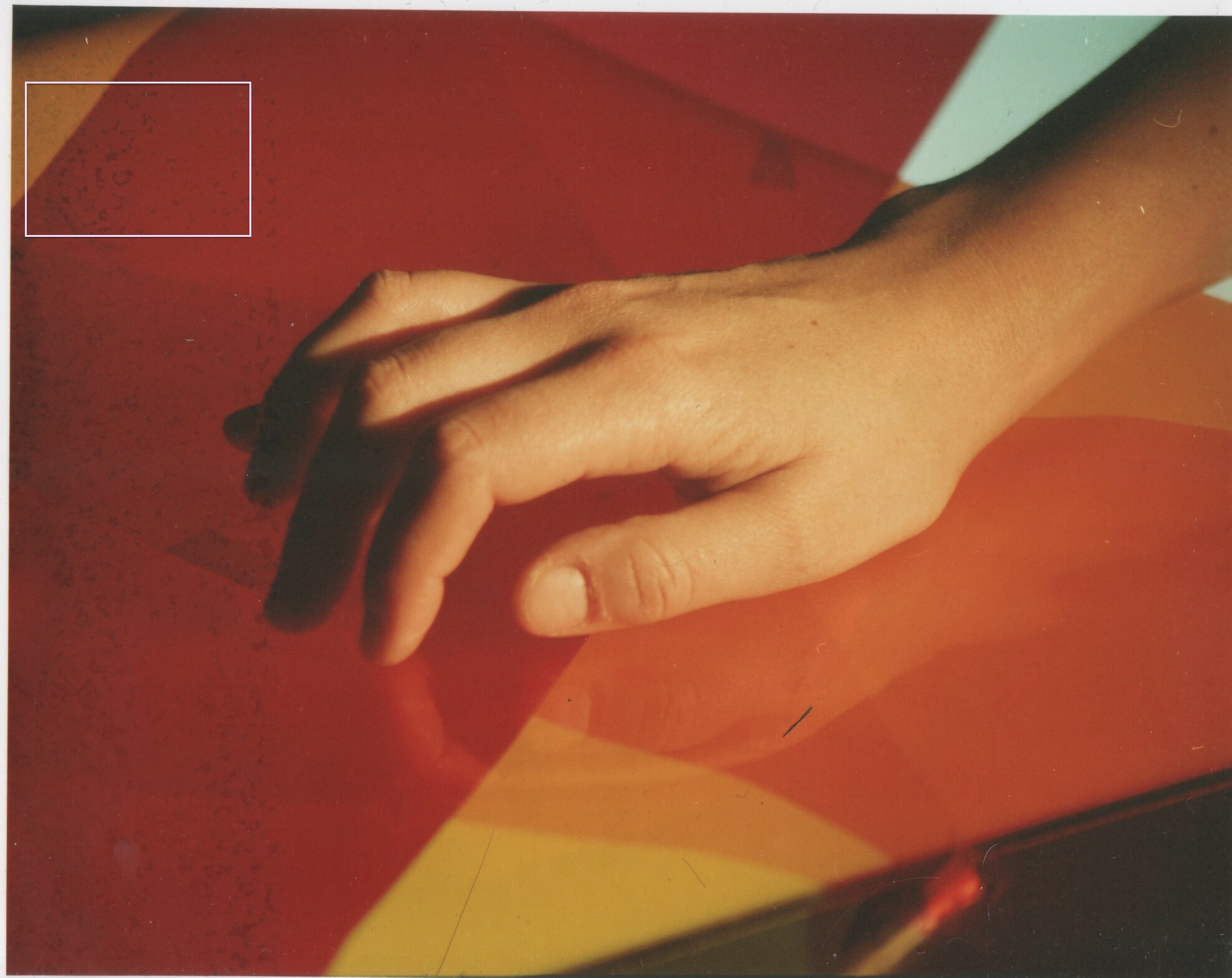

  11. OP
    bottlegardener
    bottlegardener Member
    Messages:
    35
    Joined:
    Jul 4, 2017
    Location:
    Montreal
    Shooter:
    Thanks everyone. The toilet cleaner plus many, many, many rinse cycles seemed to help clean it up.
    I ran test prints through it the first time last night. It worked well except for unusual blotchy artifacts on the prints.
    The artifacts seemed to consistently appear on the edge of prints that entered the rollers first. The effect was different every time and not on scans of the negatives.
    Any clues as to what could cause this? The stop bath doesn't have a heater and the room was quite cold, could that have a reticulation effect?
    Excuse the dusty, poor quality scans of these attached test prints. The artifacts I'm talking about are shown in the white rectangles.
