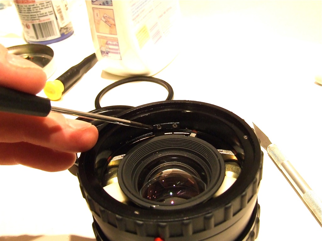

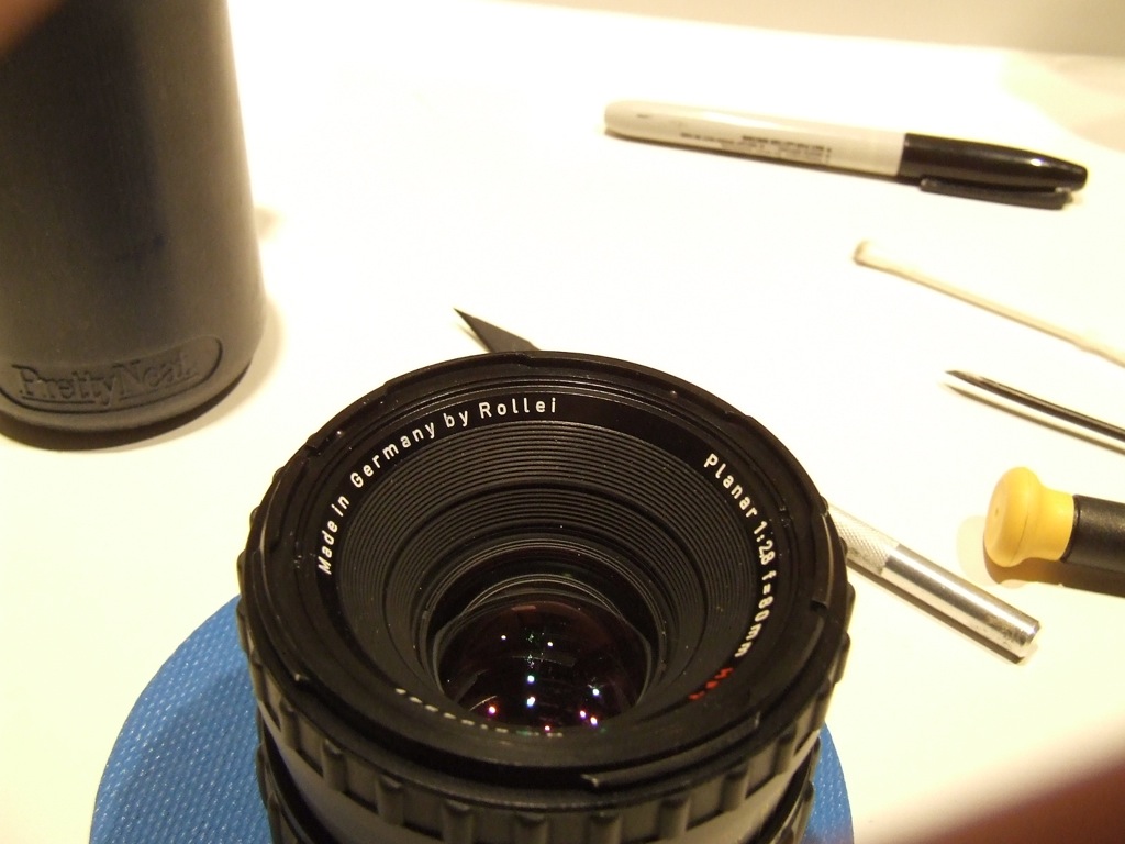

Hard to know if there is damage to the lens coating without carefully wiping the lens.

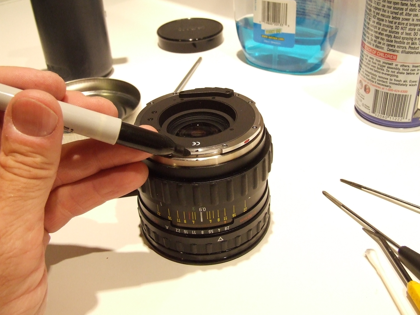

Zeiss lenses differ from year-to-year and between lens mounts. This is a Rollei.
Mark for re-assembly:
ic-racer
Feb 25, 2007
16,751
USA

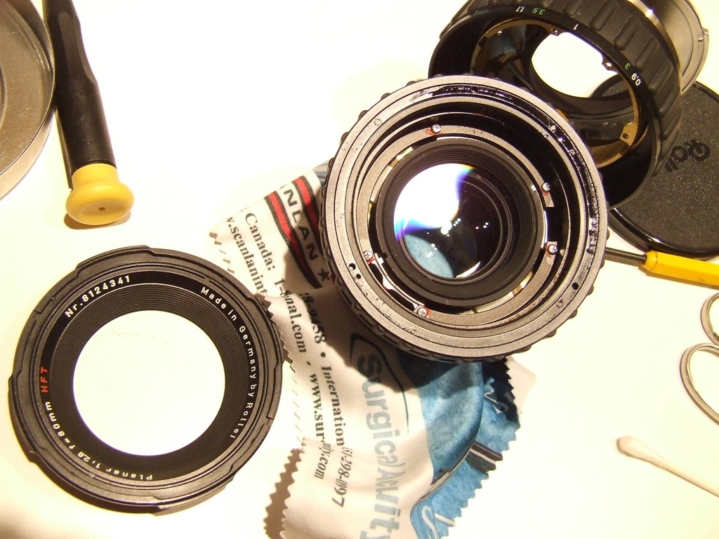

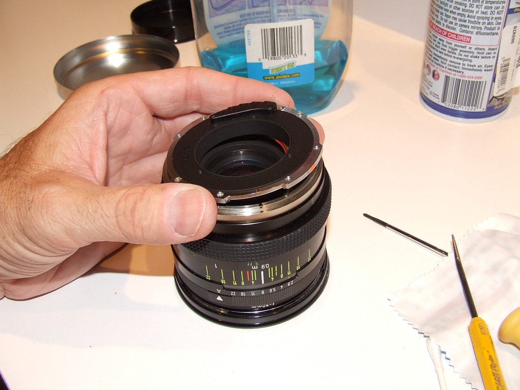

Remove screws:

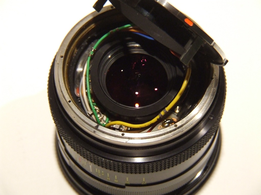

Remove Back Plate:

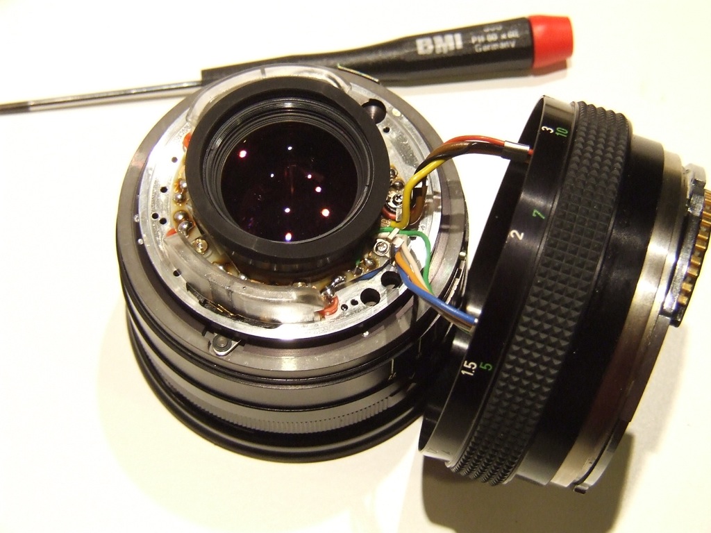

Be careful of wires:
ic-racer
Feb 25, 2007
16,751
USA

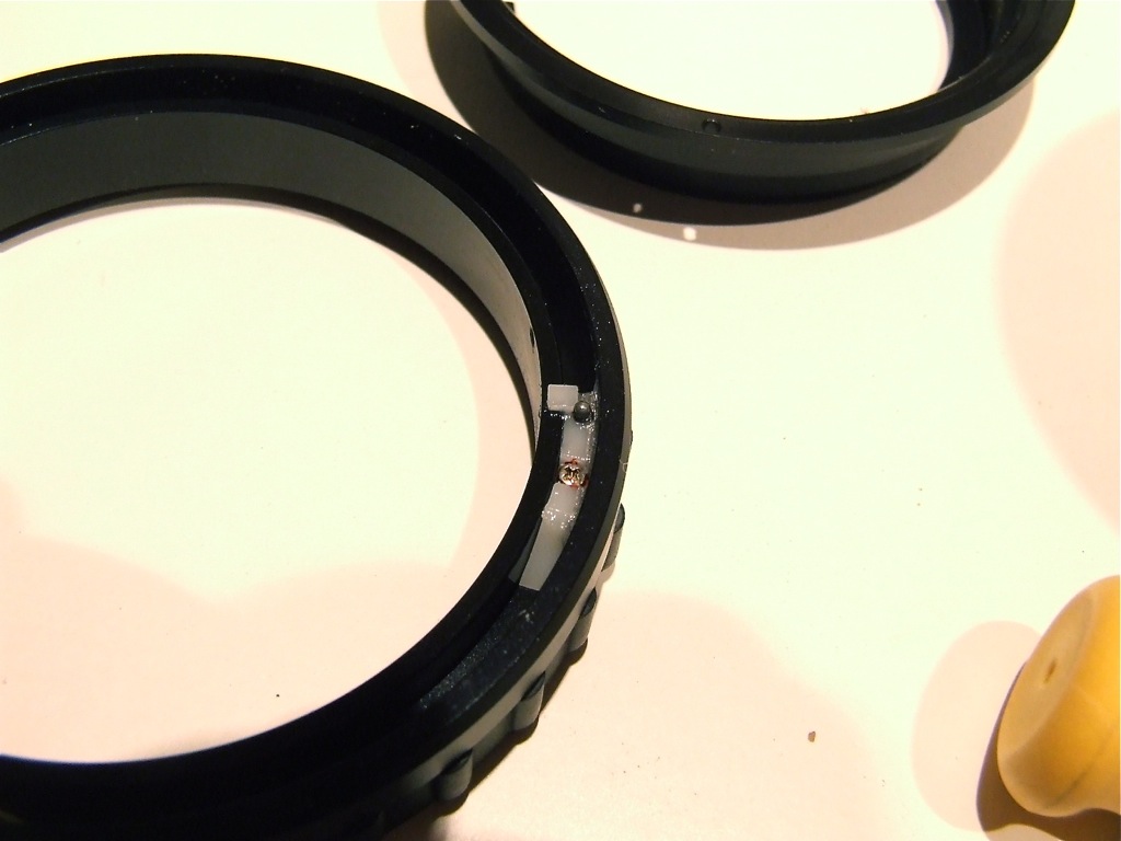

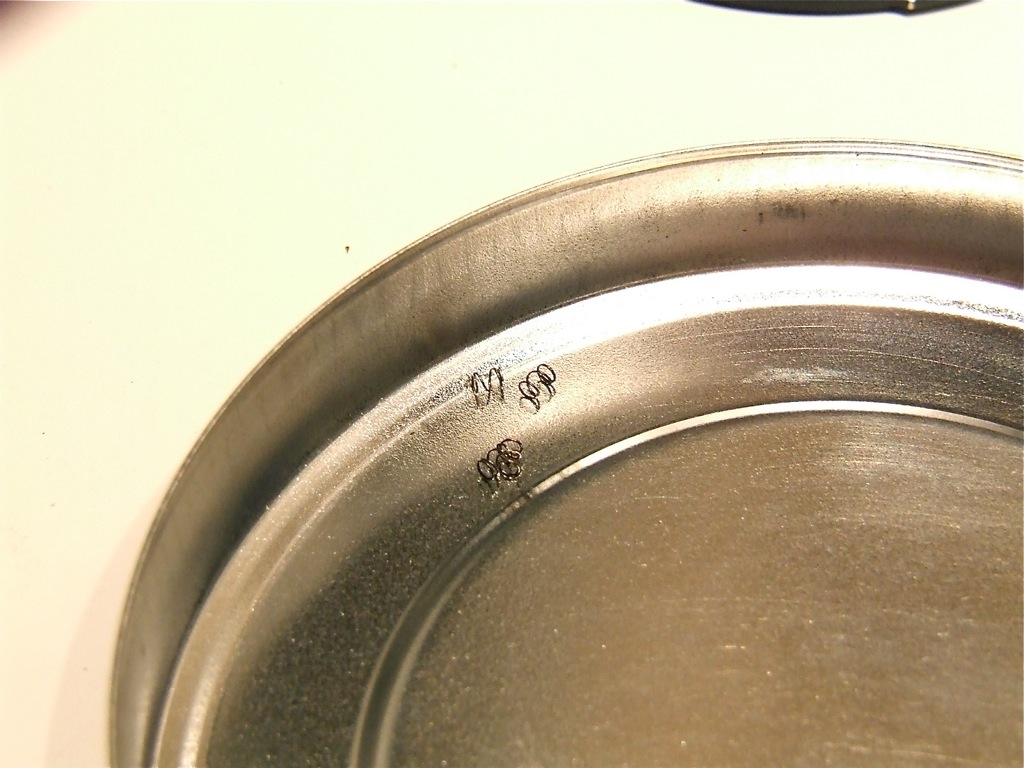

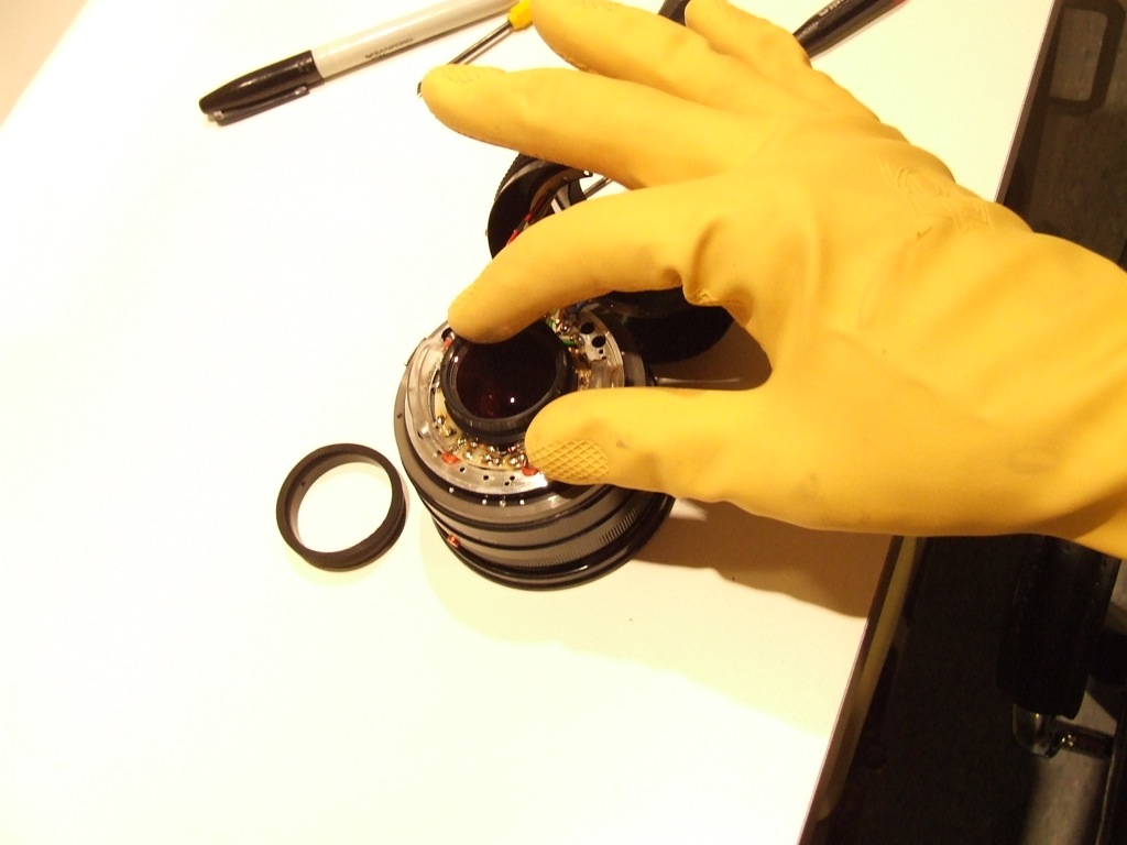

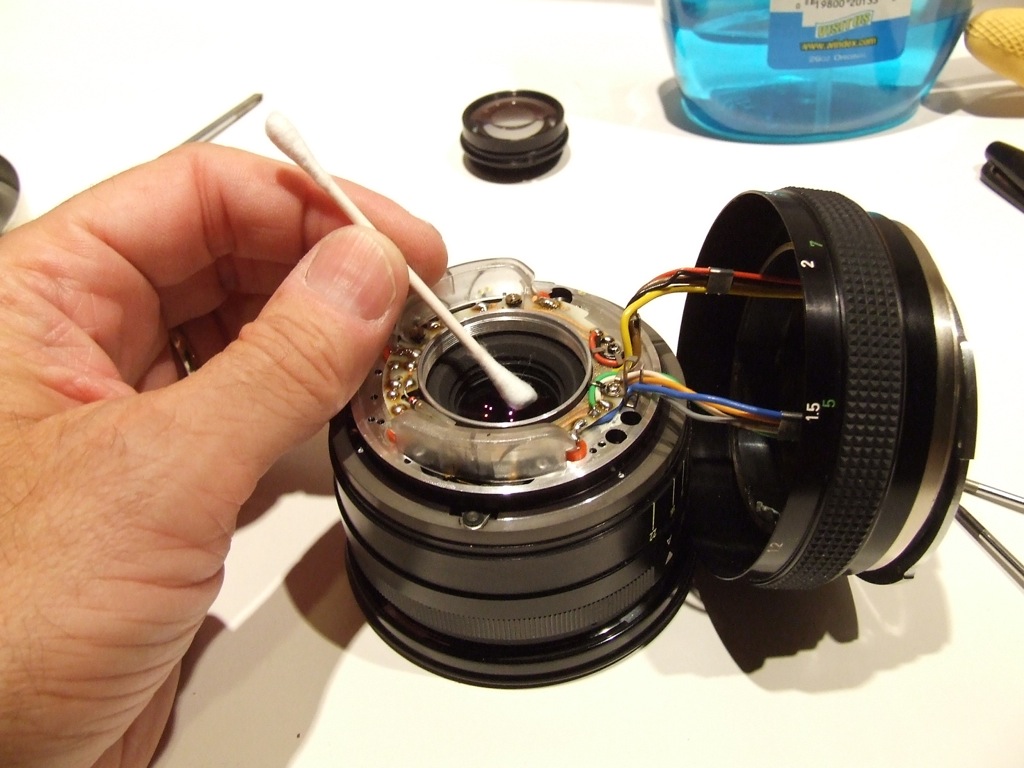

On the front, the Bayonet ring can be removed:

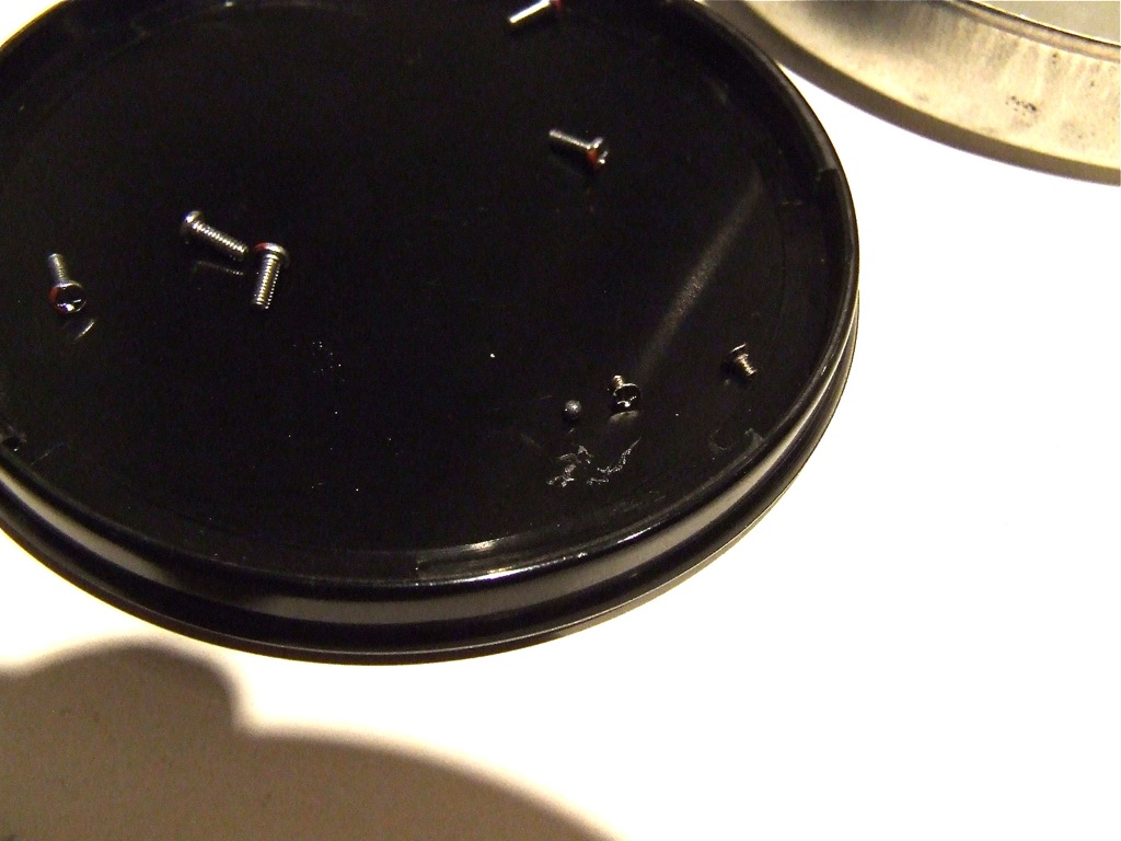

Don't lose these:
These screws can come out:
This ring comes off:
Don't lose these:
Remove and clean lens element:
