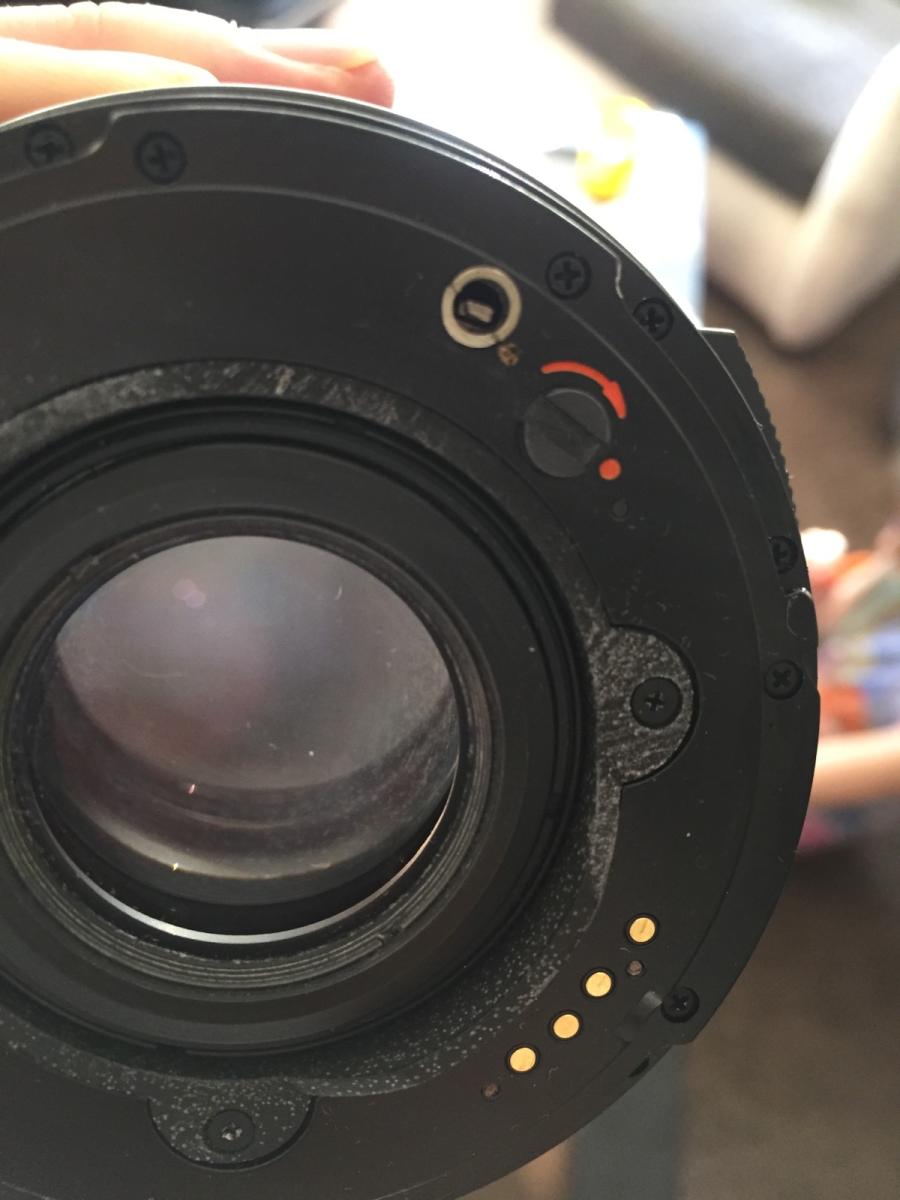

Anyone has dealt with haze or fungus in a Hasselblad lens. Is this fixable? Photos attached

Probably not worth the cost of fixing it. Cheaper to buy a new lens

Really? The cheapest I could find on eBay is listed for $990...

Hard to say, the picture doesn't show the stuff very clearly. Personally I haven't seen fungus spread like that and haze that
I've seen was more evenly coated, much like warm breath on cold glass.

Why not send it to a lens technician and get an estimate for repairs? Then you’ll know what to do.

John, it is exactly as you described. About 1/3 of the lens on the outer edge has like a warm breath on a glass mist. The center is clear. Photos don't pick that up.
Is the glass permanently damaged?

Hard to tell, but the glass doesn't seem to be etched.
Is it just the rear element? If so, that's easier to treat or repair.

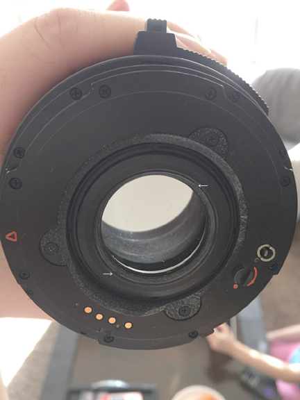

This is likely lubricants in the shutter gassing out and contaminants in the air settling on the glass from age, not fungus.
Get a lens spanner such as https://www.ebay.com/itm/Profession...4:g:KKgAAOSwG~VbrIbd:rk:7:pf:1&frcectupt=true or similar available in your area. I have one of these and it is very good.
Using the appropriate tips in the spanner to fit the notches in the lens retainer ring, white arrows in the revised photo you posted, and unscrew the retainer ring. Once the retainer is removed the rear cell(s) will fall out of the assembly when turned downward.
Clean with your breath and a clean microfiber lens cleaning cloth then reinstall in the same orientation they are currently in and secure with the retainer. I have encountered similar that would not come off with lens cleaner and lens tissue but did with the microfiber cloth and breath.
The cell(s) may be a very snug fit in the barrel and not move if cocked the thickness of a hair. Count the number of turns it takes to remove the retainer and verify it takes the sane number of turns to tighten it on installation to ensure the cell is seated properly in the barrel/lens assembly.

shows 3 elements in the rear group. There may be additional retainer rings once the rear most element is removed. Each piece of glass will be the shape as shown in the diagram. The lens front is on the left, the aperture is the vertical line.

Thanks for such a helpful answer! I am keeping fingers crossed that it comes off and glass is not defected

Sometimes the retainers are stuck and require a fair amount of force to break them loose and other times they have a thread locker on them that dissolved with acetone (nail polish remover).
If you encounter one that does not want to move soak the outer edge with acetone for 5 to 15 minutes then try again.
Don't scratch the glass!
