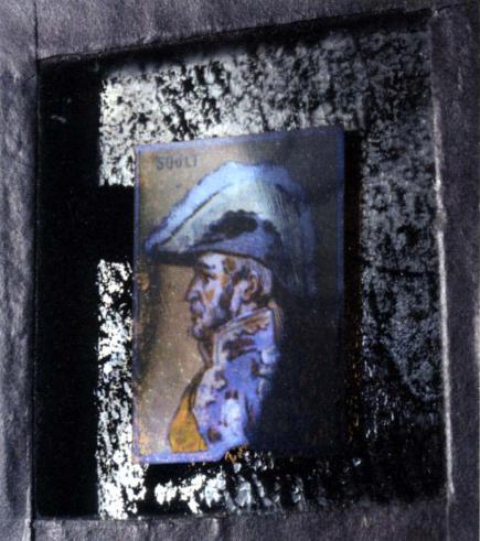

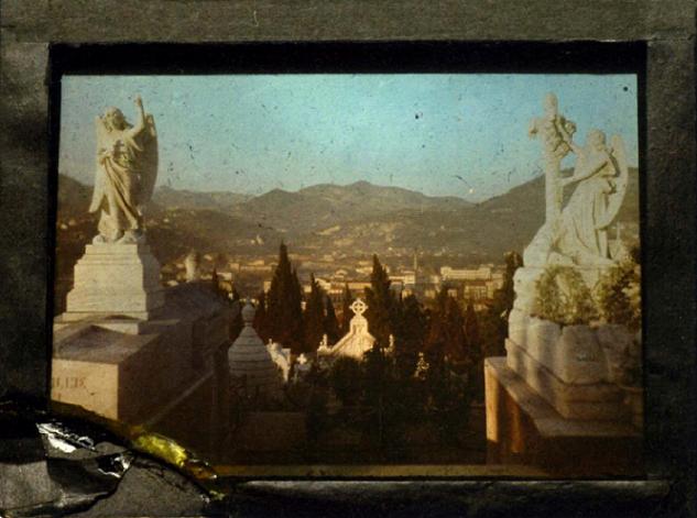

Here are some photographs of Lippmann stuff for your viewing pleasure.
1) Cemetary, Gabriel Lippmann, circa 1910
2) Young man, Gabriel Lippmann, circa 1910
3) Interferential Lippmann plate reproducing a color circle, Anonymous, circa 1893
4) Gabriel Lippmann himself, in the laboratory, circa 1900
5) Labeled Vignette du Maréchal Soult sur une boite d'allumettes, probably by Louis Lumiere, circa 1893

Are those from the autochrome book? I recall 2-4 but not #s 1 & 5.

Yep they are from that book. I hope I don't end up in jail....

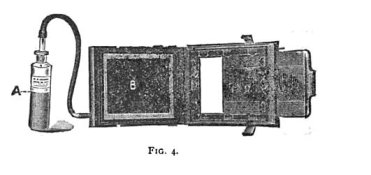

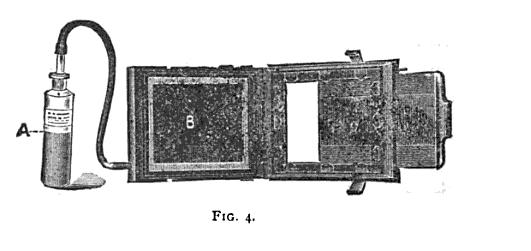

Mark Osterman then showed us the layout of a Lippmann plate holder with the Mercury inlet and drain. The drawings are quite interesting showing how Lippmann did his work.

I've attached a picture from 'Handbook of Photography in Colours'; did it resemble this at all?
I have to admit that I pondered breaking open thermometers and making a mercury holder, BUT then "sense" kicked in, and the mercuric chloride thread, and that seemed to cure that itch. I think it would be a terrible idea...

Here it is
Woops, didn't upload the picture.

It did not seem to look like that at all. We had drawings (side view) of a plate holder with a chamber behind the holder for the Hg. Mercury was not needed for viewing. They were mounted in small velvet cases with doors that opened to expose the plate.

WOW! Good luck Chris with your first Lippmann plate. Can't wait to see the results.
