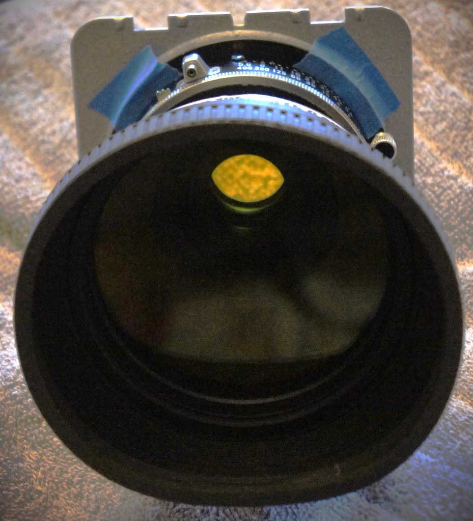

  • My Plaubel Junior restored with New to me 50mm F5.6 Fuji GX680 lens, purchased broken, at a good discount, from Adorama in NYC. They also included the Gelatin Filter Holder/50mm Hood, it's worth some Dollars so a great deal. The view through the 50mm is AMAZING. Can't wait to shoot some test 6.5x9cm Makina Back Film. EVentually I will buy some type of Digital Medium Format Back. The Peco Junior has a Leica-like smoothness and feel. Plaubel advertised as "The Rolls Royce of Cameras" in the day. Works smoothly and tightly in a Leica-type of way. Also looked through my 4x5" Sinar Normas with this lens. It's amazingly sharp-looking and nice and contrasty view. This will get some use now, rather than becoming an interesting broken ornament. BTW I should mention that I bought the camera for 70 Bucks from Adorama. Another great price. And it included a lens board with a #0 hole
  • The 50mm f5.6 GX680 takes 105mm filters, so I am glad I have the 4x4" Gelatin Holder and Hood for the GX50, It just covers the outer cell diameter, barely. I have a complete set of Kodak Wratten Gelatin 4x4" B&W Filters, so I am set. The 65mm and 80mm share a hood that also takes 4x4 Gelatins.

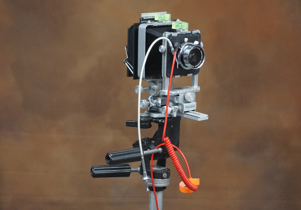

I've been test shooting with this camera in the studio. Jim Galvin 2x3 Graphic Wind Back Peco Junior Plaubel with 75mm F8 Schneider Super Angulon. I have the specific Schneider Center Filter for the 75 F8 which will go on this. Good when doing exptreme movements. I like shooting 6x9cm images with the 75mm F8 it's a needle sharp Sinar approved lens. Added Two Bubble Levels from B&H, which make the camera now VERY precise to align. Very well made mechanism it's quick and seamless to operate. Looking at the Aptus 22 Digital Backs, it might be a good choice for this. A lot of medium format digital back for not that much money. Anyway this is ready to go outside. I will prolly be working out of mu olde Zone VI Small Monorail Bag, I used to carry my 4x5 Norma around in it, it worked good. Last thing is a BZTS Focusing Hood, has elastic stretching fitting tightly, so I can compose in bright sunlight. Looking forward to testing this outside. Too cold right now!

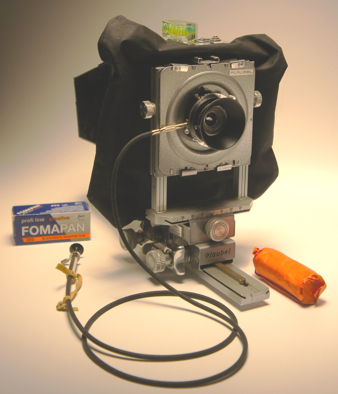

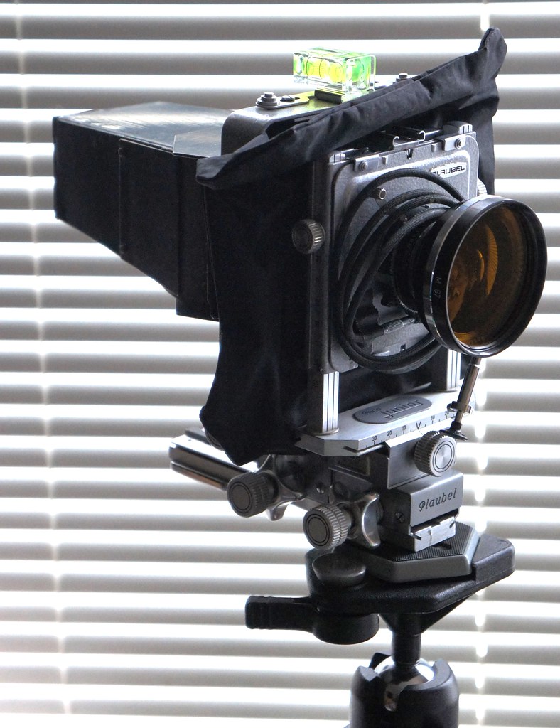

Completely restored Plaubel Peco Junior with Bag Bellows and Plaubel Makina Back with homemade Rotating Magnifier. Camera shown focused at infinity, very light and compact for easy carrying. Along with the widest lens (58mm Grandy), I also have: 65mm f6.8 Schneider Angulon, 65mm F8 Super Angulon with Center Filter, 75mm f8 Super Angulon with Center Filter, 135mm F3.8 Schneider Xenar, and 150mm F9 Rodenstock Apo Ronar. All this fits in my olde blue generic camera bag. In each end pocket are two 120 Plaubel Makina 6x9 Backs. Extra 120 rolls, tape, markers, notebook, etc all fit in the bag. It's not lightweight, but it's quite a BIG outfit cut down to minimum size.

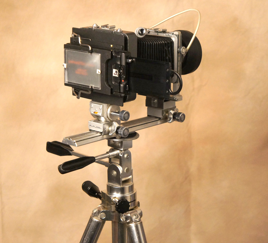

Testing long rail Plaubel Peco Junior with Fuji GX680 180mm f5.6 Yellow Filter Ilford PanF+ Plaubel Makina Film Back. D23 1:1 JOBO Multitank 6 Etone Tank Roller, Omega DII Omegalite 180mm black Rodagon laser aligned. Arista #2 RC paper Dektol 1:2. I like this new Plaubel Mini-Me View Camera. It is FUN to use; the homemade Makina rotating Viewfinder works great; I can see the camera movements, focus or not focus, on the tiny screen. This lens passes it's initial test

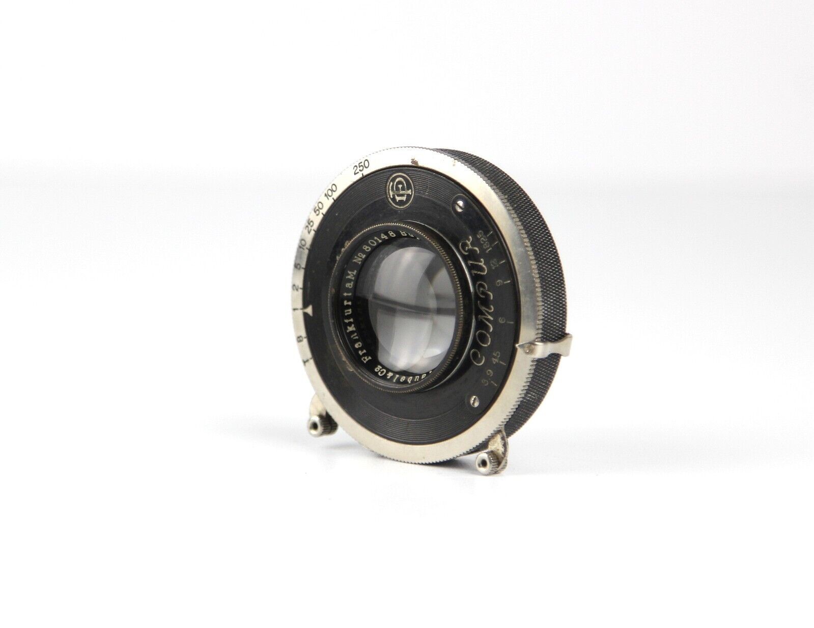

My eyes widened when I saw this 100 year olde 13.5cm F4.2 Anticomar lens (shutter huffed) on Ebay. I made an offer and it was accepted. Then took it to Mac at Camtronics who did an expert CLA on it. We both think it is 1930's era so 100 years olde, prolly off an olde 9x12cm Plaubel Folder. Cut and flocked a 3D printed Peco Junior board from Italy, painted the lens back with Flat Black Krylon with brush, it was really UGLY. Luscious to look through, but slightly hazy, as are all my Orthometars. Kind of like that Orthometar "look" kinda retro. Anyways a good example of how I restore something others might disgard. I see 100 examples of F2.9 Orthometar, to one F4.2 Orthometar. The "sharp" lens for commercial, reportage, and travel according to Plaubel. Works like new on my long rail Peco Junior. Finally I found a dark yellow glass disc in my filter box, and cut a strip of Hollywood Gaffer Tape, to attach it to the new F4.2 "Sharp" lens.

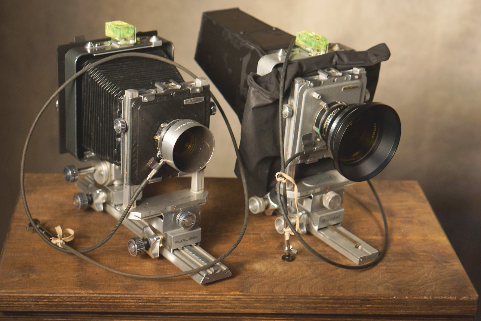

Short and Long Peco Juniors 150 F9 and 58mm F5.6 by Nokton48, on Flickr
My Short and Long Plaubel Peco Juniors. On the left, the 150mm F9 Rodenstock Apo-Ronar, a GEM of a lens, a favorite. On the right, another favorite, a 58mm F5.6 Rodenstock Grandagon in Graflex XL Mount, I refitted it to a Peco Junior Board. Both of these are original lenses, pretty much as they were in the catalogs of the day. Ready to take out when it's warm around here. Both lenses have medium filters, and proper hoods as well, ready to shoot! Camera on left takes Graflex Wind Knobs Backs (kinda modern). Camera on right has a swiveling viewfinder which I love, takes 6x6cm and 6.5x9cm Plaubel Makina Backs, as well as

This is coming to me from the Ukraine. The Plaubel 100mm Suprocomar F3.9 in Compur shutter. Plan to use it on my Plaubel Peco Juniors. Is anybody here familiar with this lens, I have several Anticomars and like them. Is this off of an olde Plaubel Folding camera??
